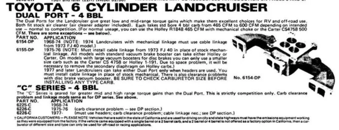

Im thinking about trying out a FiTech EFI, so Im pricing out a reasonable offenhauser intake for my F engine. According to the offy catalog these are part numbers 6154-DP or 6225-C. Dual port or C series are OK. Let me know if you've got one on the shelf you're willing to part with. Thanks!

@Downey , if I found an Offenhauser 6115 intake for sale which is the 2F intake - would that fit on my F engine? Im confused because Offy says beyond 77 needs to run headers on the 2Fs and this seller did not post photos of the underside. When the the bolt pattern between the intake an exhaust change? I am not opposed to a header if I need to. If so, part two of my question is do you have any of those sweet Tri Y's kicking around?
