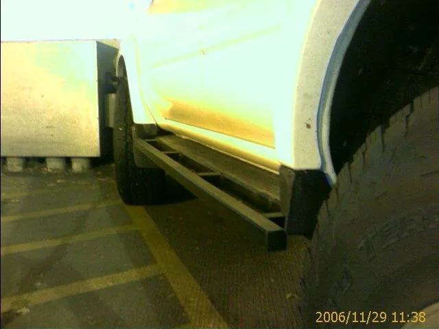

The ones that I have on the mini are basically a copy of 4Crawlers design. The ones on the 80 are more like Christo's step-sliders, execpt that I used square tube for the outer section (I also haven't gotten around to adding a plate to the top.
The ones on the 80 function much better as a step than the ones on the mini, due to the fact that they extend straight out from the inner tube, rather than being angled upward as on the mini.
Here's a pic of the ones on the 80. Sorry for the poor quality, the flash on my camera phone isn't very good.

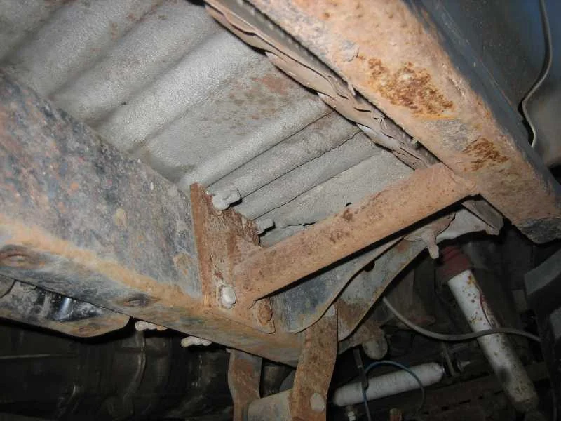

I'm with kris on not liking the big bolt and associated bracketry hanging down below the frame. here a pic of what I did on my last rig and plan to do something along these lines on my next set.
The plate is 3/8's inch with 4 - 1/4inch bolts through the frame. The tube running out is 1 1/2" .188 wall IIRC. With that being said, my next set would use a little heavier tubing w/ guseting as the section modulus of the tube is barely enough to handle the moment at the base.
I can certainly live with a bolt-on mount like you have here. Did you add sleeves in the frame or is that the reasoning for having a plate the full height of the frame?
the frame is not sleaved on that install. the bolt holes are drilled so that the bolt is flush against the top or bottom wall of the box channel so I didn't feel that it would crush the frame. I also drilled those frame rails when the body was off (for other reasons), you my have a hard time drilling the top holes with the body on...
