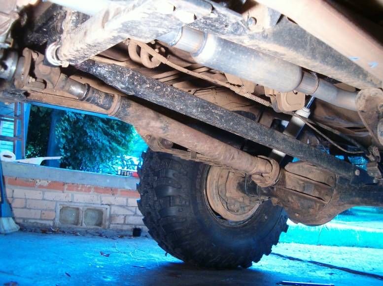

Please tell me what you think of this set-up. Over here in Australia I have had most people tell me that you don't need a shackle, but you guys run one on just about every set-up. will my set-up limit articulation or cause binding?
That setup will not work with flexy springs - I know this for a fact (two pinions). Looking at the number of springs in the pic you post - they might be strong enough to control wrap without a tract bar; however, if they're flexy, the solid mount track bar will act as a pivot point (especially with it so high and not matching spring lines) and the axle wrap will actually bend the springs enough to bind the u-joint at the pinion. Use a ladder or any style that is mounted solid to the axle housing and take the time to run a shackle up front - done deal.
Note: The solid mount bar works great with stronger springs or on a SUA with lift springs - but that's because it's just helping the springs - they're still doing half the work.
That design is still a ladder bar..
But, unless he has designed it to VERY closely match the natural arc of the springs.. It will bind..
friend of mine bought one of these, I built one strikingly similar, had busted 2 pinions and numerous u-joints in a few months prior to putting this on, haven't busted either since (close to a year now). You have to mount it exactly where deckers says to... even flexed you can unbolt it and remove or reinstall. No locknut on the heim allows the bar to pivot with flex, the mounting position is engineered to match the leaf springs cycle. As far as the leaf acting as the 3rd piece of triangulation, I believe the diff is fixed (unable to rotate) between the tire contact surface and the top of the trac bar tower and not directly related to or in need of triangulation, but then I did allot of drugs in the 70's and may be having a flashback.

Damn, you're right - the rear portion is fixed preventing the axle from wrapping - just not as forgiving due to fixed mount to frame. It would work, but would be best to simply add a shackle...
The style I had a problem with is the decker shown in the post above - by being able to pivet at both ends, it allowed the axle to wrap upwards by bending the soft springs....
Glad it worked for others - I'm converting to a solid ladder style with a shackle.
Will post pics in a few weeks - it's a little different and worth discussing.
