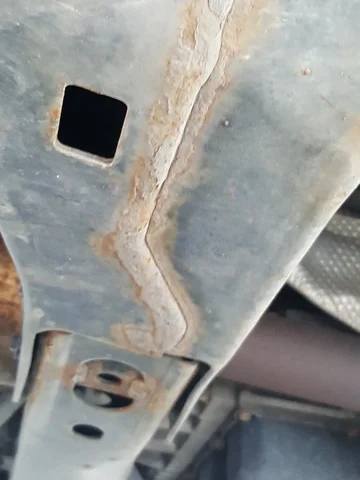

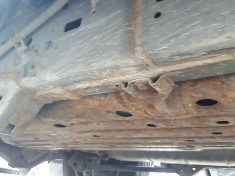

My main think I focused on was finding rust. The doors, sills, body panels etc. looked pretty good - no rust. I took a bunch of pictures of the undercarriage and would appreciate your thoughts on whether this is fine/typical or not.

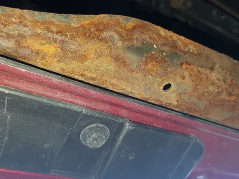

Inside rear bumper. Not so good looking.

Frame
20170307_133705 right mid frame.webp 20170307_133709 mid frame.webp 20170307_133800 frame.webp

Depends on the price and how much you're willing to put into rust care. It's certainly not fine, but with some elbow grease, rust reformer, and fluid film it's salvageable. I'd say probably a day of scraping, chiseling, wire brushing, and then a day of careful work with few cans of Rustoleum rust reformer, and then another hour or so of Fluid Film application and it will be acceptable. So, if you get it at a real good price and are wiling to put in some time, and everyone else is ok, it would be a doable project.
And a tetanus shot.
I've passed on some with less rust. For me...once I find the one, I am keeping it for a loooong time. I will give it to my kids when they start driving. So IMO, if you are planning to keep it...run.

Some of those pictures scream "Flood Damage" to me ... I'd run.

But the rust is concerning, unless it's just a smoking deal I'd run from that one man. You can do better.......
Thanks guys and/or gals. i don't need the hassle, i don't think it's a steal, and zero service records = no dice!! I will keep looking! (and btw, i liked the red!)

Some of the incongruities I observed are not easily explained by anything else IMHO.
For instance, the rusted tailgate cable brackets in contrast to brand new looking carpet:

Any thought why this taigate bumper mount should be so completely rusted while everything around it looks brand new?

Silt? Sand? Whatever settled on top of frame rail?

I have no idea what the history of this vehicle is, but it is suspicious there are no service records available. Is the title clean? Don't know. For me, there are enough red flags to rule this one out. One easy explanation is a flood salvage supported by the apparently inconsistent presence of brand new looking parts right next to completely rusted parts.
If you think this is not a plausible conclusion, please let me know. Not defensive, just curious what you think.
HTH
I always hear about flood cars but never really seen any. However your observations make a good point...how else would the relatively shielded hinges become so completely rusted? Silt may be explained if they drove through some tough terrain but even then that's a stretch of an explanation...
