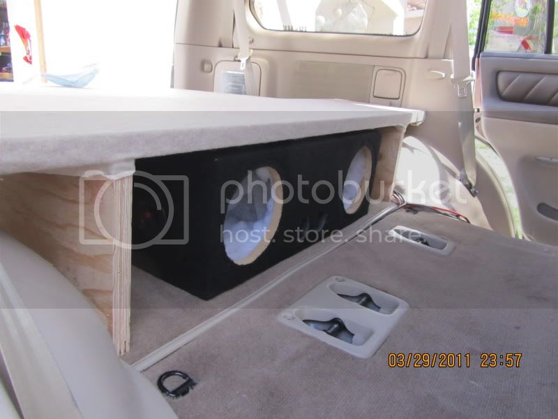

My hundy is unorganized to say the least. I decided to make a roof rack for hauling my dirtbike/camping gear and a drawer unit with hidden subwoofers. Obviously the dual 12" JL's were thrown out the window because there is no way to hide those
Downgraded to dual 8" subs in a ported box. I bought a box on craigslist which was just about 9" in height. Perfect! Roof rack is done, its at the powdercoaters...still
Tonight had some reasonable progress on the drawer unit. Materials for roof rack and drawers have added to about $320. Not bad?
For those interested, here are the links to the materials for the drawer build:
1. Tongue and groove wood sheet
http://www.homedepot.com/h_d1/N-5yc...splay?langId=-1&storeId=10051&catalogId=10053
2. Tan/beige felt
http://www.joann.com/joann/catalog/productdetail.jsp?pageName=search&flag=true&PRODID=prd10007
3. 2" wood screws...built an entire patio deck with these so I thought they would be pretty strong
4. 8x10in L-bracket and 5x6in L bracket. Use two different kinds so the drawers wings can support a lot of weight and fit through the rear tailgate

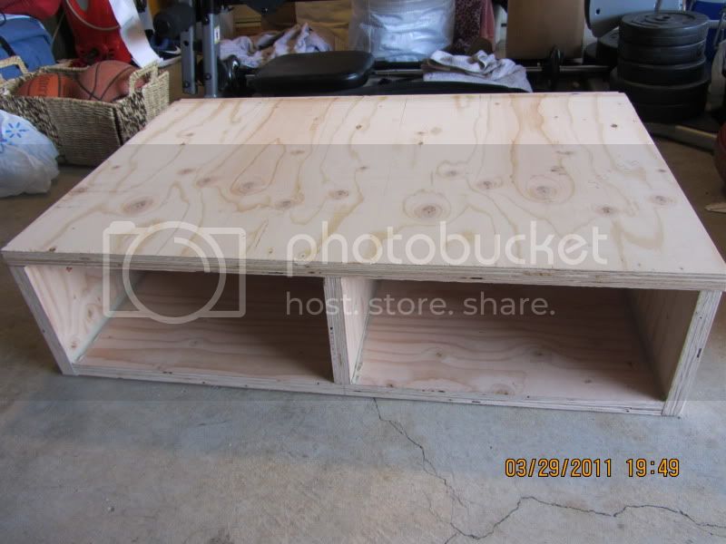

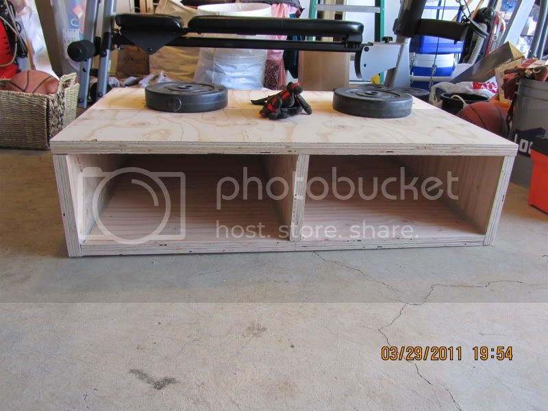

I measured how much wood I needed to buy at home depot! Decided to get the 1.25" thick 4' by 8' tongue and groove sheet. Make sure to get rid of the tongue and groove. Drew up some diagrams and got the pieces that I needed cut up to minimize the work that I need to do at home. That being said, I guess my numerous drafting classes have paid off
No issues so far and here are some progress pics! Criticize and advise me on how to continue. I have ordered some subwoofer carpet that matches the interior of my hundy and I am going to finish the main frame for the drawers so that I can meaure how big I need the top cover to be!
On to the pictures
1: Pieces of plywood in "kit" form
2: Base sheet laid out
3: Mocked up frame
Constructive criticism and advice pls!
