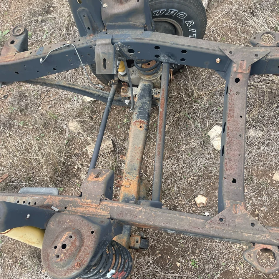

The RHD chassis has some significant differences in the front end. The panhard mount and steering box / brace are mirrored from the LHD chassis. The front axle also has the panhard connection on the opposite side as the LHD trucks.
You could probably use a LHD front housing, and hack off the steering brace / panhard mount from a LHD / weld it in. The steering box placement holes already exist on the opposite side.
Best photo I have of my RHD 80 chassis.
-Rob
Hey RivMan, thanks for the info .. OSS, I think that's what I needed to hear .. I haven't bought the 80's platform yet .. so might as well hunt for a LHD version to make this happen .. there was just a good RHD available here but as you said, north worth the trouble .. thanks, much appreciated ..
