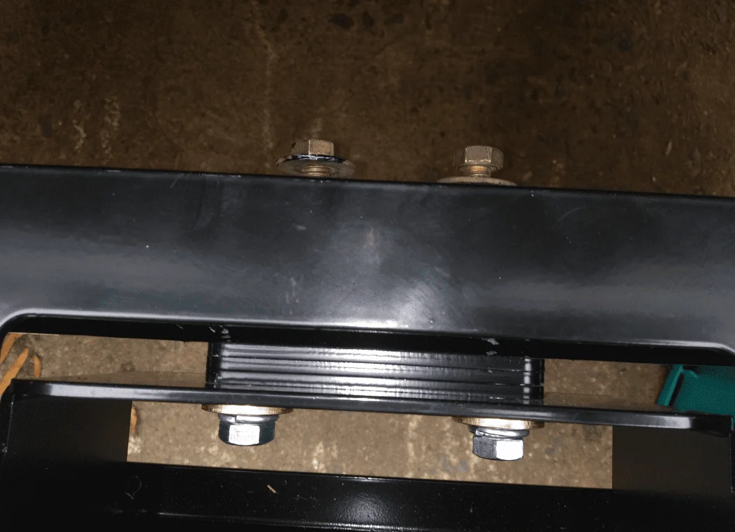

Is the consensus to use 2 or 3 of the U shaped spacers? I have three installed at the moment.

I think I used 2
