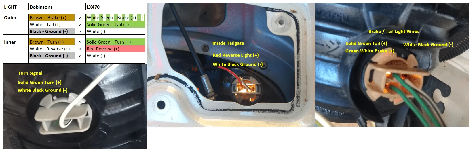

For a 1999 LX470
Green White is the stop light wires
Red Black is the reverse lights
White Black is ground
Green Yellow is right turn
Green Black is left turn
Of course I would verify this info before cutting, but this will cut down on guess and check
Here's a proposed wiring map with pictures of the wire locations that are behind the tail/turn/brake lights and the backup light in the tailgate.
How does this look?

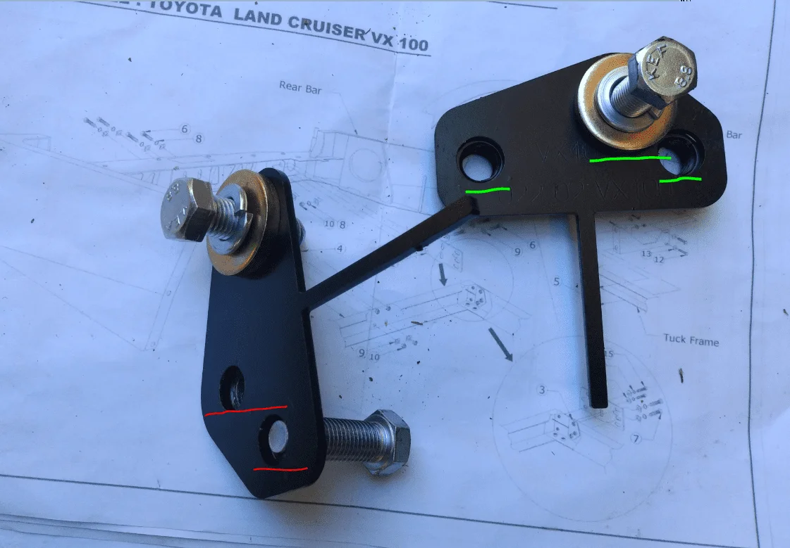

Did any of you guys find a need to tap out the nuts on the arrow-shaped mounting brackets?
I started finishing up the side bracket installation and found one bolt would not start. So I remoived the bracket and was able to start the bolt from the back side.
It turned to a point then locked up as shown in the pictue with the red underline below.
So the arrow bracket from one side with the green lines is fine. The bolts start without issue.
I guess I wll need to go buy a tap to tap out the nut on side the the red lines.
I know this looks like a fluke.
Has anyone else had this issue?

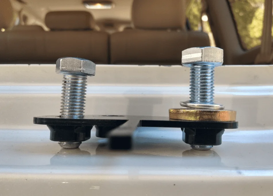

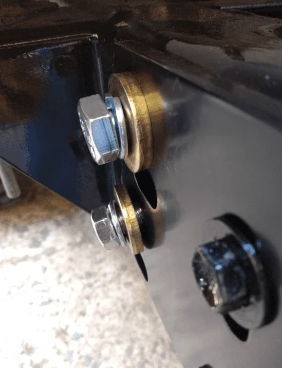

I picked another M12x1.5 bolt from Ace Hardware. A bit longer but it will work.
The problem I'm having is the nuts were crooked when welted to the mounting plate. You can see how one of the bolts is tilted off to the side.
Would you remove the plate and go find a welder that can correct the alignment of force it on which really looks bad in the 2nd photograph?
This thing is really going to look bad if I keep going.
After going for a larger 19mm by 40mm bolt with a nut behind it, I was able to finish the left side.
I am careless and hasty, so I would just torque that up, not like you would need to remove it often!
I did that too.. Then the heavier grade bolt stripped out the nut. I had to put an M12 1.5 nut behind it. Maybe I can get it lined up ok.

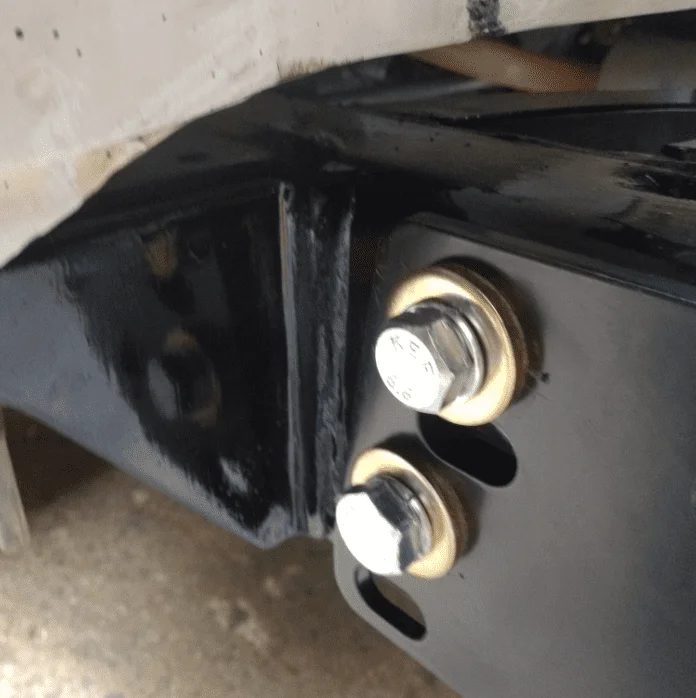

The question I have at this point is which bolts to mount first? Should I mount the u-bolts to the frame with the L brackets first, then mount the bolts in the brackets on the ends before the center spacer and bolts I'm working alone which makes it a bit dangerous.
I'm thinking about using an engine hoist to lift the bumper and guide it into position before bolting it up.
Hopefully, @atnolan94 or someone else will chime in with the specifics. When I was installing ARB front, I didn't have a helper, so I used a few 2x4s to hold different parts of the bumper up and align it to my my liking and then started tightening up the bolts. In general, if you have access to the back side, I prefer putting in free nuts vs, using captured/welded nuts.
Hopefully, @atnolan94 or someone else will chime in with the specifics. When I was install ARB front, I didn't have a helper, so I used a few 2x4s hold different parts of the bumper up and align it to my my liking and then started tightening up the bolts. In general, if you have access to the back side, I prefer putting in free nuts vs, using captured/welded nuts.
Good idea. Thinking out loud. I might be able to stack up some tires and wheels that I'm not using to rest the bumper on it while getting it into position.
Set it up on some jack stands. Thats what i do with all my bumpers and sliders. Can lift up each little bit at a time and get it where you want it.
I started by finger tightening the frame bolts, both the crossmember and the side of the frame rails. Once I got it where i wanted it I tightened those, then did the wings last.
Thank you. I have plenty of jack stands.
