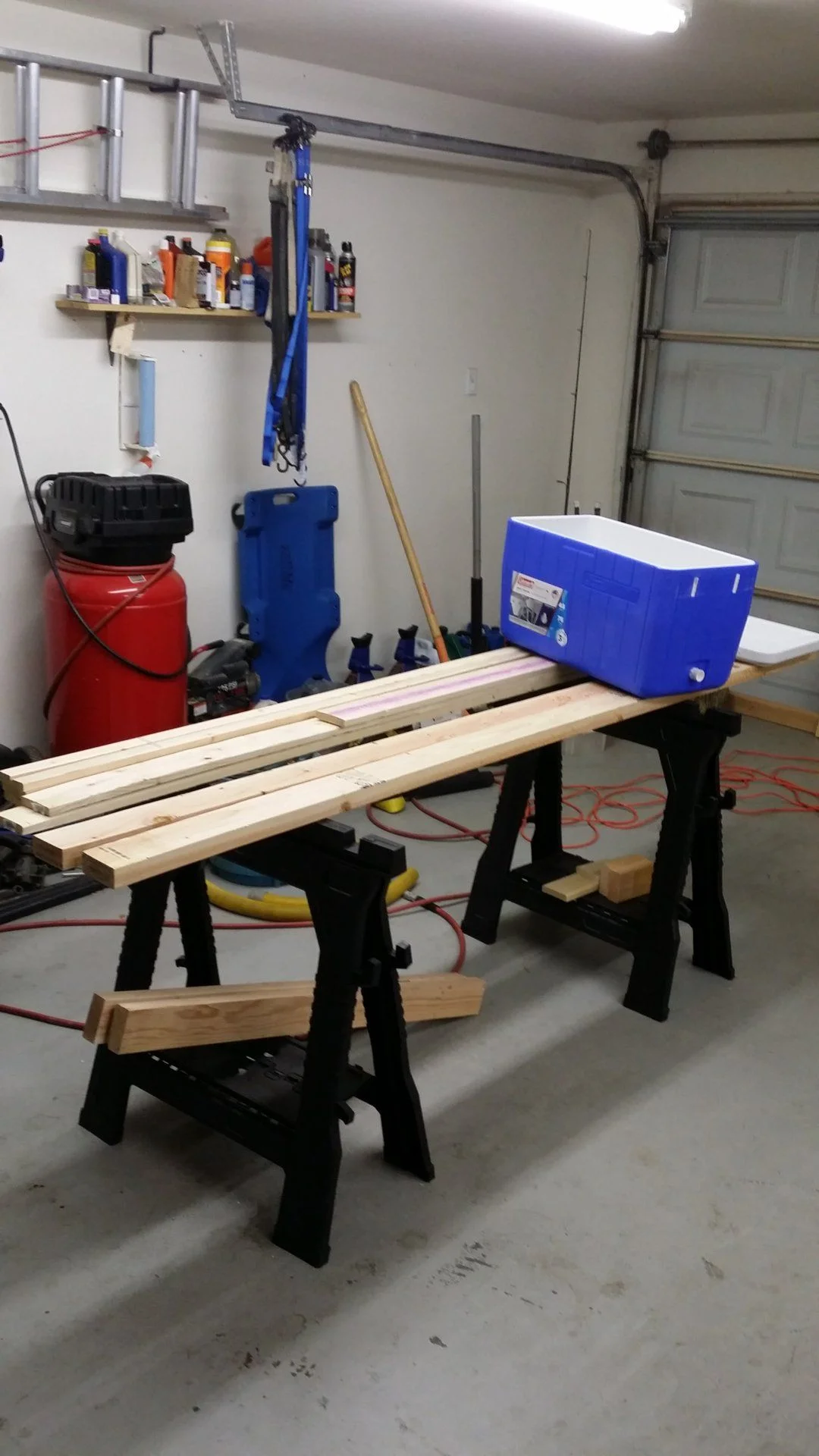

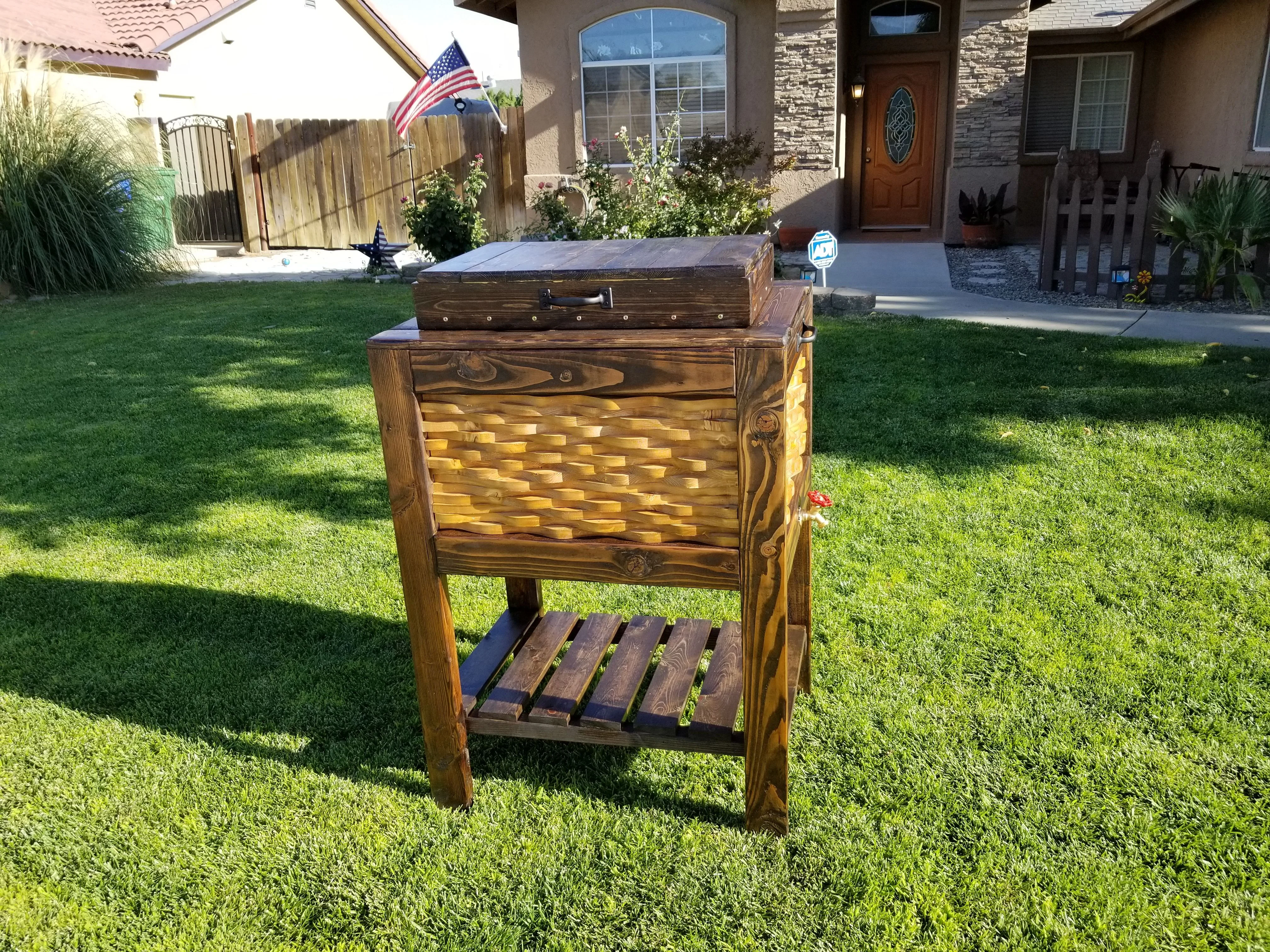

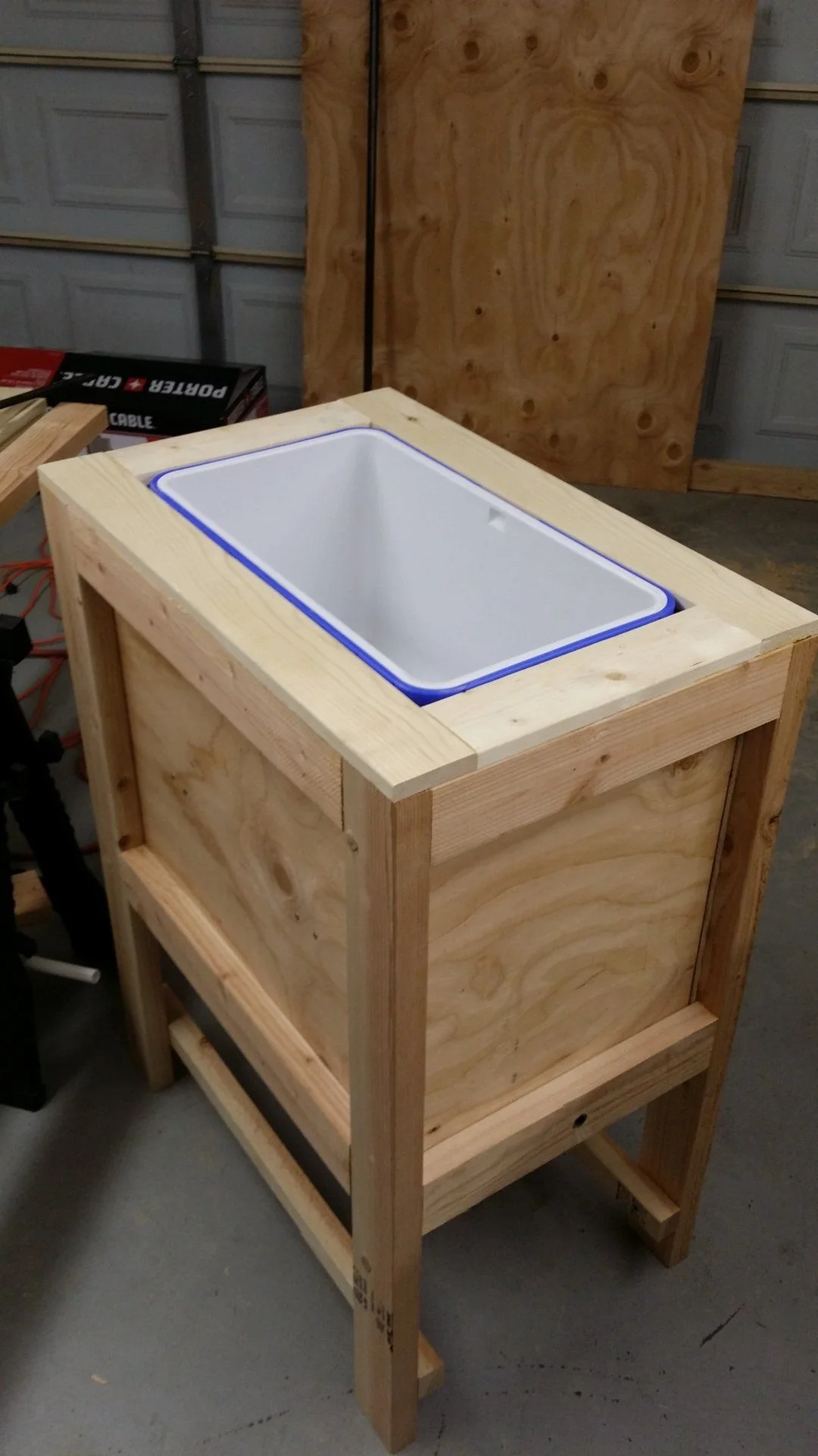

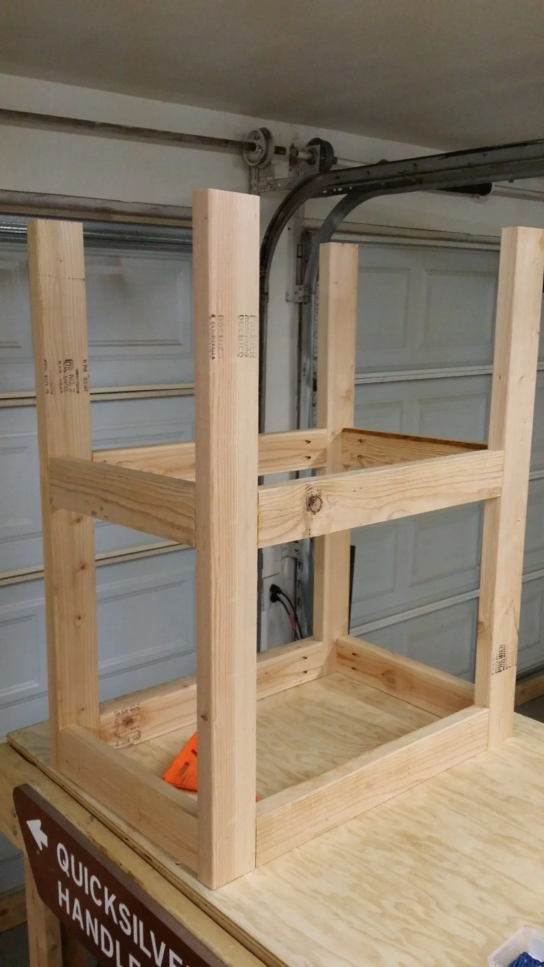

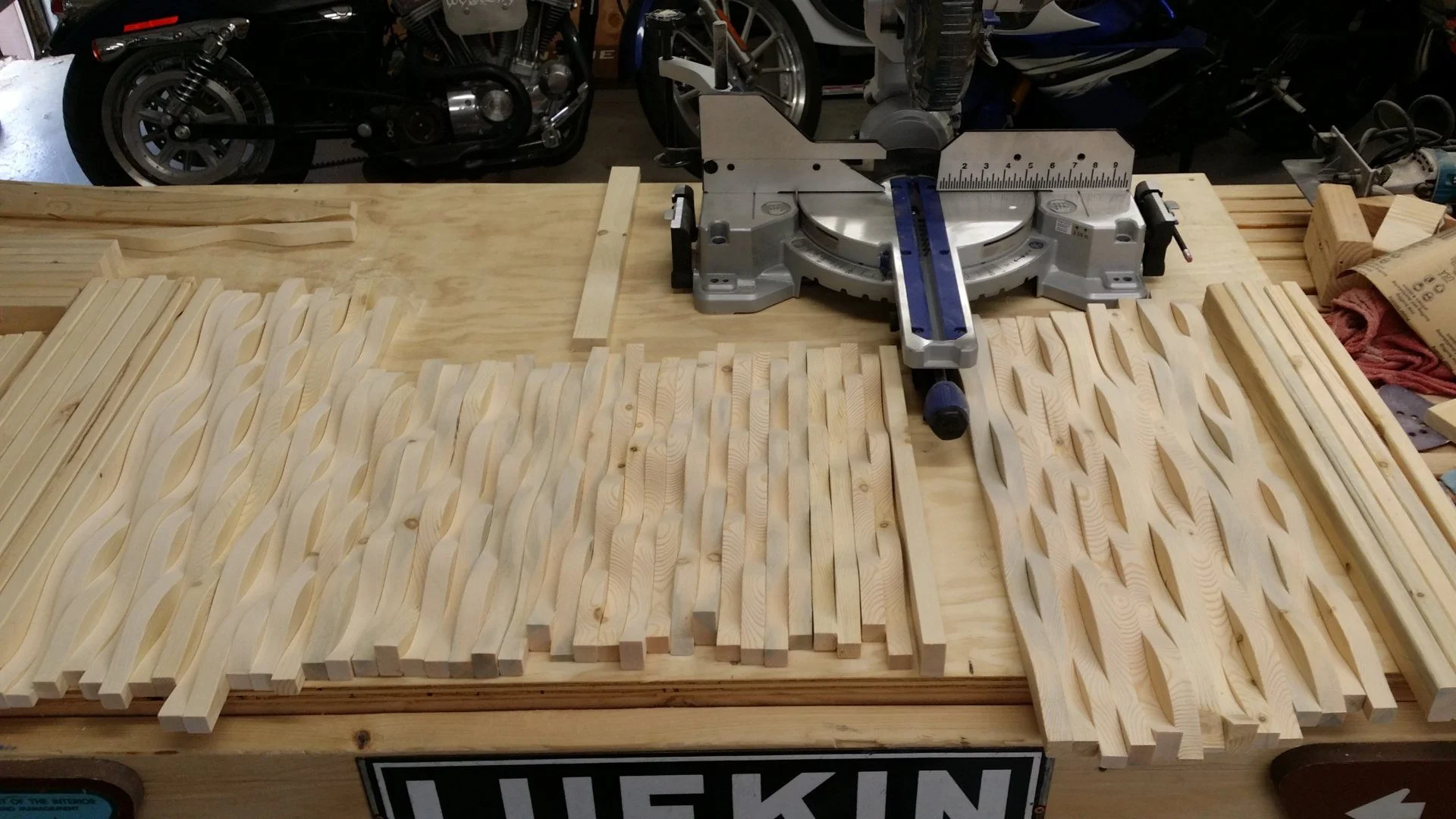

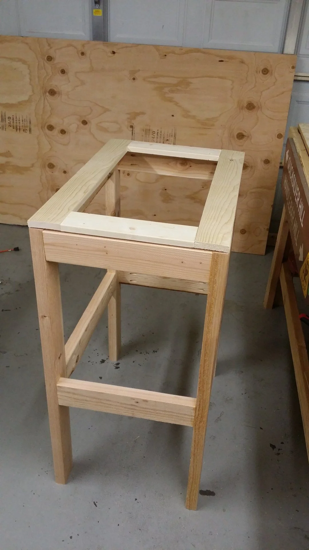

I have recently been interested in wood working projects. After making my butcher block style garage workbench I decided to go on to another wood working project. I decided to make a gift for my brother and his wife. This is only my second project. I enjoyed working this and it took only a few days. I am sure it could be done in less but I took it slow and tried to be careful since I am still a Rookie :meh:
I went from some construction grade lumber and a cooler.
full

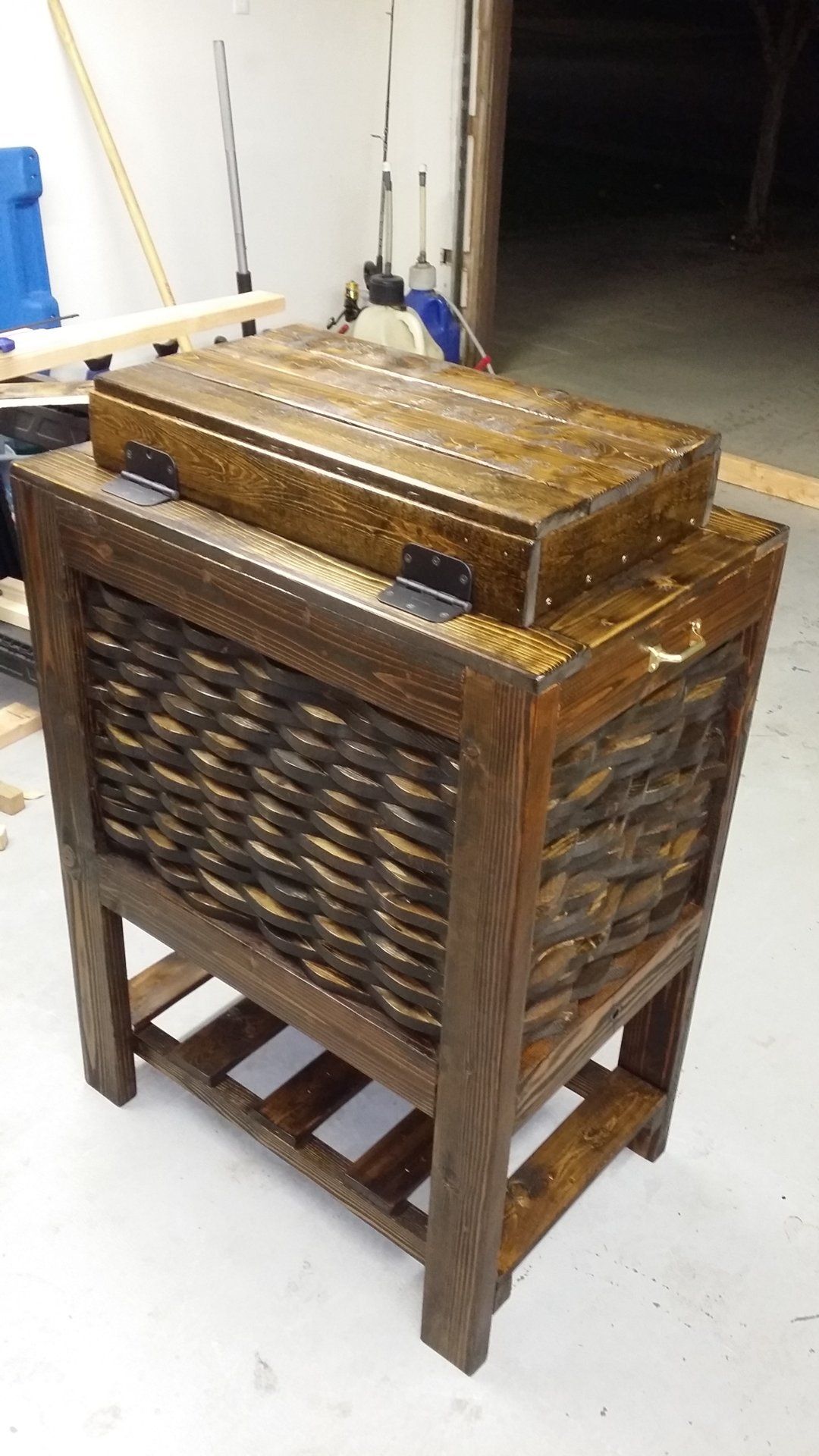

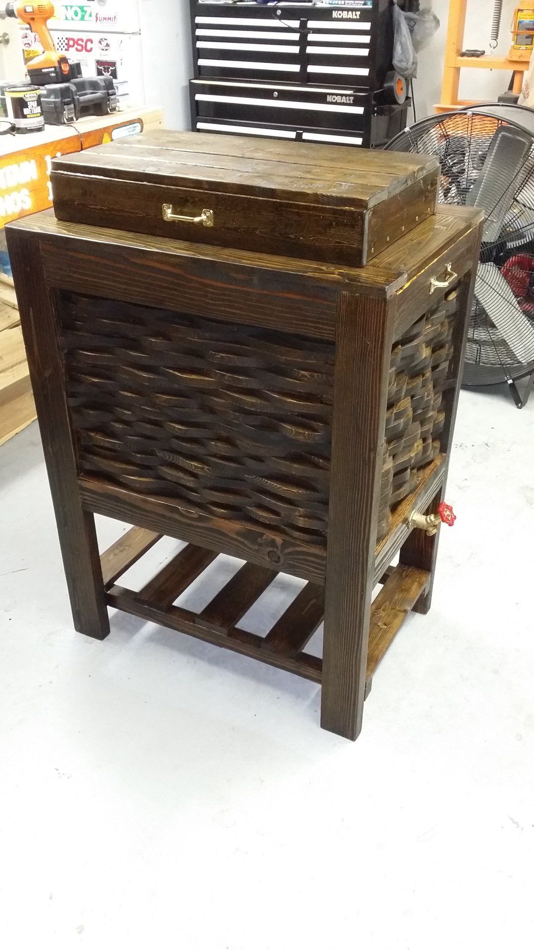

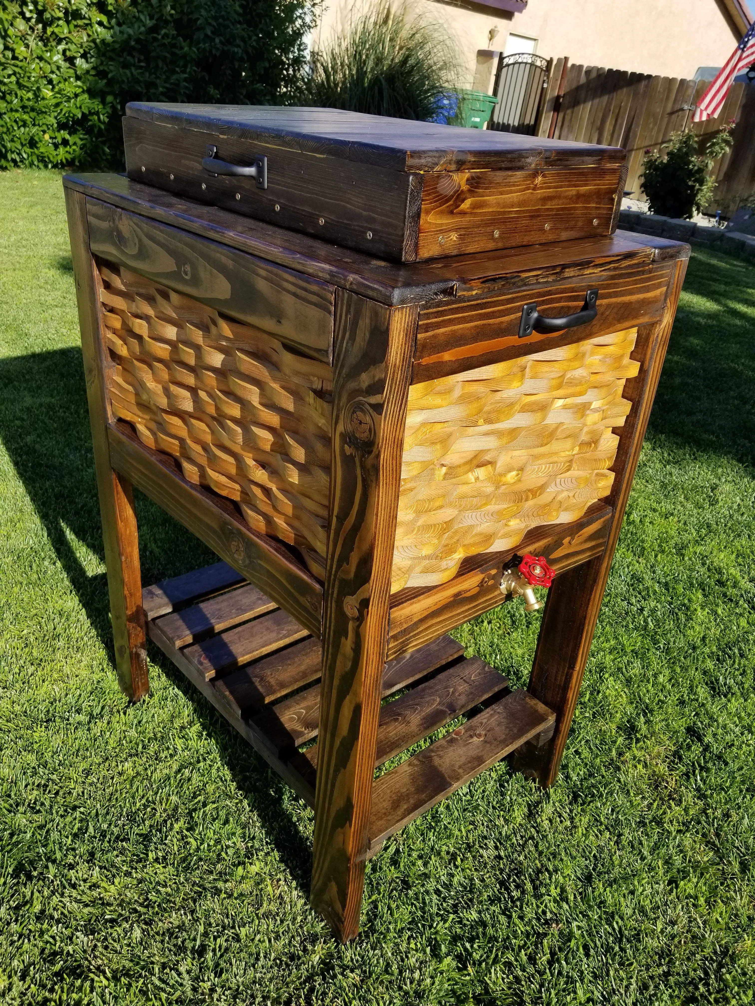

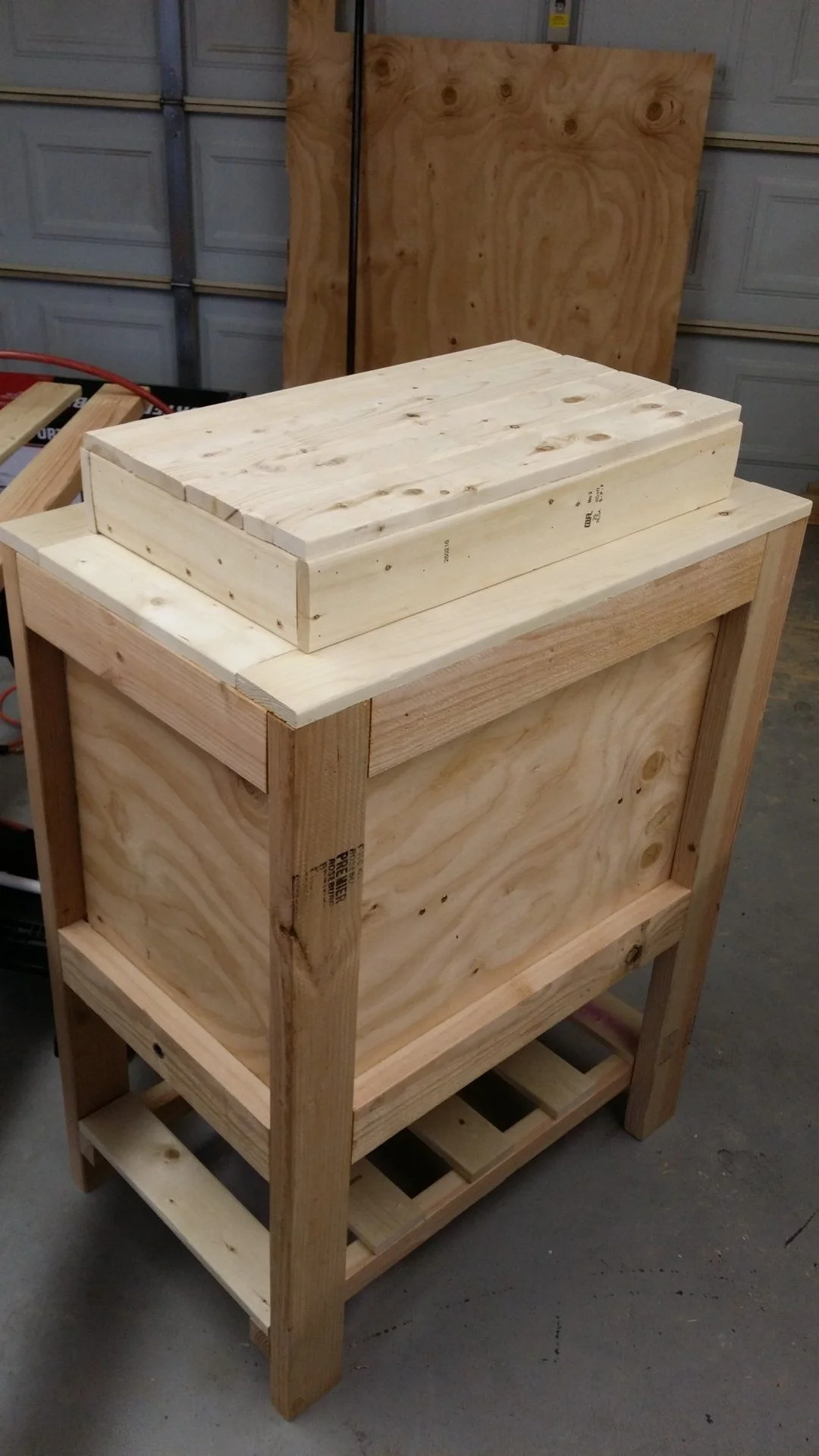

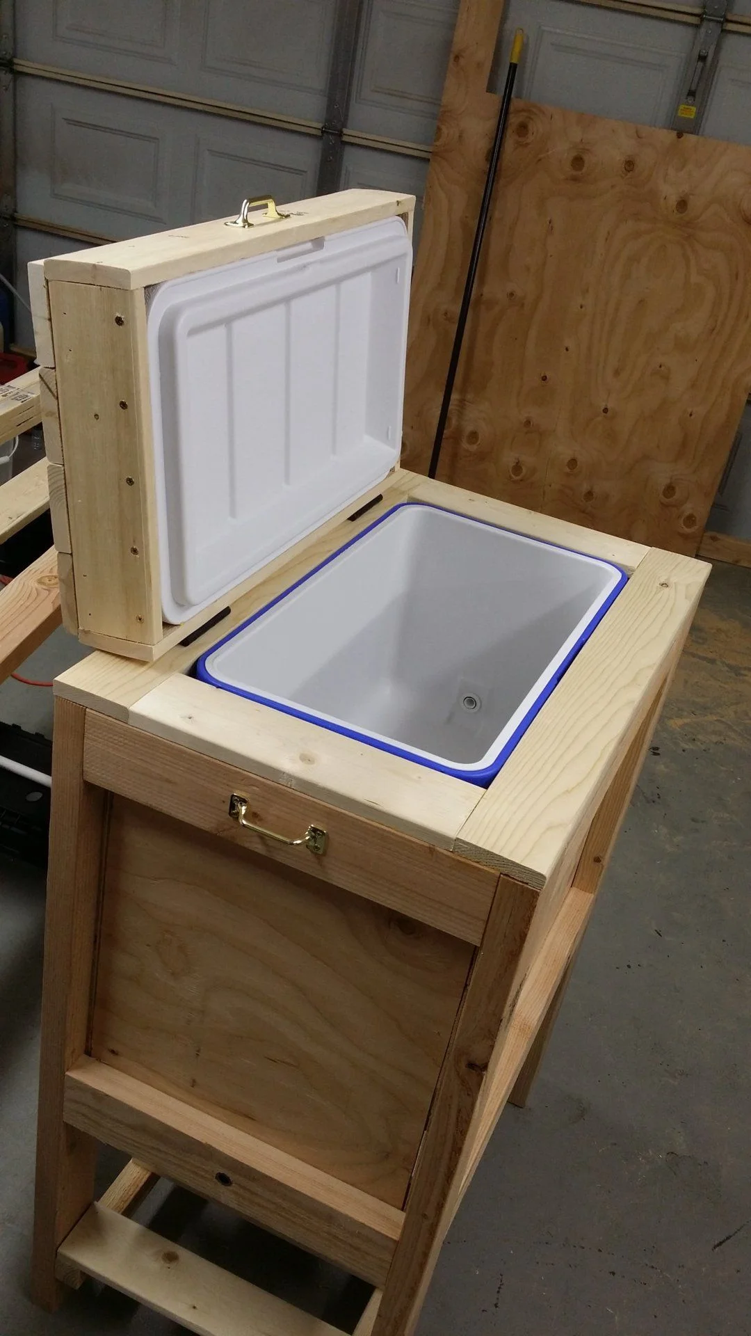

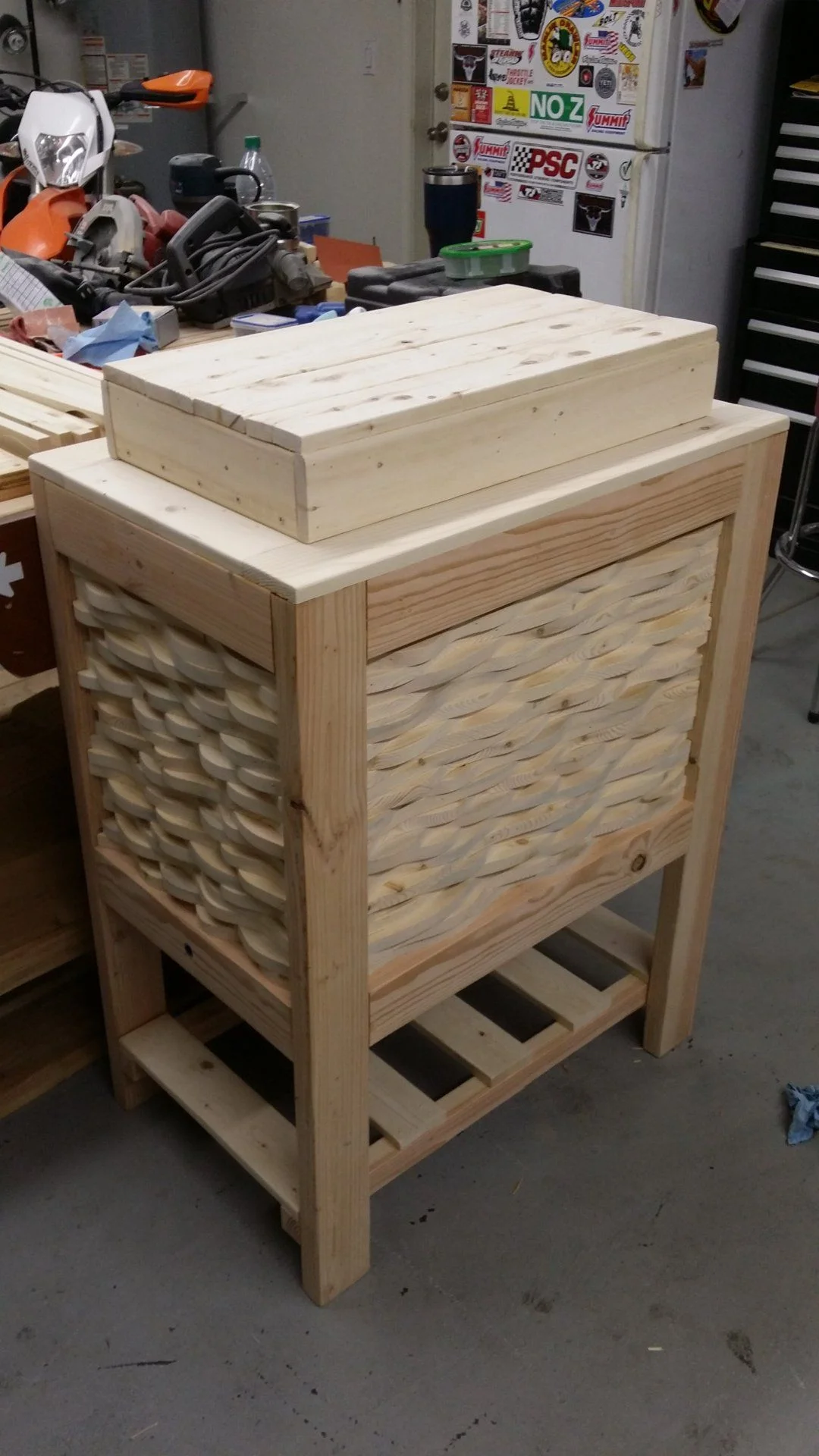

To this indoor/outdoor cooler.
full
full

Hey,TwelveGravity, I know this is an old thread, but the wood working you did is just perfect. I have only one question - did you do something to make it waterproof? I want to do something like that for my bathroom, but I don't know how making it waterproof. I was looking for an answer and one of my friends send me an article about finish waterproof wood on pursuingoutdoors.com. It looks convincing enough, but I don't have any experience in it. As I can see, unlike me, you're a true expert. What can you tell me about the finish oil? As I can see you used paint. Can it protect wood work from water?
Thanks for the kind words. I am far from an expert though, I just wanted to make something for a family member, saw a picture of one of these coolers and went to work. I've built another cooler for myself just like it. I will have to put up a picture of it. As far as water proofing, I just used a Min-Wax Polyurethane clear coat. I would have to read into waterproofing to know more about it, perhaps using poly's or spar-urethanes are acceptable ways.

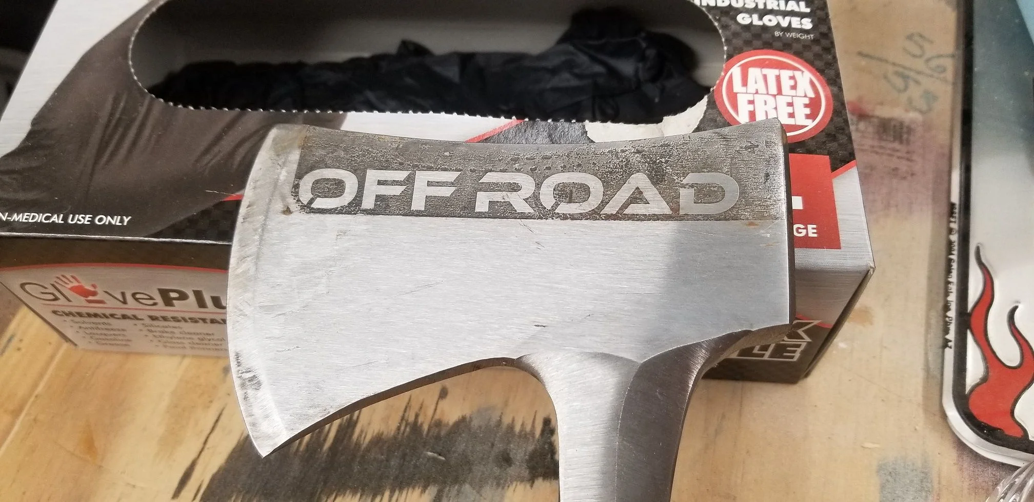

One of my next projects I wanted to try metal etching. I had never attempted it before so I thought to test it out beforehand.
I first tested it on my camping ax. I was surprised to see how it turned out so I did an ax foe a brother of mine. The process was to cover what you do not want etched with a vinyl sticker and tape, then use salt water and electricity dabbed onto a cotton ball.
This was my very first attempt. I had a sticker from a recent purchase RCI Off road Bed rack that I didn't put on.
full

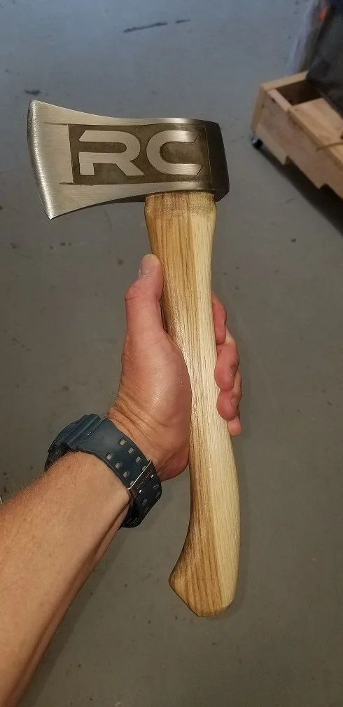

After that
full
