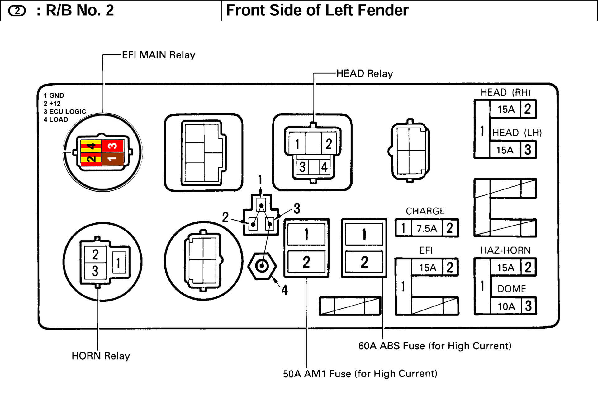

Check the 15 amp EFI MAIN fuse in the underhood relay box on the left fender.

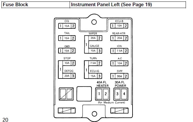

Check the 7.5 amp IGN fuse in the fuse box by the driver's left knee.
Check the 15 amp ECU-IG fuse in the same location.
Check fuses with a meter, not your eyeballs.
Alright, I rechecked everything with a meter multiple times and everything checked good; almost.
The continuity on the third little pink fusible link was sketchy. When I held it firmly I would get a good tone, if I left it loose it would drop in and out. I dug through my spares and luckily I had a new set. I got them installed and the truck fired right up!
