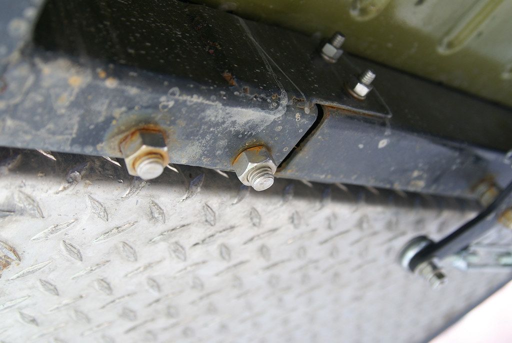

everything is working pretty well, but i'm a little disheartened by how quickly we're getting a little rust:
it's not really that bad, but, well, a disappointment. I've taken to storing it indoors. wondering if it has anything to do with galvanic corrision from having a battery grounded to the frame.
Don't let it bug you. Mine started to show a bit of rust pretty quickly too... just wait for your first good dent ;)

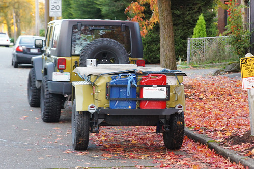

it's been a while since I posted here, but to answer a question from before, i needed to to the lift because now that the trailer is so long, I really need to get it up in the air so it dosen't high center. there's a lot of distance between the trailer axle and the rear axle of my jeep.

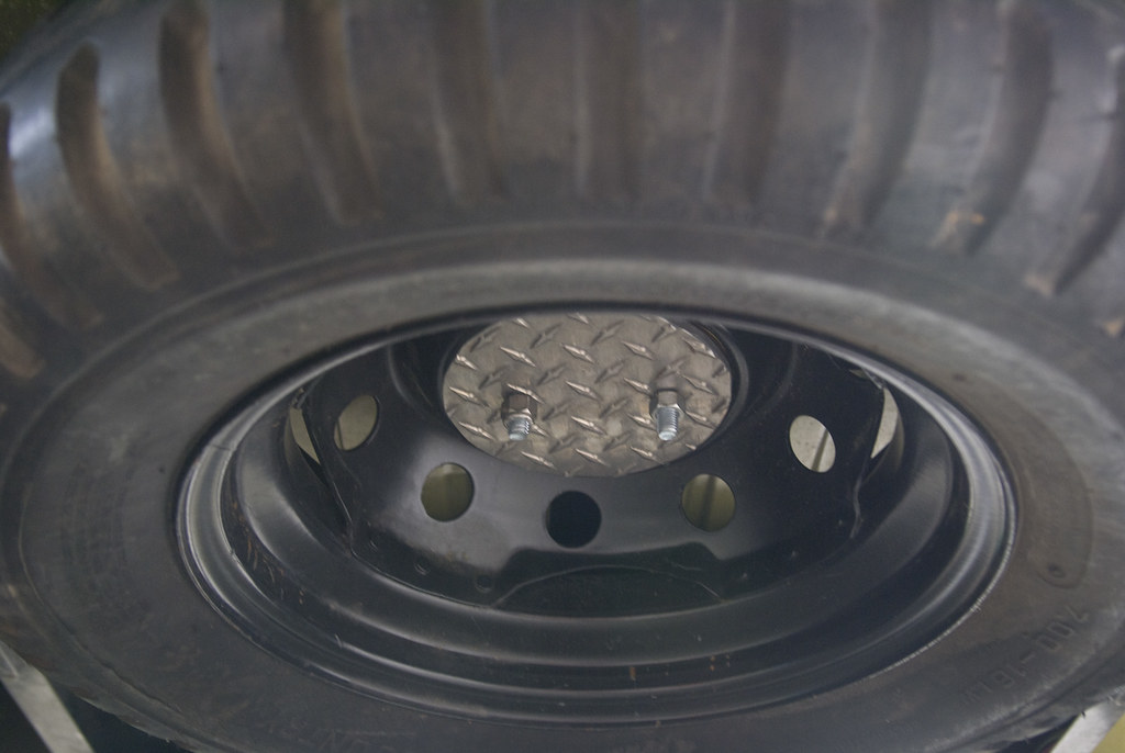

anyway, i'm 90% done with mounting the spare. with the "stock" spare, it fits perfectly up underneath the back of the trailer
I'm also 85% done with converting the tongue jack to a smaller unit... hopefully I can finish it all up this weekend.

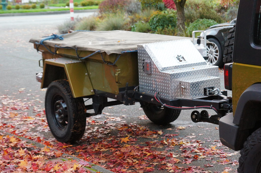

did a little more work, and the trailer is "done" for a little while... at least until I get the lid made!

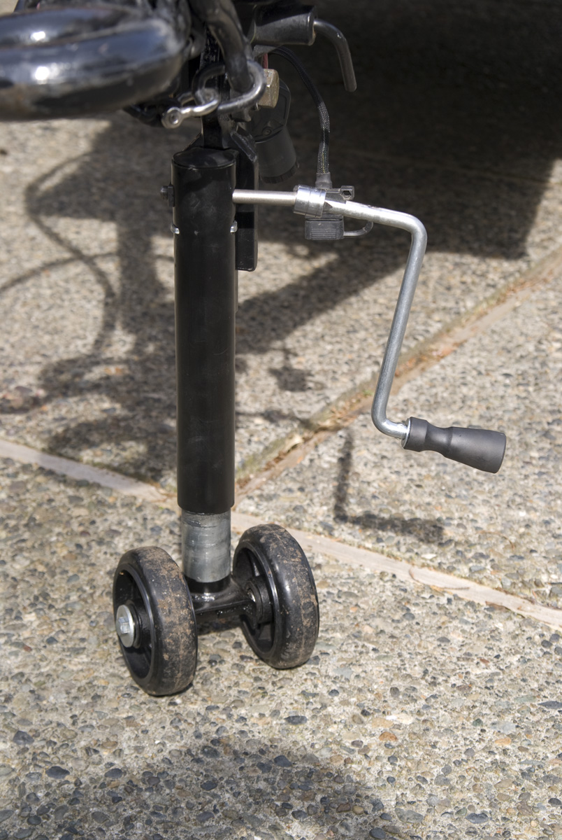

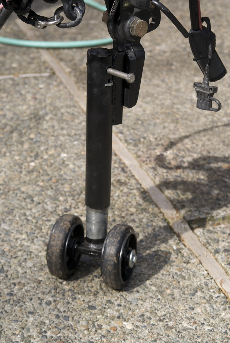

shortened up the landing leg, and put a couple of wheels on it. this is what I started with originally:
but with a little welding, grinding, rebuilding and swearing, I now have this:
the annoying part is/was that I had to make the crank removable... it was simply too short to clear the frame.

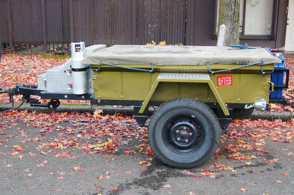

I also (finally!) mounted the spare up off the last cross member of the frame. tucks up really nicely. sorry for the bad picture, but you get the idea.

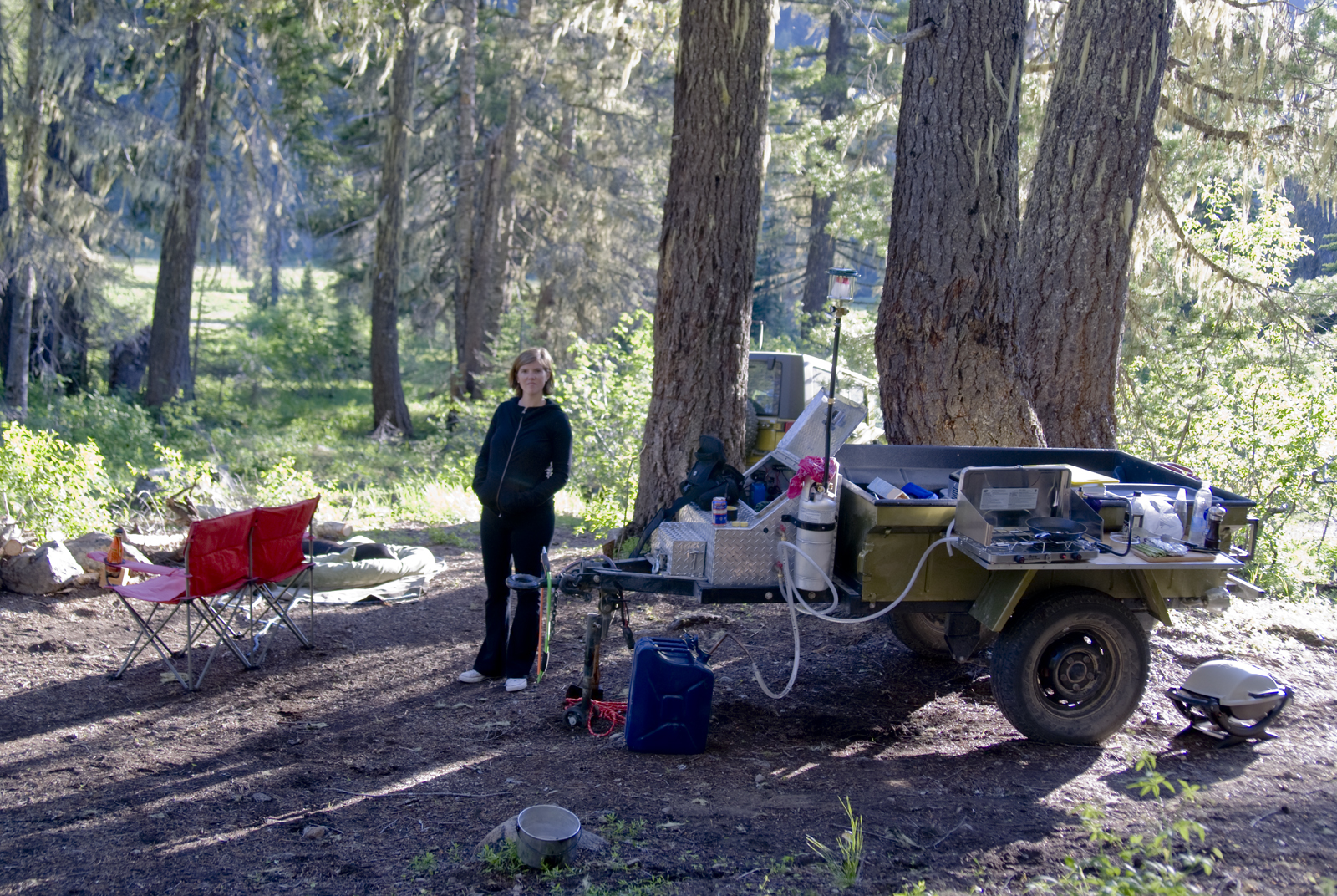

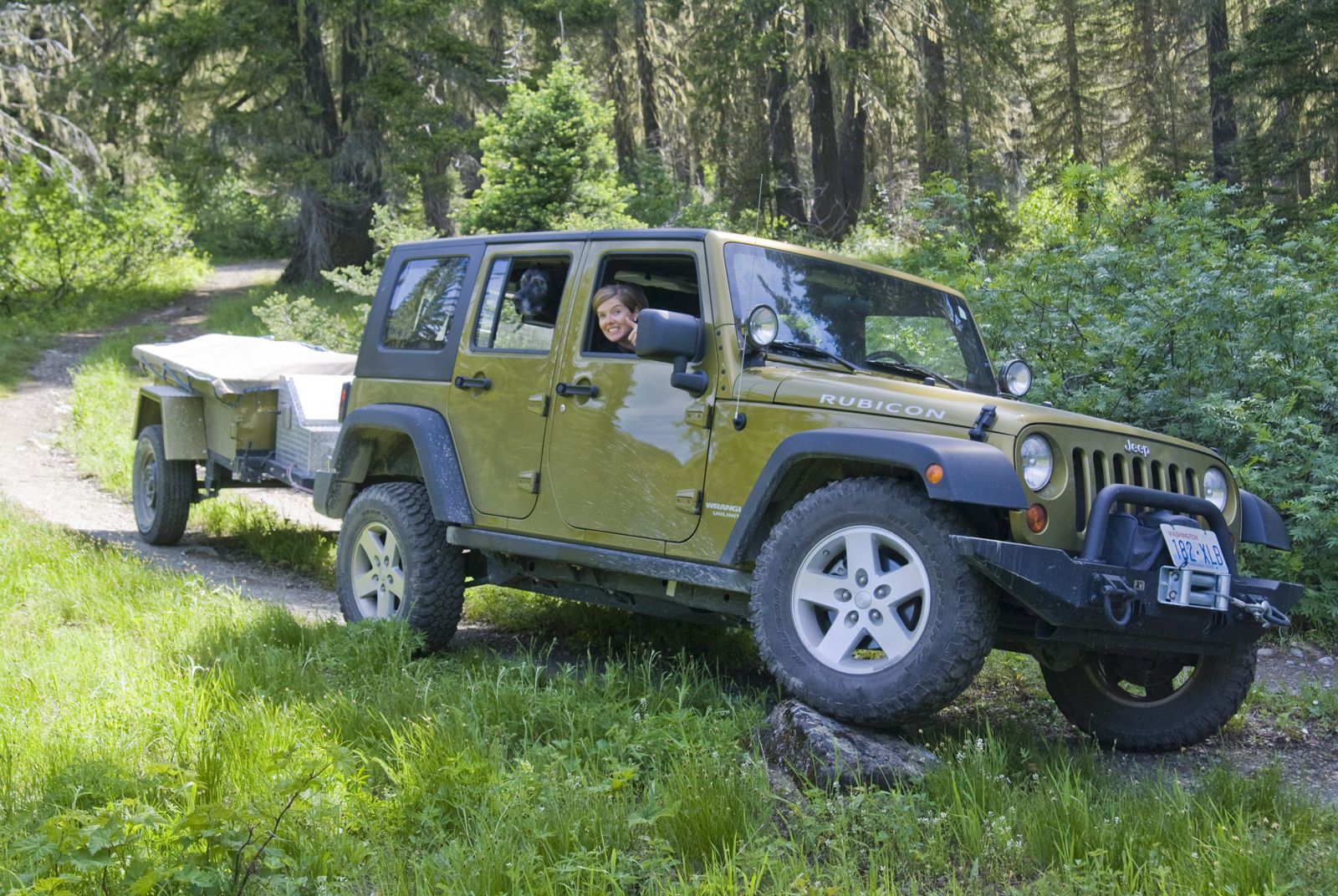

I've been so busy with other projects, I forgot about the trip report! took her on the maiden camping voyage a few weeks ago, and it was awesome! the only thing that didn't go according to plan was that I forgot one of the hookups to the water heater, so we didn't have hot water. also found out that the trailer (even unloaded) is about impossible to position by hand on anything bumpier than concrete.
despite the fact that my wife was 7+ months pregnant, she was a great sport about the whole thing. (wouldn't allow any off roading though!)
this is up north of roslyn, washington

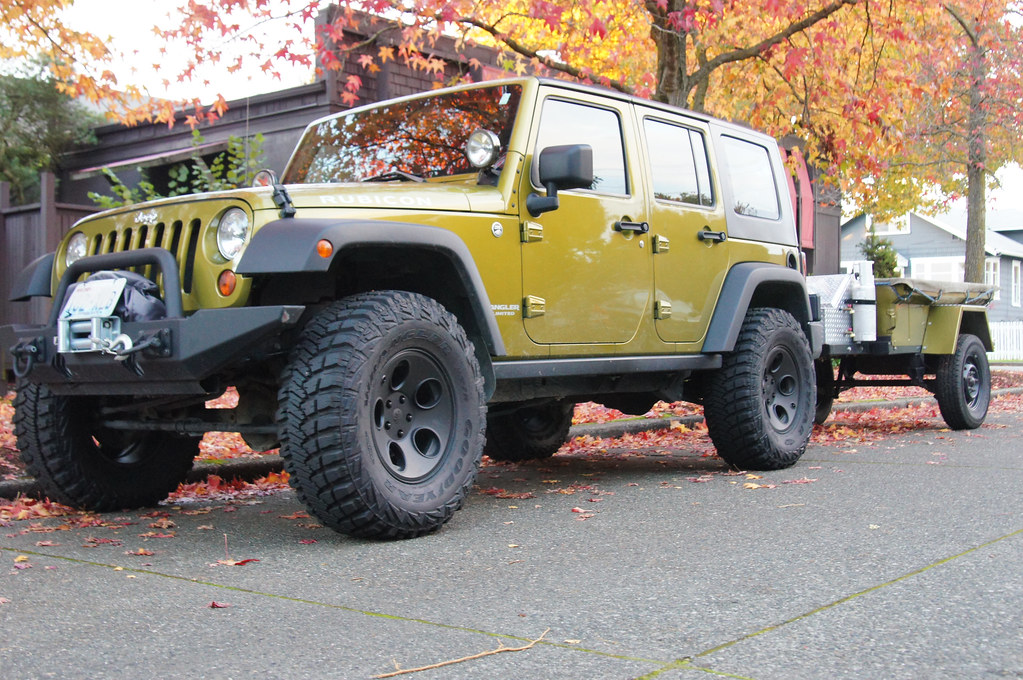

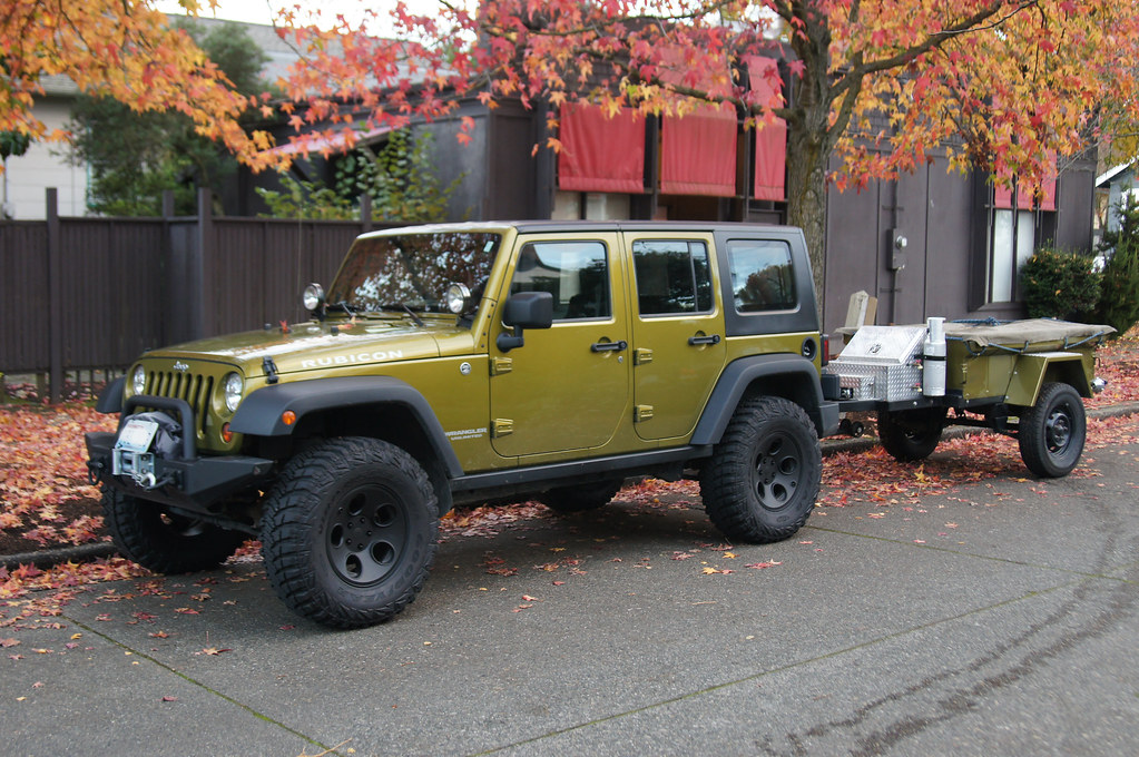

thought I'd post a couple of pictures now that I've got the lift done!
I gotta say it... I think it looks pretty badass!
Your rig is only getting better! Very nice.:clap:
Your build is splendid indeed! Would you describe or show more of how you mounted the spare tire? Did you use a crank up apparatus or just bolt it to the cross brace on the frame?
One last inquiry, what size tire are you using on the stock rims?
