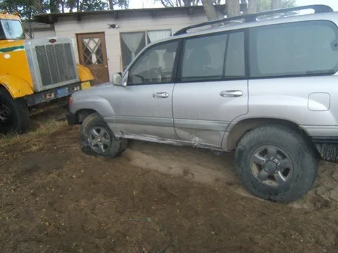

Yes, my baby had a little discussion with some boulders that were hiding in the side of the trail.
I've decided to just let it go, and start over again. The frame is bent just behind the suspension and both lower cross members are out of alignment. The engine is over 1.5 inches to the right, and the front wheel is 3 inches farther back than the engineers had in mind. The sad part is, after some driveway alignment and putting my other set of rims on it, I've been driving back and forth to work.

Really sorry to hear of the demise of your truck.:mad: From your "featured truck" thread, I remember you had a very nice rig with losts of mods.

As an aside, did you have rock sliders? In your opinion, relative to the type of "conversation" your truck had with the rocks, would the addition of sliders have helped reduce the damage to body and frame or did they magnify it.?

Sliders = == Yes, they would have helped and probably saved 95% of the body damage. If I had sliders on it like I wanted to build, I would be fixing it and have a trail rig with no worries. And now I'm finding a couple more 100's with the diff lock, so I think I'm just going to go the easy route and buy one already equipped. Still have to swap my four pinion diff over though.
