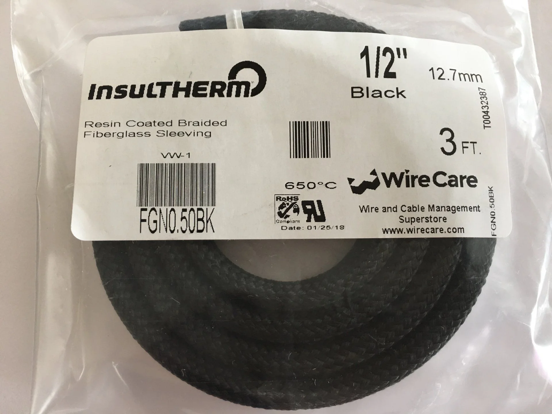

Thanks for all the suggestions. They are all great options! I found some Insultherm the most economical as I was looking for a small quantity and it came today.
