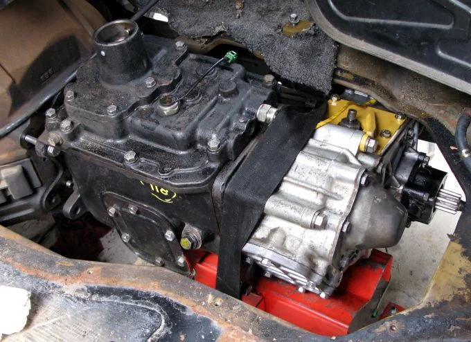

Found these images here on another thread (thanks Martian). This is the wire - as Fast Eddy says, looks like some work to get to it. Might be time to POR15 my drivers side floor if I need to pull all that stuff.

That rubber boot is starting to look familiar. Here's a picture from my tranny install showing the high-gear switch and the bellhousing boot:
attachment.php
It seems you should be able to reach up and feel the lead wire from the driver's side. I'm not sure about actually getting it plugged together.

Problem is - mine seems to have snapped off at the switch. :frown: Guess it's time to pull all that stuff and POR15 the floor. Not sure if I should be trying to fix the wire/switch or replacing the whole switch? Should know more when I get in there. Does that big transmission cover require a gasket?
