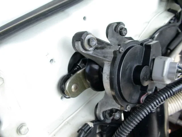

I pulled the lever arm (with the ball joint thingy) off the back of the motor when I rebuilt the motor and ended up installing it 180' out, so my wipers
ended up hitting the cowl. I figured it out by painting some white dots on the tips of the splined linkage spindles/shafts (where the wiper arms attach) with the wiper arms removed, and found that 180 degrees off at the motor equated to 45 degrees of wiper arc at the wiper arms.
In my situation, because I had removed the lever on the rear of the motor, once I repositioned that lever 180' the wipers clocked correctly.
The photo below shows the final relationship of the lever arm of the motor
to the linkage: linkage was fully extended best as I recall, lever arm pointing to the 9 O'clock position:
All done. Yes the motor arm needs to be pointing towards the bump on the end of the motor. I thought I had assembled the rebuilt assembly like that, but when I first did it everything seemed bound up and would not move. So took it all apart and thought maybe it was a dud motor, but it worked, but now the arm moved to what would be 180 out, assembled it all again, nd it worked but yeah 180 out as the wipers stopped in the upright position. So all apart again, reposition the motor arm, put it all back again, and it works...yippe kai ay.
