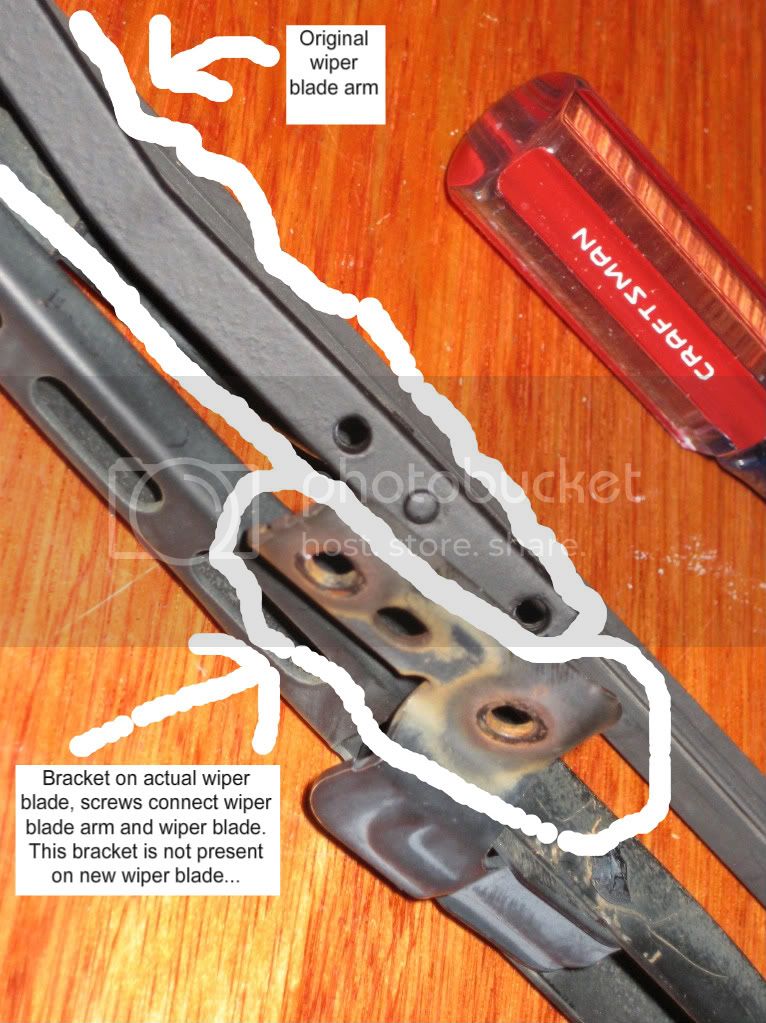

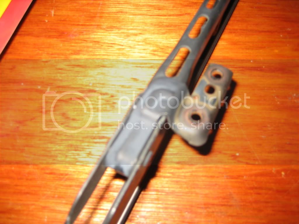

I bought a set of new wiper blades from CCOT for my 88' FJ62 and cant figure out how these go on. I'm trying to connect these new wiper blades to my original fj62 wiper blade arms.
Original wiper blades & wiper blade arms:

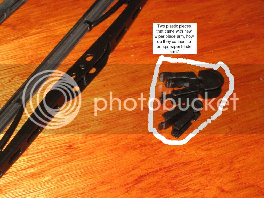

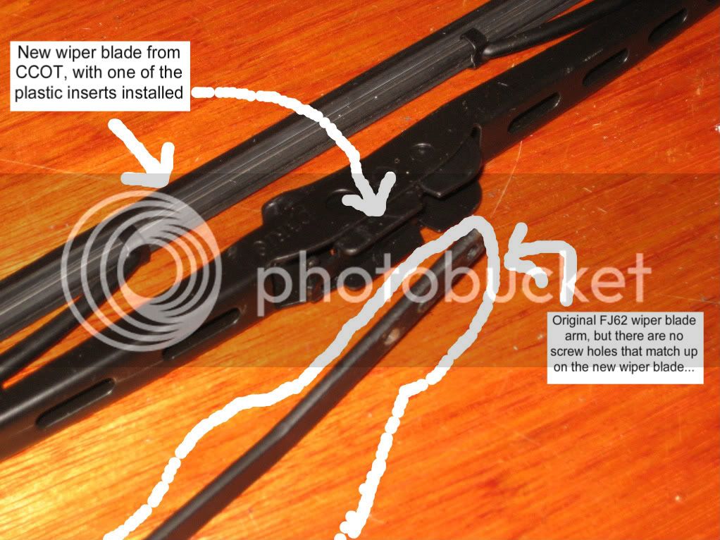

New wiper blades and original wiper blade arms:
Can anyone tell me what i'm doing wrong & how to put this all together??
they didnt give you the correct adapter...

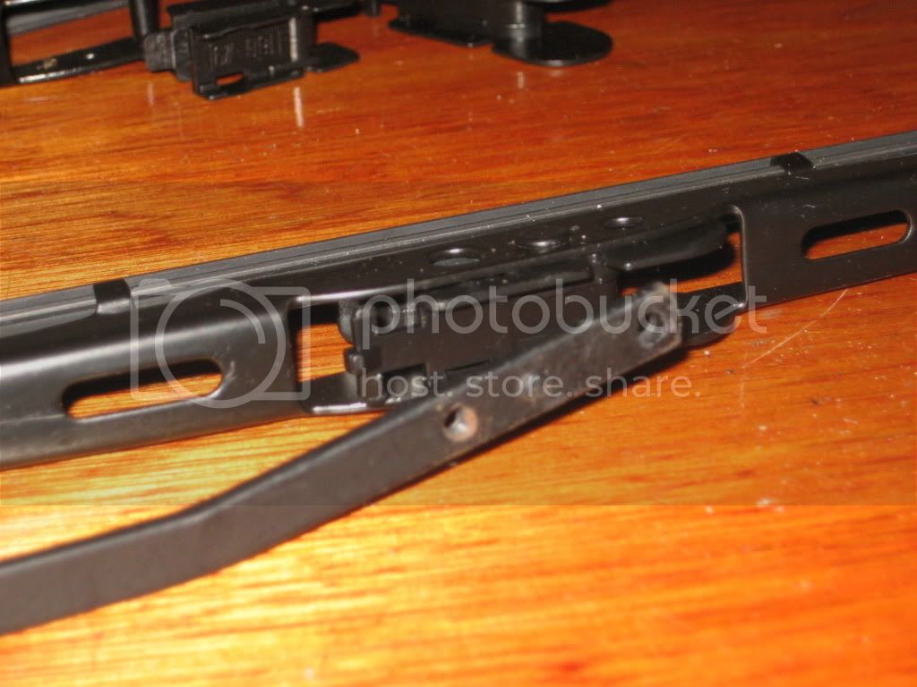

if you give me a minute ill snap a pic of the adapter on my 42 out front.
the adapter just slides over the arm and snaps in place then you use the smaller of the 2 adapter you do have clipped onto the wiper blade and your done, takes 30 seconds when you ave everything.
