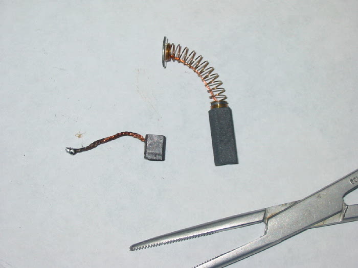

I rebuilt the motor in my '75 with some good info from spotcruiser; I took pictures of the process 'n everything (I can post those up here if it'll help).
Here's the info on the brushes I got. Can't remember how many were in the package, but it was more than I needed (don't remember the price). Had to shave them down some, but that was the easiest part of the whole process! The '67 motor may or may not be the same. I'll try to find the remaining brushes in the shop tomorrow if'n I get a chance...
Here's a new brush (part # above) compared to a worn out OEM from my '75...a little bit of tinkering with 'em and they worked like a charm. Thanks again, spotcruiser!
