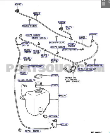

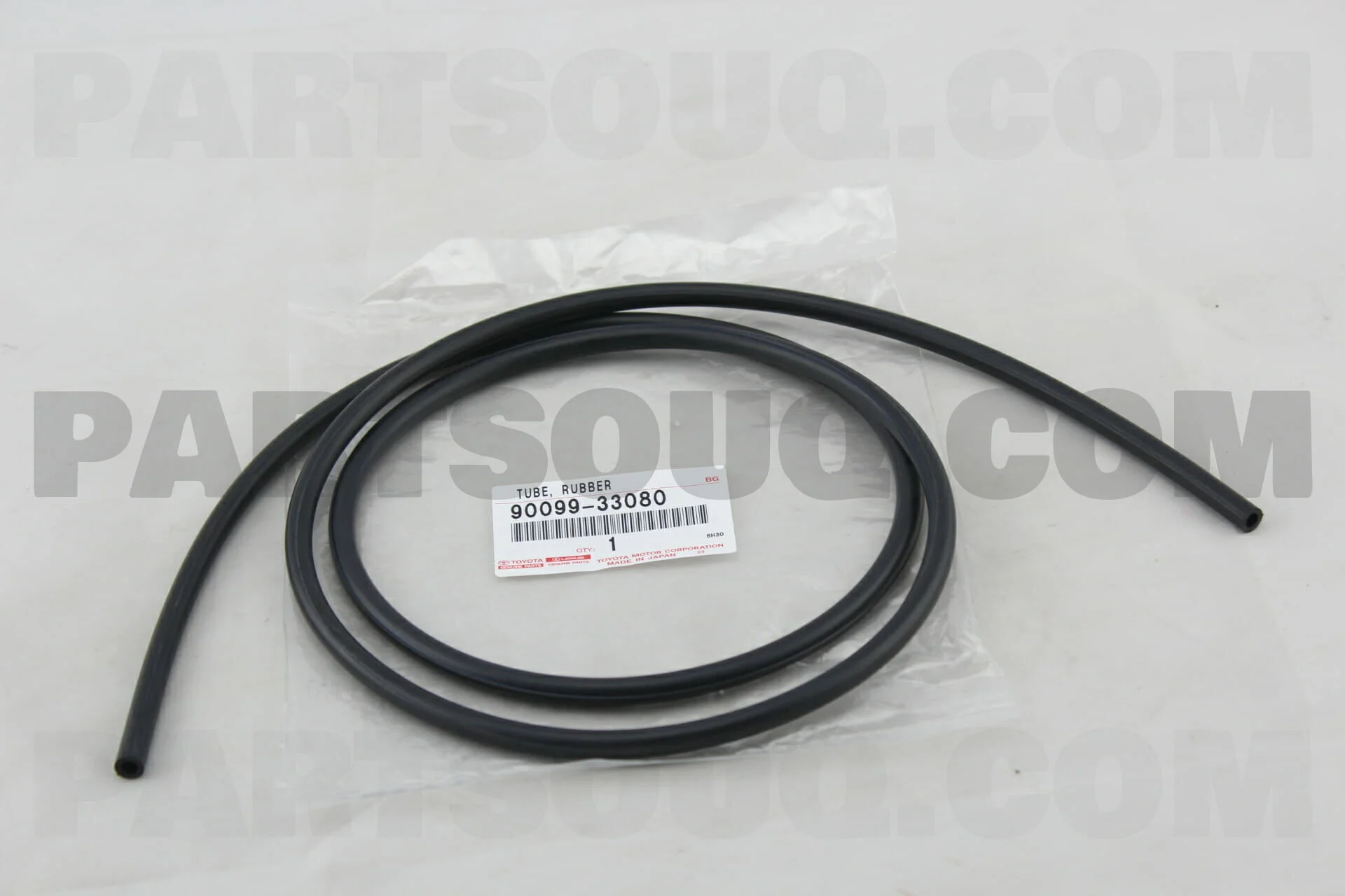

There is bulk hose available (90099-33080) that you can cut to fit. There's also the rubber grommet where the pump inserts into the washer bottle/tank.
Have you called your local Toyota dealer parts Dept?
There is a Toyota hose "kit" which is cut to fit for the hood section of hose going to the squirters and AFAIK another for the other section from the pump. There's also a rubber grommet where the pump inserts into the washer bottle/tank.

The advantage is that the hose and hose connectors are the correct ID for the system, no guesswork and not very expensive.
90099-33080 is a part number for the bulk hose, cut to fit

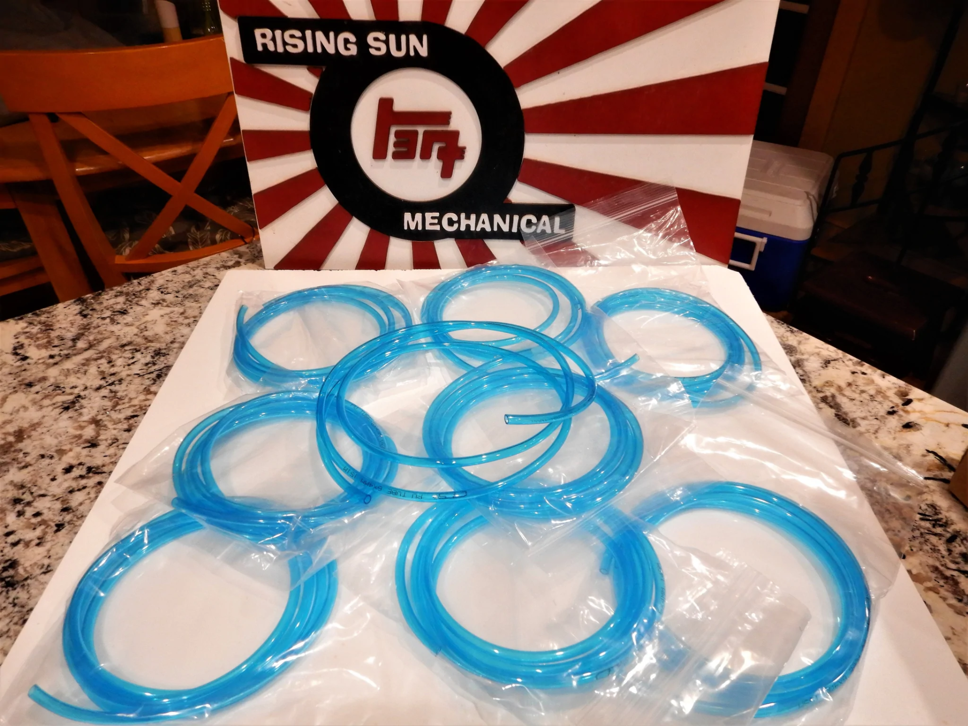

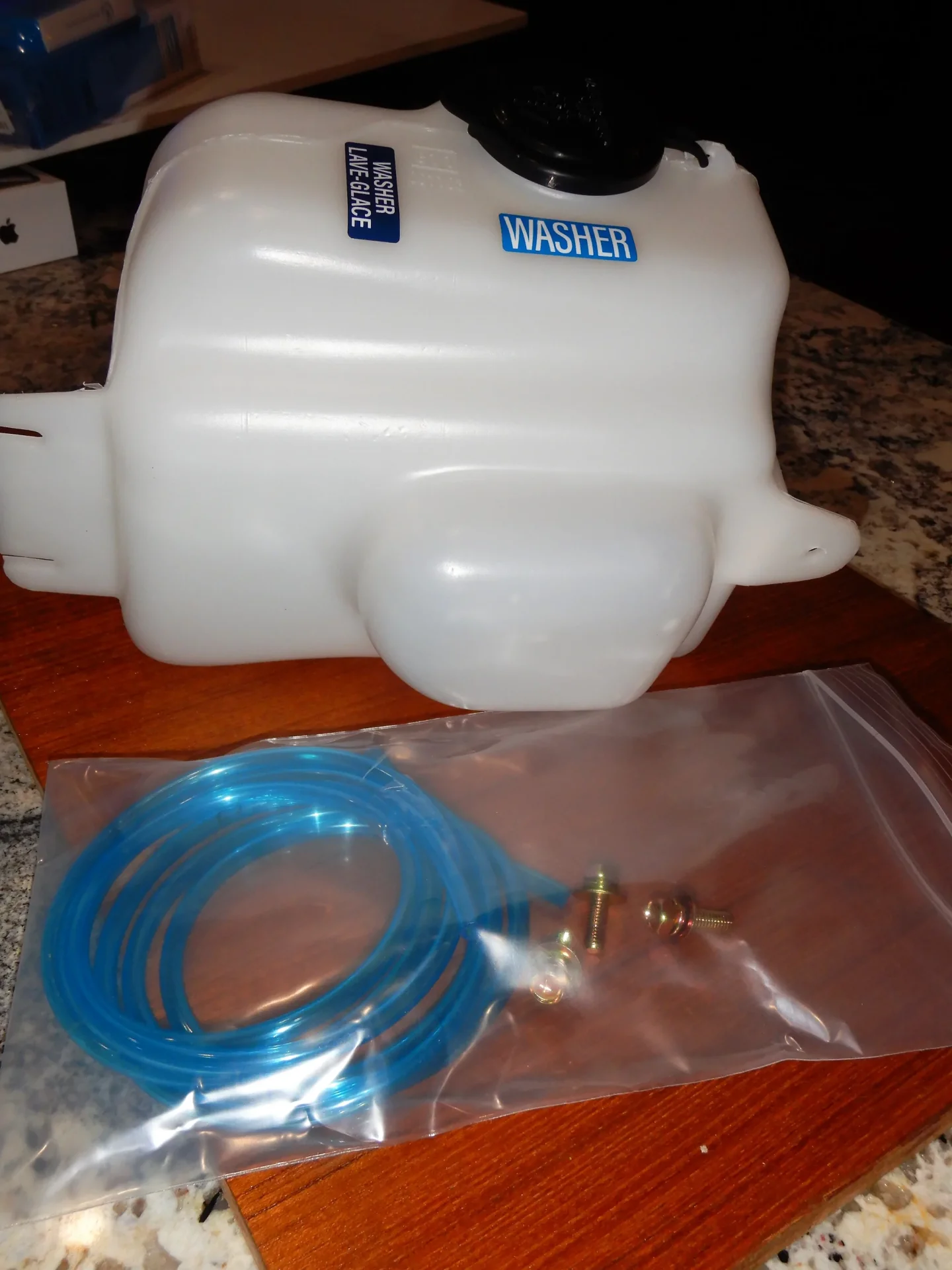

- i don't violate anybody ........ :popcorn:
- this
ain't Generic Hose .........:rolleyes:

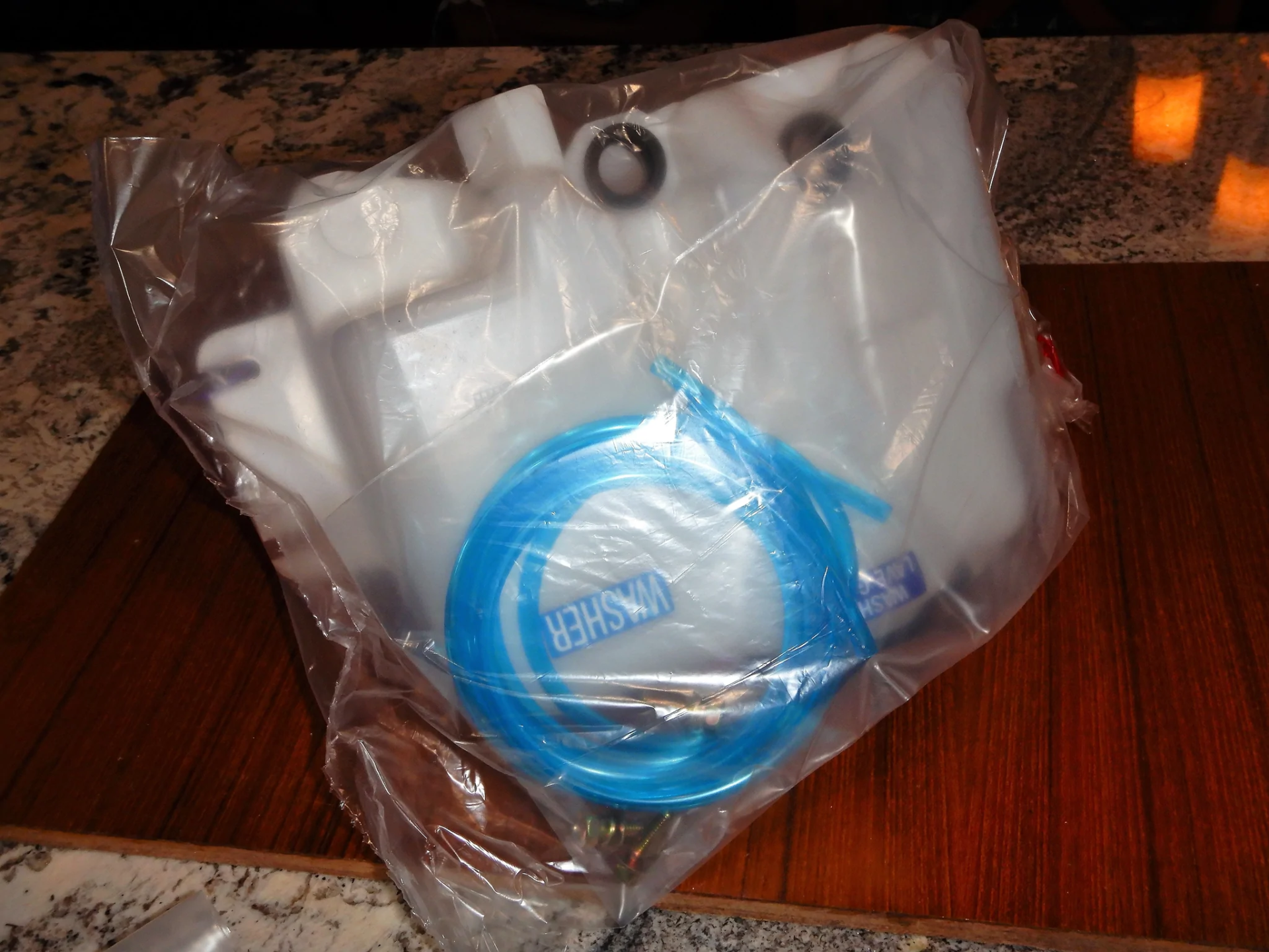

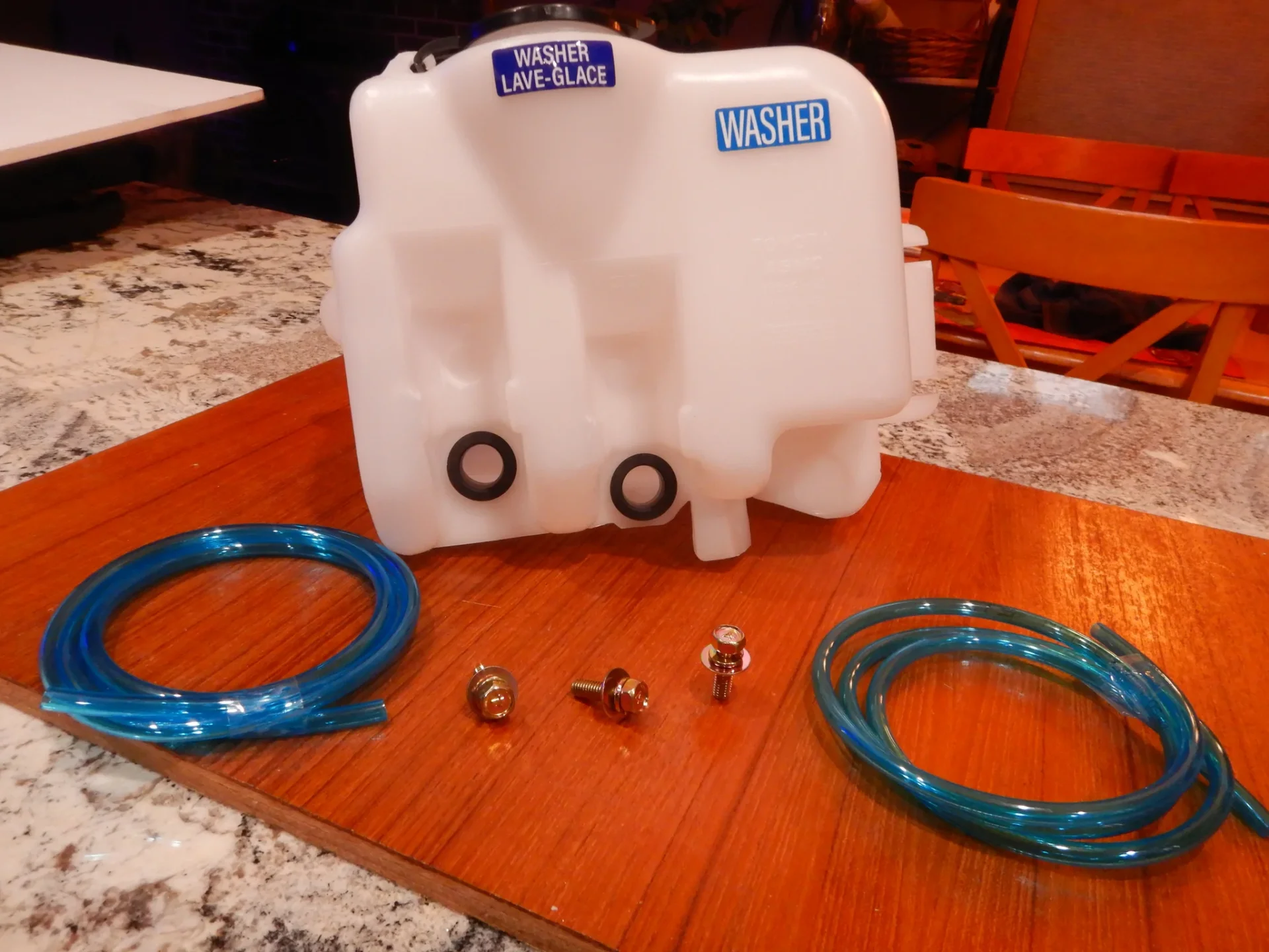

- this IS the correct ID size spec. for ALL 80 Series Land cruisers GLOBALLY ...........:idea:
100% of ALL washer Bottle and Pump Motor Kits i offer up and ship out include this exact time tested JDM spec. washer hose ....
- this

Anyone have a pic of the routing for the hose?
Doing a restoration and want to make sure we route the hose correctly.
