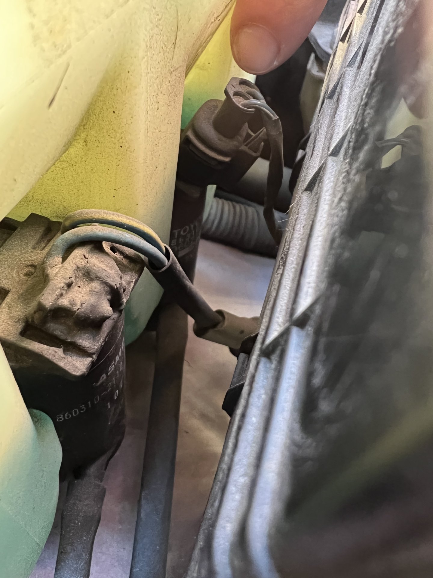

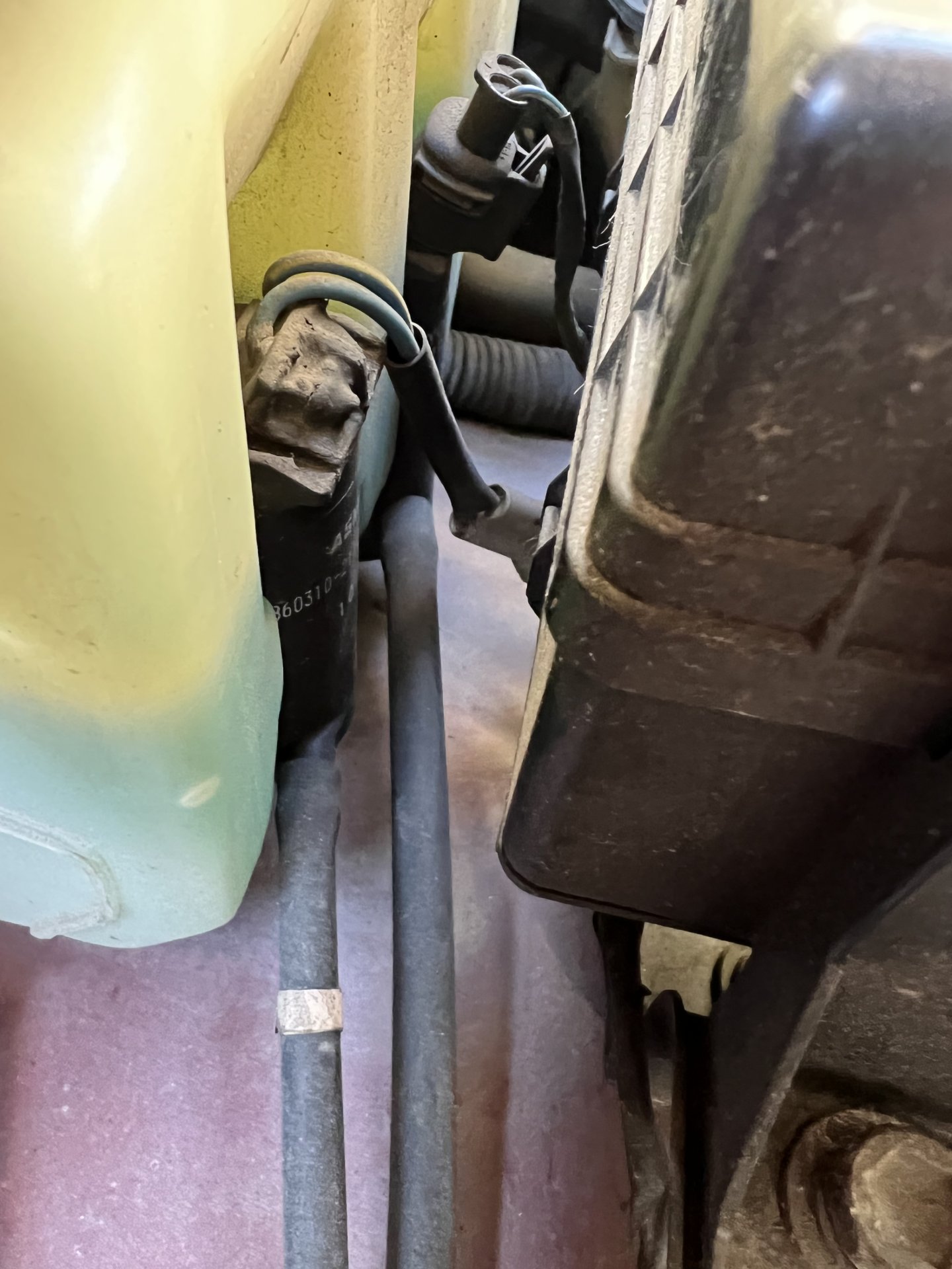

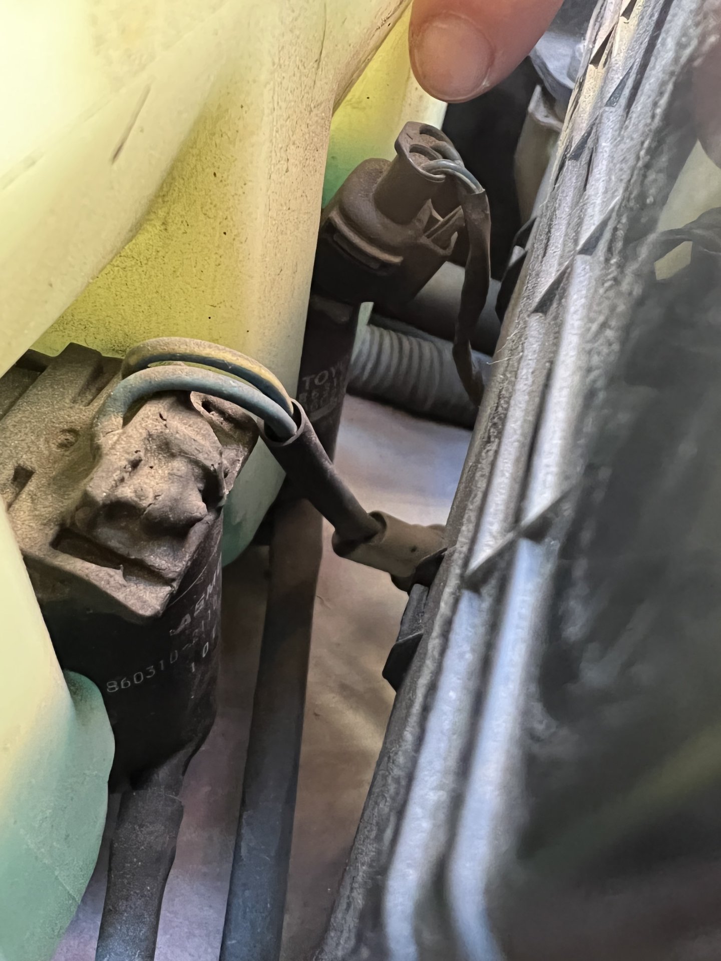

The front and rear washer fluid hoses come off of the reservoir tank separately. Here’s a couple pictures of what I’m talking about. The photo with my finger in it is showing where the front washer hose comes off the tank.
Disconnect the hose from the reservoir/pump assembly (no tools required, just pull it off I believe) and then activate the pump to see if you're getting any flow. If so it's a clog in the line. If not, check whether you can at least hear the pump motor whirring.

Mine appears to have two pumps, unless I'm mistaking the other black, pump looking thing that is attached to the reservoir and hooked up to the tube that feeds the rear window. See in the photos, the black thing that is just forward of the pump that my finger is pointing to. That black thing is connected to the tube feeding the rear window, and the other black pump is only connected to the tube that feeds the front windshield. I think that I'm not understanding exactly what I'm looking at here, and how it exactly works. Can someone please explain to me what they're seeing in the pictures I posted? The two tubes/hoses are totally separate, and are not connected anywhere in the system. One goes to the front and one goes to the back.

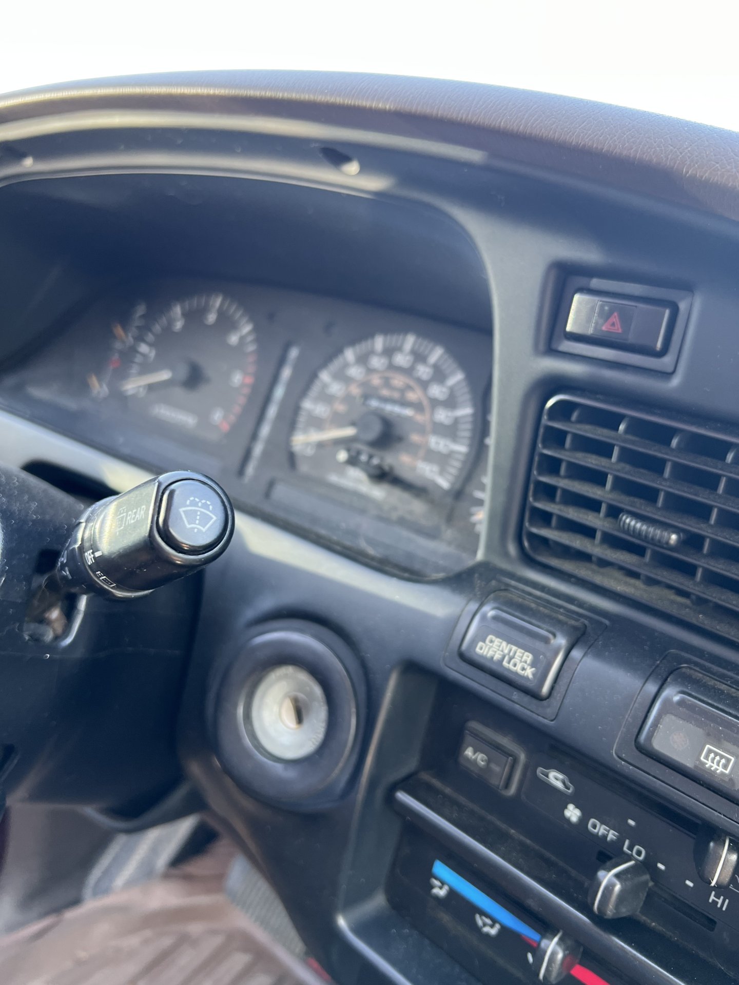

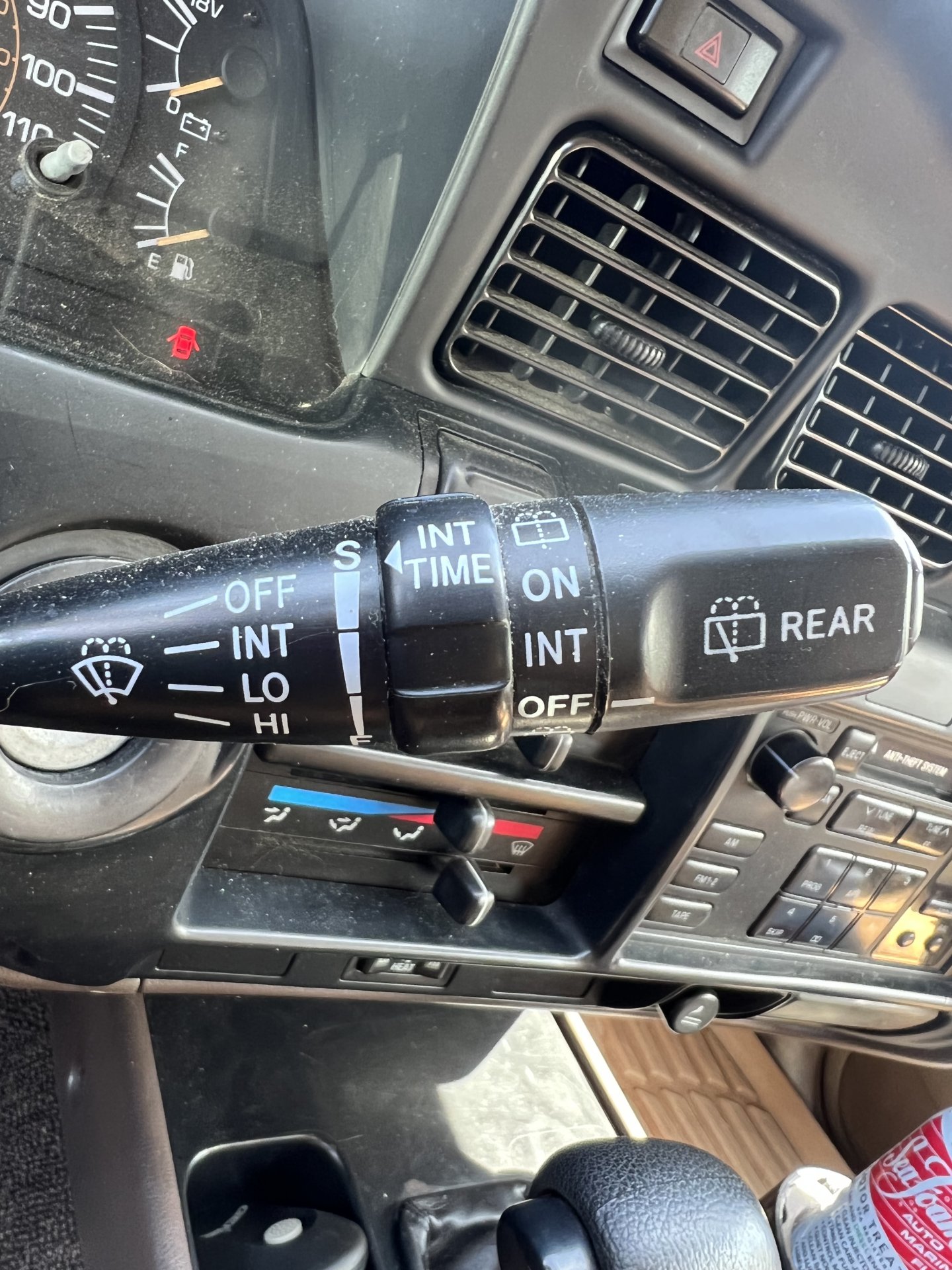

In the FJ80 the front pump feeds the windshield and the rear pump feeds the back glass. The push button on the end of the stalk activates the front pump. You rotate the outer knob fully to activate the rear pump.
Are you saying that you get the rear to work activating either switch?
Well cruiserdan, you just solved my problem. The problem all along is that I'm an idiot! I never even seen the button at the end of the switch/stalk, so I was never even activating the front washer pump. :bang: Thanks man, I appreciate it.
