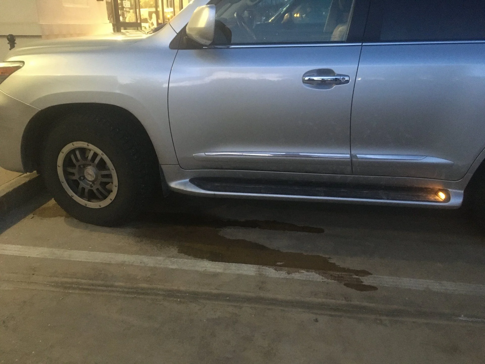

I poured a gallon of fluid in and it immediately started leaking from behind the driver side front wheel.
Any tips on where to start looking?

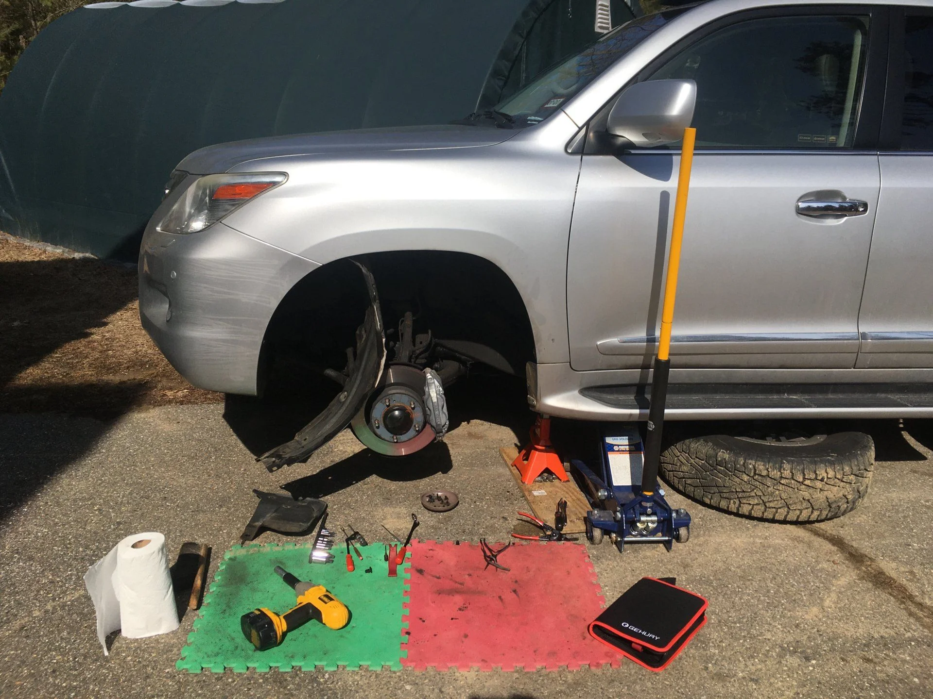

The inner fender liner will need to come out for inspection. The tank is long and sits in the fender over the front wheel. Given that all the connections and hoses are near the front of the tank behind the headlight, the drainage spot suggests the tank may be cracked. With that said, fluids can flow in wierd ways, so until you have eyes on it, it's tough to say.

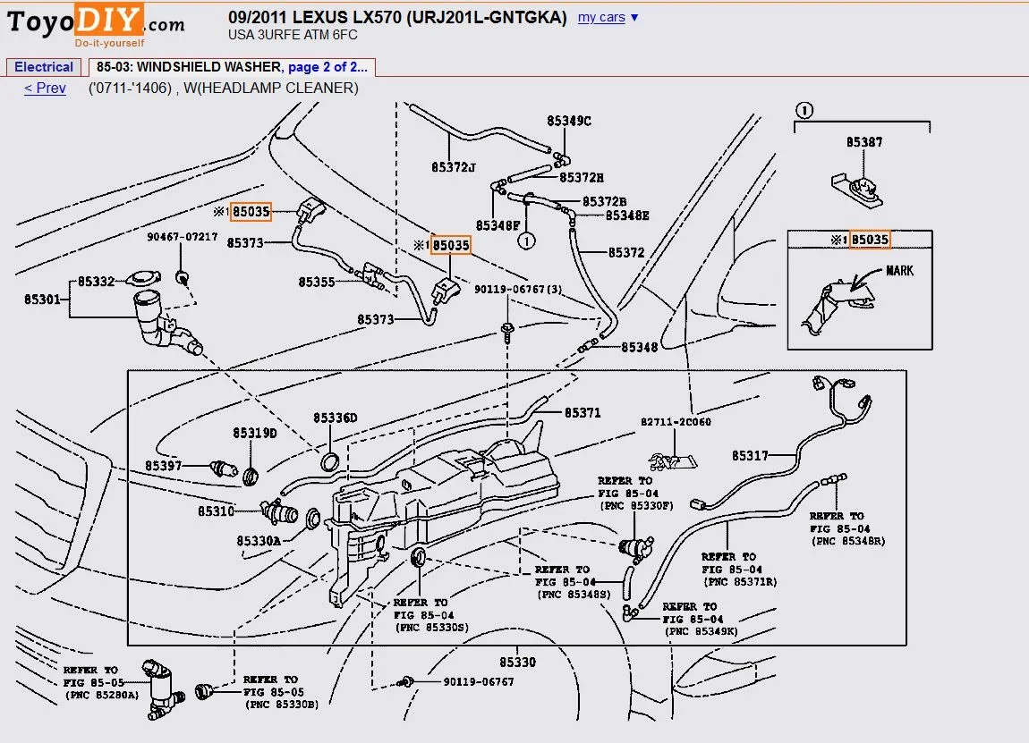

I'll follow your advice and just dug up this diagram to orient myself. If the tank is cracked and needs replacement, it looks like it's "Jar Assy, Windshield Washer" P/N 85315-60350 for around $80.

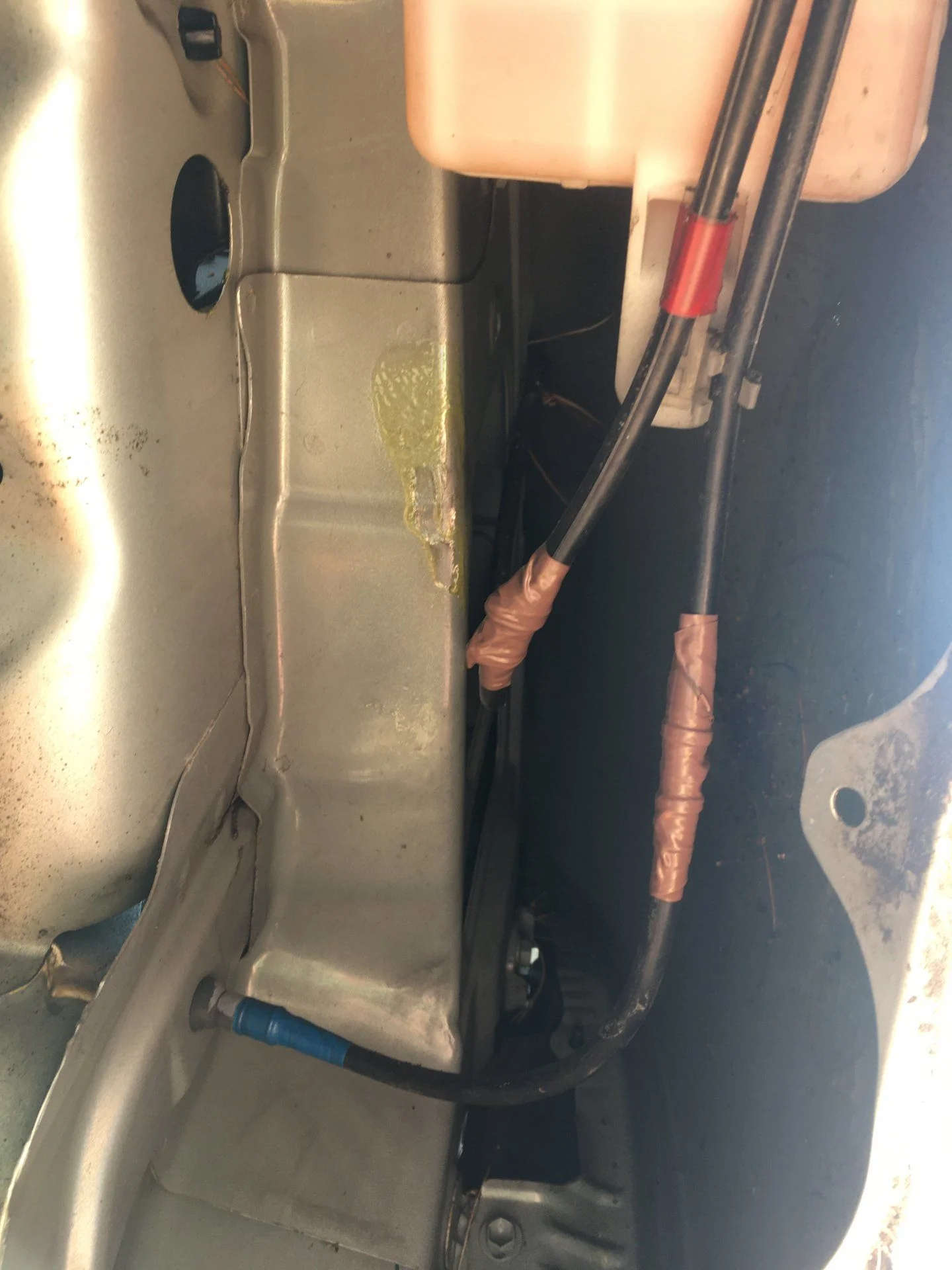

I opened it up today and fixed the issue. One of the hoses had come off of the barb connector.
I believe I know the root cause.
A few months ago, I installed a Slee primary battery tray upgrade kit to accommodate a larger battery. This requires that front portion of the fender skirting be removed; I left the other (rear) half in place. While I was in there, I thought it would be a good idea to spray some "Fluid Film" rust inhibitor on behind the fender skirting. I sprayed it blindly into the cavity between the rear fender skirting and the engine compartment. Some Fluid Film sprayed directly onto the washer hose. Looking at Fluid Film's website, it says "Care should be taken around non oil resistant rubber goods. May cause swelling.". Sure enough, it looks like the washer hose swelled/expanded and lost it's grip on the barb. I cut off the swollen section, added a zip tie and taped up the joint. So, I guess I'll be more careful spraying Fluid Film around rubber parts.
Below: Disconnected hose. Fluid Film on the hose and paint.
Below: After zip ties and tape.

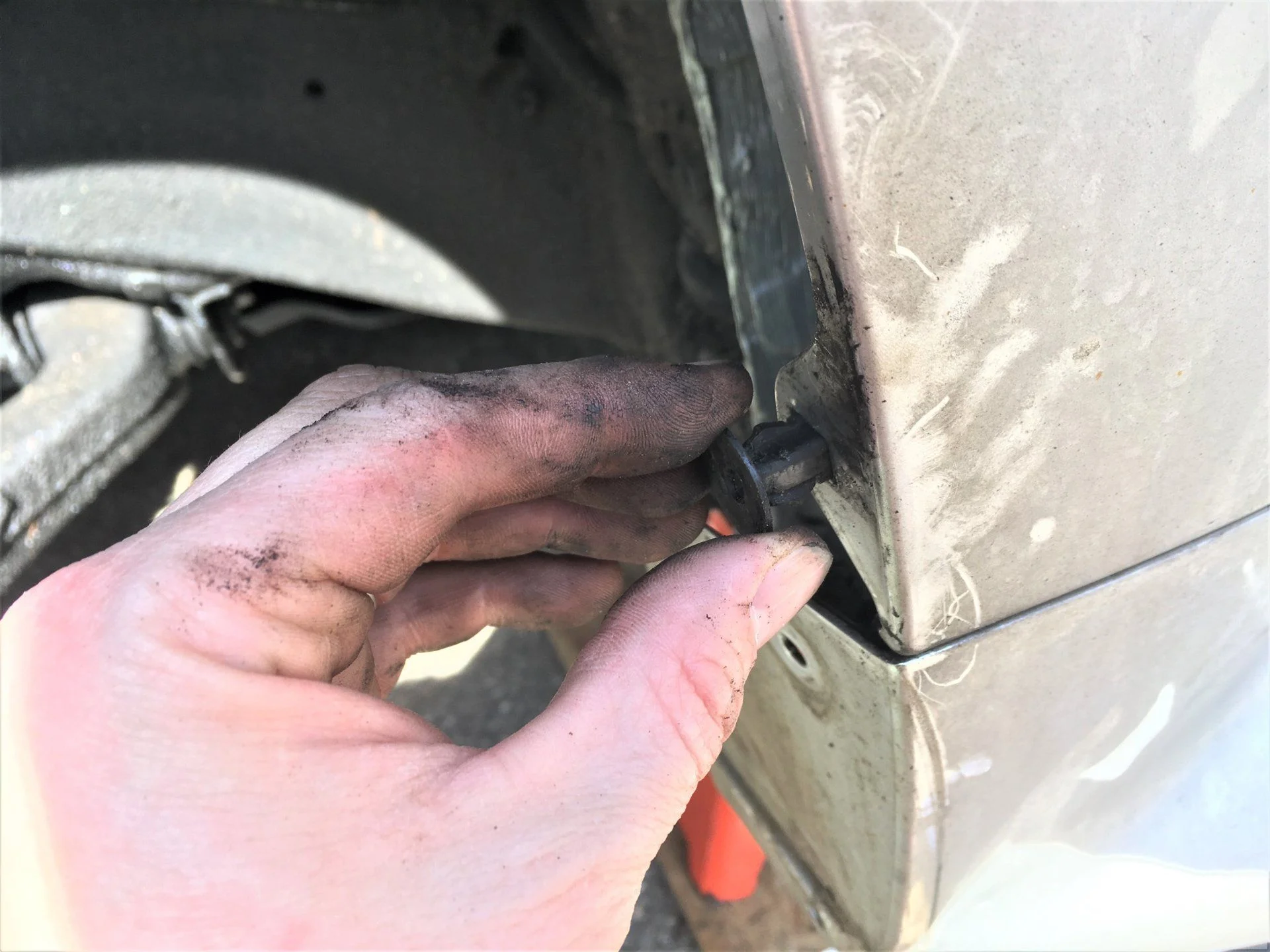

Below: This was the only part of the process that wasn't clear. These square-shank inserts that accept the torx head screws must be pushed out from the back before the fender skirting can be removed. There are two corners that need to be squeezed together before pushing them out from the back. There are two of these.
