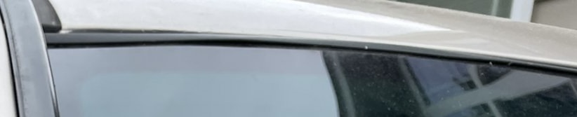

Kicking up a n old thread to see if I can get some light shed on wind noise issues. I have been progressively addressing a half-done windshield install, in which the shop didn’t quite do it right but also didn’t do anything that couldn’t be undone. Last weekend I popped out some big gobs of urethane from the roof side trim channels I thought were causing wind noise, but that wasn’t it.
It looks like the top trim is basically just loose enough to catch air, and if I blow on it I can hear what I believe is the wind noise I’m trying to track down. In the attached photo, it looks bad in this one as well…
Question - what would you do? Simple solution is running a bead of silicone underneath. More complicated is pulling and replacing it. After trying to pull the side molding, I’m paranoid that the top is set into the windshield adhesive and is going to be a pain to remove. Will silicone trap water / cause rust?

Did you verify they attached each side trim with 4 rivets? Wind noise is most likely whistling through an improper install of the side trim either by loose rivets, no rivets, or screws.
If the installer slipped that windshield a little low, water can get in there and rust the windshield frame.
Yes, I pulled what they previously put in as rivets in 2/4 holes on either side. Replaced all of them with OEM rivets + garnish. When I tried to pull them off completely to address issues on the roof, they were in so tight there was no way to remove them without ruining the side trim, so I just finished what I could on the roof without fully pulling the rest.
Also - now that the sides look tight, it’s pretty clear that the top trim is the culprit. So - pull and replace with new, or silicone and hope for the best?
