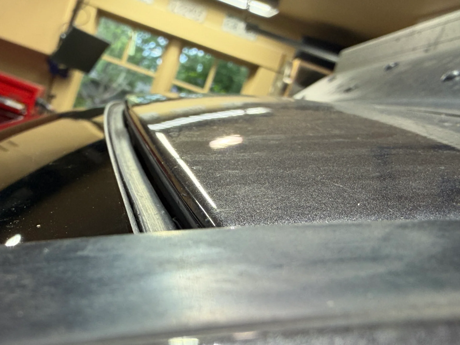

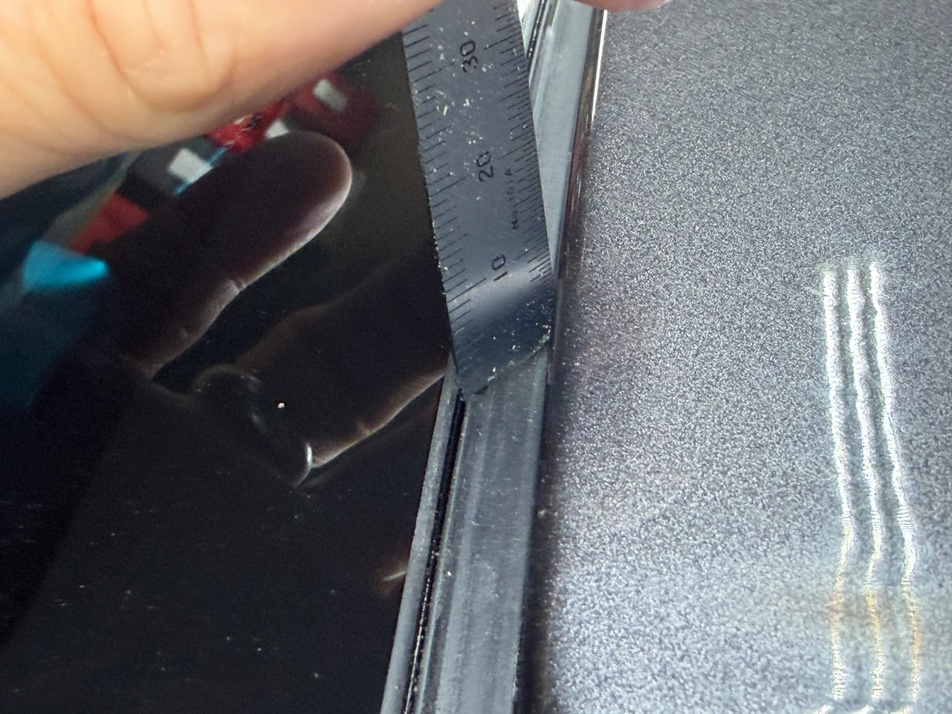

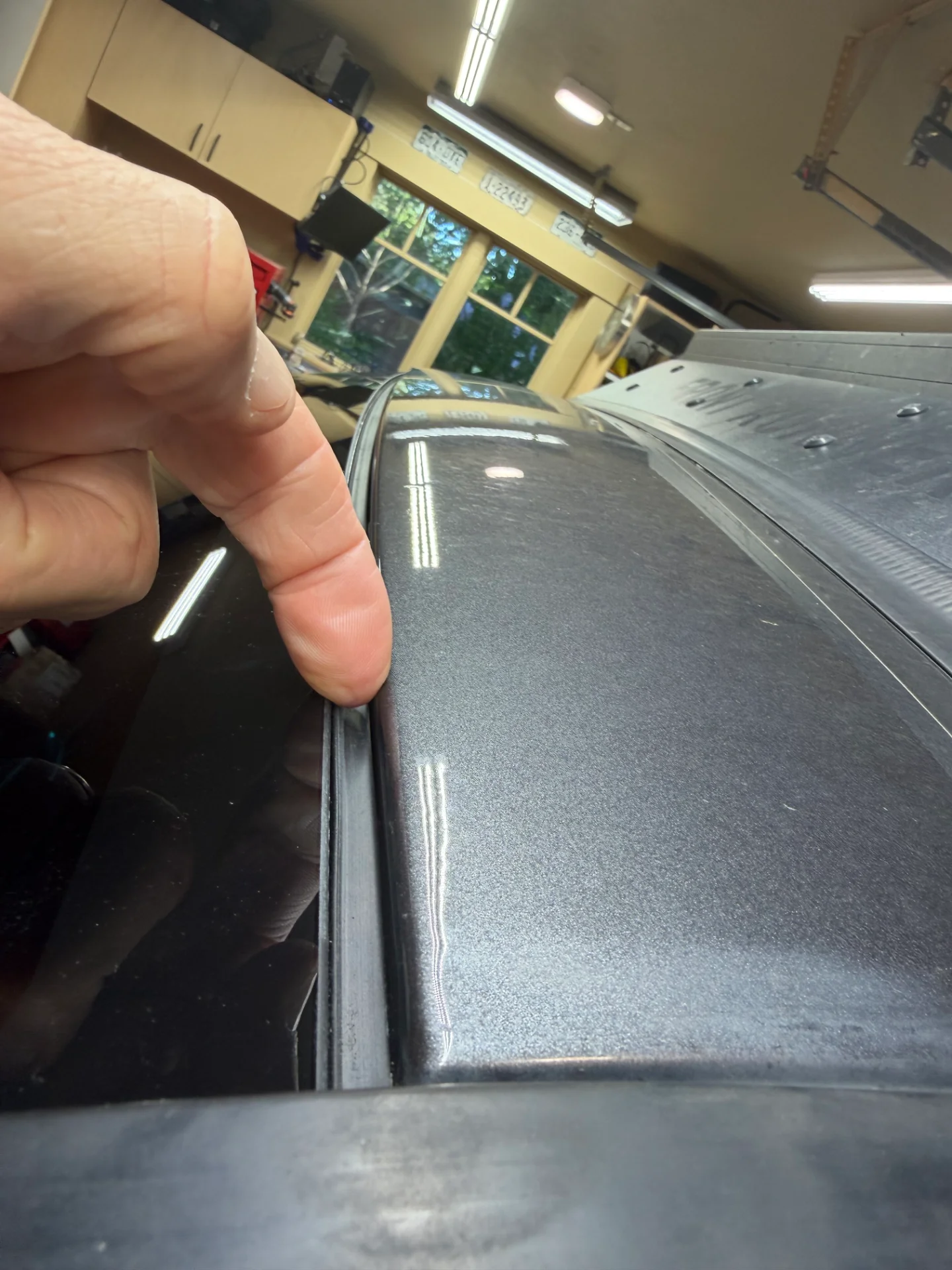

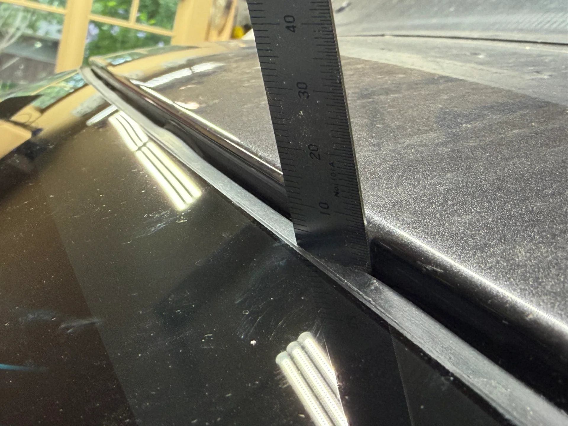

Had my 21 HE windshield replaced Friday at Caliber in Castle Rock CO. Just noticed this morning that there is a small ‘gap’ at the top of the windshield. Would seem like this was something that had a trim piece installed, but for the life of me, can’t remember if there was a trim piece in this gap prior, or if this was how it was pre-replacement. Some pics attached. Would appreciate any pics of what you all think ‘right’ is. Frustrated that this might take yet another visit.

@VailMtnOG they installed your panel too far down. Looks like the trim is there but because the panel is too low it isn't making good contact with the vehicle body to prevent stuff getting into the gap. I'd assume your VIN tag isn't centered in the little window to view it either.

Technically it doesn't impact weather sealing directly, the urethane bead under the panel does that, but the rubber trim does keep organic matter out of the gap that would eventually decompose and lead to corrosion. Or salt spray from driving on roads where that's a thing.
If it weren't important for some reason toyota wouldn't have put it in there.
'Shonuff @bloc - VIN window is off by about half the width of the window. Which, if it was centered, would make the gap at the top look about right... <sigh>
Now - do I leave it, or bitch about it to the installer. If functionally fine, probably makes sense to live with it. Typically garaged, in dry climate (Denver) mainly, and little salt & little organic schmutz would get in the gap at the top. Thats the case for "just leave it."
But, now everytime I look at it, will bug me just a bit. Thats the case for "Fix it right.."
Thanks to everyone for help - and next time, a question to the installer SHOULD be, "Make sure its properly located so the VIN window is the same. If you don't, I will insist you do it again and correctly."
If it’s weather tight now, you know it’s at least not going to leak.
If the installer is salty that his poor work got noticed and had to redo the job, maybe in a rush or only caring about the things you pointed out as bad, you’re taking a risk it won’t be weather tight later.
Personally I’d leave it, and just put more work into hosing out that area when I wash it.
