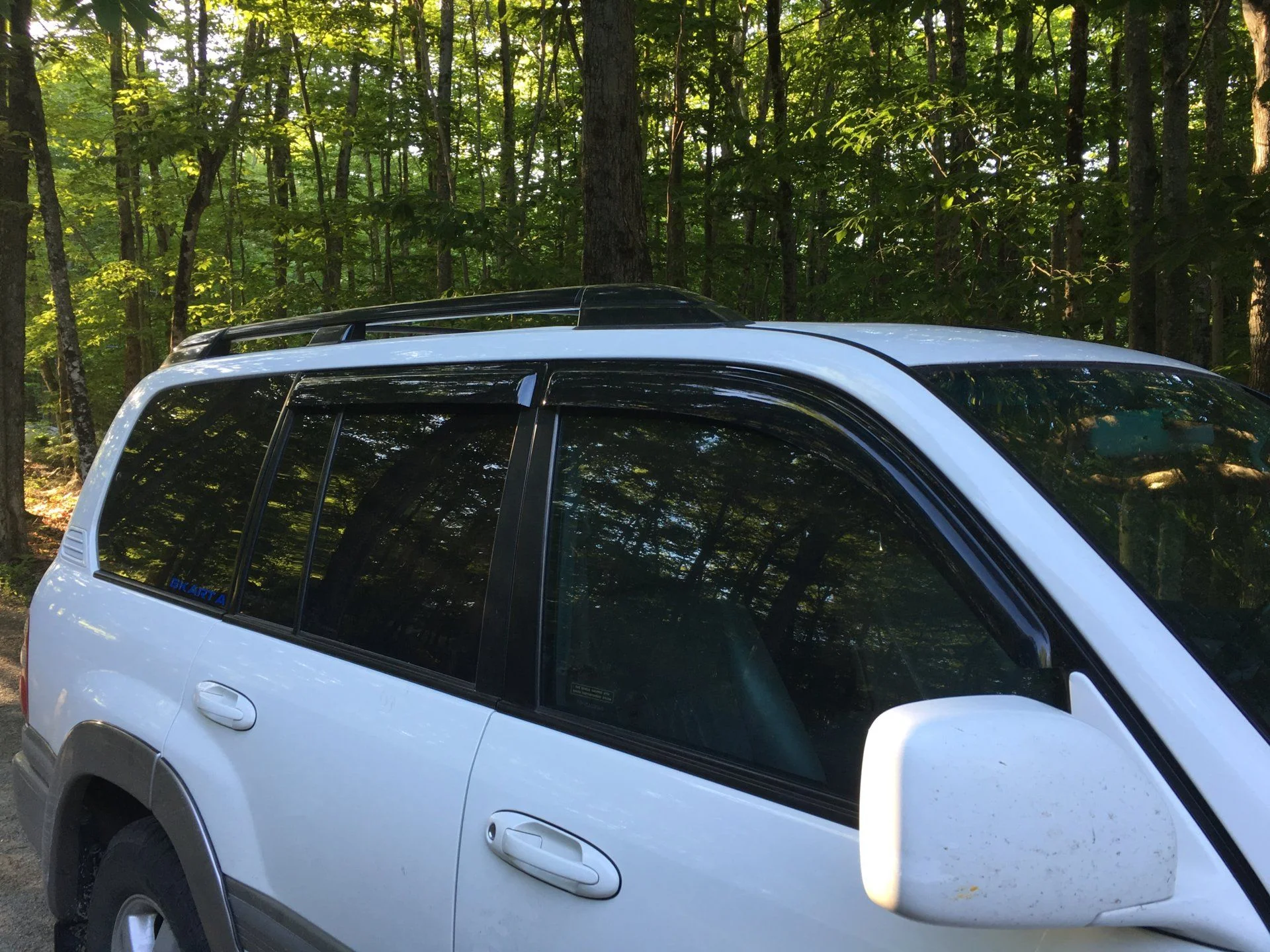

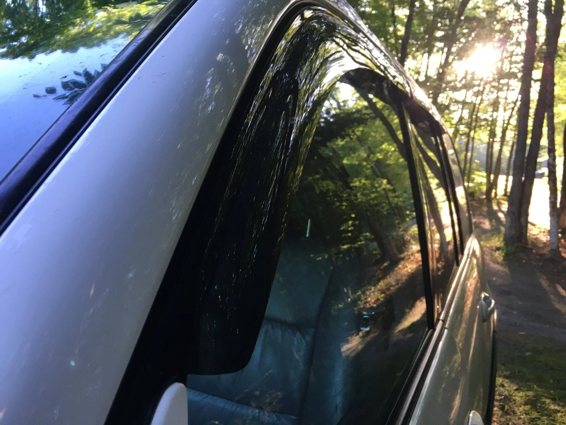

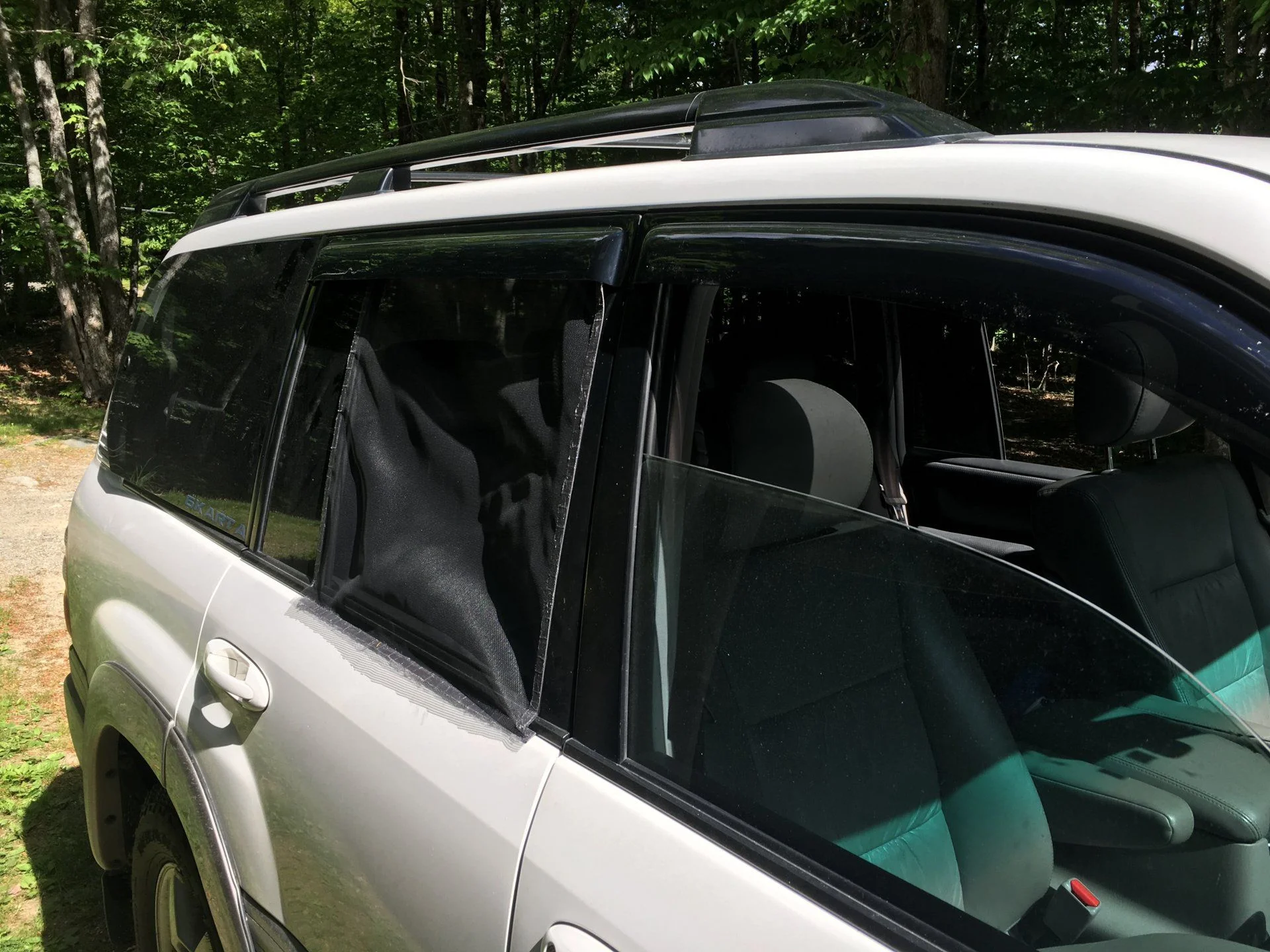

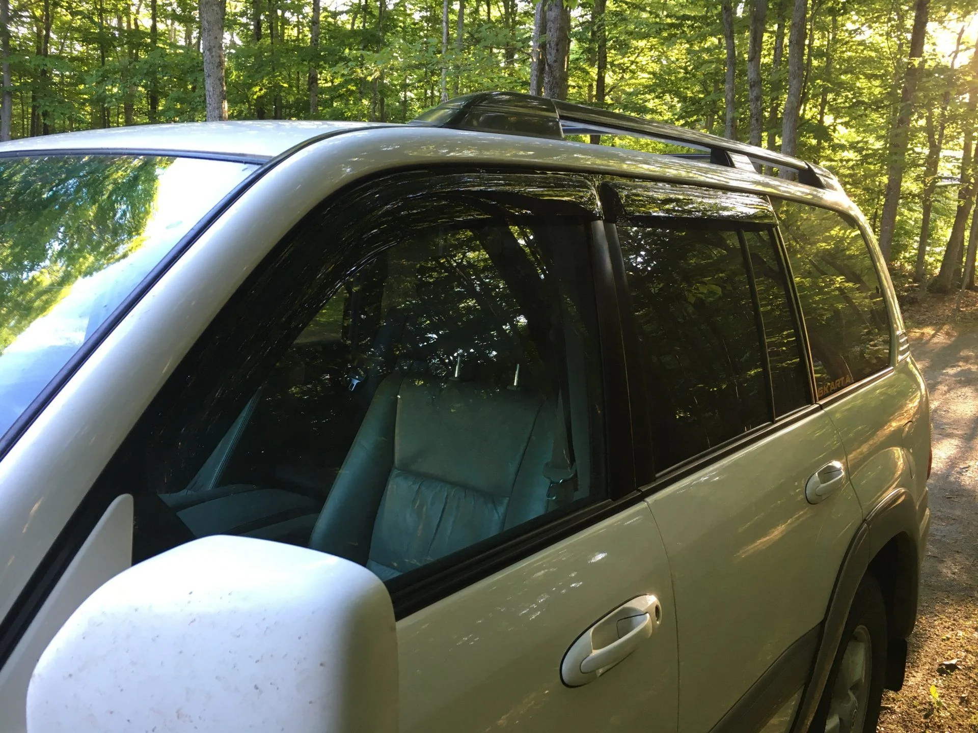

My main reason for giving them another shot is so I can crack the windows while car camping, so there is a purpose other than looks. I’m actually quite pleased with these. They do not have the extra sharp edge and double bevel that my previous AVS ones had which is nice. I’m also glad that they go the full length of the rear door, not just over the movable window portion. I did have to trim off the front edge a bit as it wasn’t lining up with the mirror support. Otherwise they are great and still allow use of my screens.
Do the front windows roll up all the way on their own with these, unlike the weathertech ones where you have to hold the "up" button all the way?
Yes. These are the "stick on the outside" type. They are not the in channel ones. The in channel ones look a bit better but I avoided them as that is a common problem with most of that design. I wan't sure if I would be happy with them or not so I didn't want to spend a bunch of money on them. I'm actually very happy with them so far, especially considering that they were less than $25 shipped. Trimming them was super easy and a nice single cut file smoothed the freshly cut edge down to look like the rest.

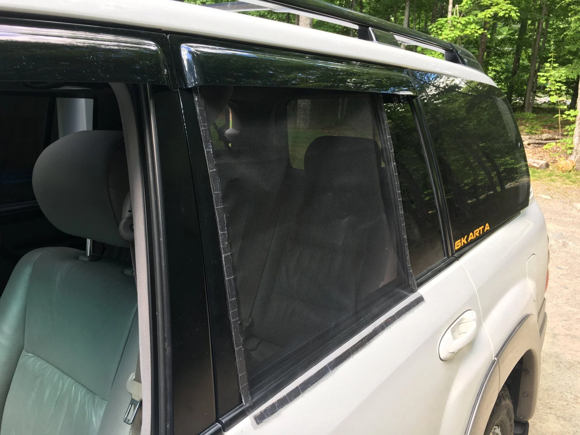

It's another DIY mod with everything coming from HD. Unless you go fancy, you should be into the screens for well under $30. Word of caution: I had some 3/4" magnetic strips left over from another project that I used for some of it. They do hold better but I have to be careful when removing those portions as the magnet is stronger than the adhesive/RTV ability to keep it together allowing the screen to pull away from the magnet.
2 rolls of 1/2" x 10' self sticking magnet
1 roll of fiberglass screen
1 tube of RTV
1) lay out the magnetic strip on the black window trim and cut accordingly.
2) cut a piece of screen a little larger than the window.
3) remove adhesive backing from magnetic strip
4) apply screen to magnetic strips
5) smear RTV over magnetic strips to help glue the screen to the strips
6) let set overnight to allow the RTV to cure or have a couple beverages and watch RTV cure, your call
7) pull the screens and magnetic strips off as a unit
8) trim off excess screen
9) enjoy bug free car camping

That’s a great idea! You could permanently attach the screens to them and roll everything up when not in use. I think I’ll steal that idea if I get sick of the visors again.
