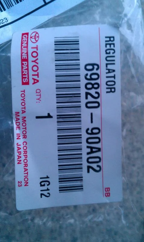

I finally got the chance to replace my window regulator couple days ago just wanted to share how easy it is to do it took about 20 min or so and got to clean all that junk accumulated inside the door and glass.i was surprised to find out that it is available new from Toyota it cost me less than $100 at my cost,here is a few pics of the install.

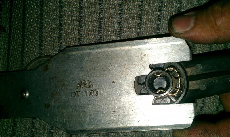

you can see how worn the teeth are compared to the new one.:)

:cheers:here is the tool to remove the hand crank you can also use a rag to release it.door panel back.:cool:

When you need to remove the handle, a bicycle spoke with the head cut off works great also.
Great write up!
Careful with the rag (fsm) method, I broke my handle. :/
