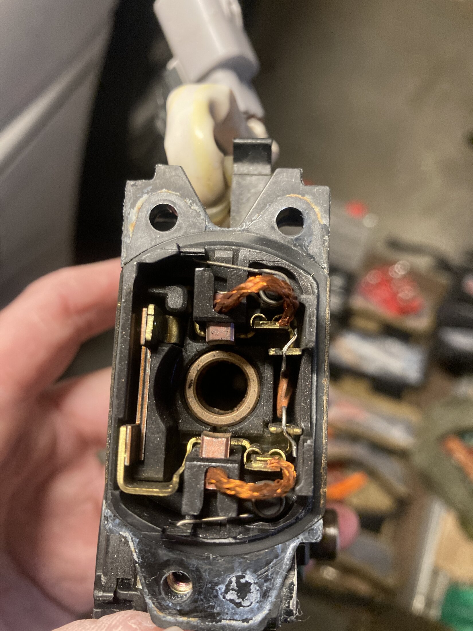

Disappointed I pulled everything apart again and this time I dissembled the motor (only three screws) and cleaned it well with electronic parts cleaner. lightly greased the internal motor shaft and wow the window is now my fastest and quietest.
I was also happy to see the brushes are replaceable without need to solder them! On a rainy day ill look for replacement brushes to have on hand for 100k miles down the road.
