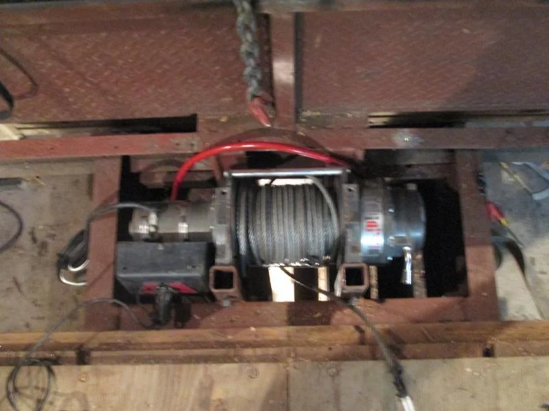

I am currently installing a warn winch behind the cab of my F350. It sits just below the deck of the flatbed, and will be used primarily to winch dead vehicles up onto my tilt bed equipment trailer, using a short removeable boom on the back of the truck. I don't know a lot about the winch, it came in a trade. It has had little to no use on what was basically a 'show truck'. It is large, like a 10-12,000 lb unit. I understand built about early 2000's. As I have it mounted it spools from the bottom of the reel to wind in. I have been trying to set up a roller to get the cable above the deck, leading to the boom, but recently realized that if I re-wind the cable and call 'reverse' 'forward', I could have the cable spooling over the top of the reel. All I need to do is re-lable the controller on the cable. Is this practical? Is there a physical difference between the spool-in and spool out gearing or mechanism? There is a sticker on the drum showing which way the drum rotates to spool in. Is it all in the way it's labled? Thanks in advance.

If you flip it end to end so that the motor is on the other side from its normal orientation it can spool from the top and the brake will work. Spooling from the top also puts more stress on the mounting feet as mentioned above.
The motor is on the right as mounted. Also, there are 4 bolts on the mounting face and two on the bottom. The 4 on the vertical face are against the square tube frame, so the bolts aren't in tension. If I spool off the bottom, the forces will tend to lift the winch and the 4 face bolts will be in shear. Everything in the mount is interlocked with each other before welding and the square tubes have pipe spacers inside so they dont crush. To turn the winch around would be tough and also I wouldn't be able to reach the bolts to mount it. That's why I did what I did. I need it low and flush because this truck hauls large beams, all manner of woods, cabinets and slings of plywood for my 'day job'. Thinking I'll spool off the bottom, lead up to a block and then lead aft to my short boom. I could also connect a snatch block to the fwd end of a long boom. I know, it's confusing. I need the conversion parts to be light and handy so I can take off on a weekend and haul home another vehicle with little fuss, and not raise the suspiscion of my better half....:rolleyes:

Wow, Pinhead, I just realized what you meant! The Warn emblem on the control box had me fooled into thinking that was the top. Now I see the same mounting holes exist if i flipped it over. I was thinking you meant around to where the 8 face mounting holes would be towards the cab. I'll have to elomgate the hatch in the deck, but it should work fine. As a bonus, the clutch handle will be on top where I can reach it! :doh: Thanks!
