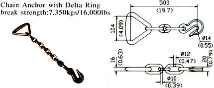

I have a winch and have used it countless times but, honestly, I have no idea what the short four foot chain, with the triangle on one end and a hook on the other, is used for.
Is it called a drag chain? If so is it meant to drag the winch line out from the winch spool?
Can someone enlighten me please?
You mean this: Taken from CCOT:
# Chain - Delta Tow Strap ChainpadHeavy Duty 3/8" Delta Tow Strap Chain
# Attach Clevis Hook to Vehicle Frame and route Tow Stap through Delta Hook.
# Delta Ring Allows for Hard Pulls without cutting Tow Strap.
# Delta Chain & Strap has many creative applications.
# A Must for any Trail Gear Bag
# Delta Chain is rated 16,000 lbs.

I still don't quite get it.
It is in all the recovery gear bags but what "creative" uses are there? There is already a hook on the winch line. You use the snatch strap for vehicle-to-vehicle pulls. When do you need it when nothing else would just as safely work? Is it like a recovery point - a place to attach a snatch strap? I'm confused. :confused:

yes, you could use it to tie around the frame and then connect the strap or winch line to it. You don't want to do just a loop with the winch line around the frame cuz you'll damage the wire rope. IOW, yes it could be used as an improvised recovery point. Not a great idea of course.
I am yet to personally use mine but my understanding, on a vehicle without a suitable recovery point you could attach this to the frame and run your tow strap through the triangle part. Rather than wrap your strap directly around the vehicles frame. Possibly cutting it?

I have two clevis type hooks attached to each other with a very short length of chain just for those vehicles w/o a solid recovery point.
G'day, "drag chains" are meant to drag logs and trees (mainly), off the track after storms/ winds etc. Saves your fragile straps from being dragged on the ground and damaged.
