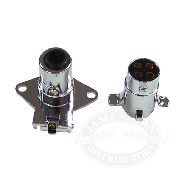

get a 4 prong small trailer plug and put it in the winch and on the plug . its what i did , i think its a better set up since you can get parts at a gas station if need be and it cheap / built for the elements .

I'm not a purist. For my winch I used a 4 prong metal trailer plug and socket. Open easily and readily available.
I didn't have anything to begin with... Made the remote and wired the socket to the winch.
Nothing wrong with using a 4-prong trailer plug on an 8274 - 30 years ago Warn was using them as a factory installed part.
