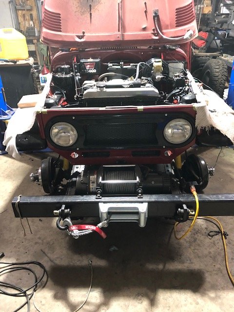

I have a Warn 15K winch on my FJ40 and the negative goes from the battery to the engine and then to the frame rail where the winch is mounted, my winch controller in mounted under the hood up high to avoid water issues on the relays. I have remote control and dashboard switch control for the winch. The setup works great, never had a problem. This is an old picture of the retro being done.

Also make sure the area you bolt to is bare metal so you make a good connection and use some penetrox anti oxidation grease on it too. What size cable did they give with the winch ? In the picture you can see my controller on the firewall left of center past the battery.
its all 2 gauge. The ground and power cables will be small in length so should not have a need to go bigger. I’ll definitely get some penetrox as well.
