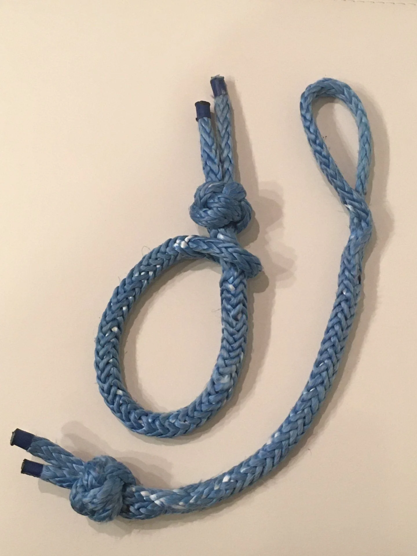

And by the way, I'm not sure how you could cut that Amsteel/Dyneema/whatever stuff out on the trail if one needed to make a splice - I'm having the hardest time with scissors. In the comfort of my garage, I'm using masking tape and a hot knife. Here are my tries at a soft shackle, and a hook strap:
...and before anyone gets nervous (this is Mud, after all...), I have several regular D-ring shackles in the truck, as well as a soft shackle from 1/2" line made by the professionals @ SoutheastOverland.

Learn to tie the button knot for a soft shackle, they look impossible at first but stay the course and you will get it.
This is a good vid for button knot...
check out this vid, easy way to splice dyneema winch rope...

The knot in my practice shackle is, according to Yachting Monthly ), a diamond knot.
I'll try the one you've linked, thanks.

FYI, I checked today, the soft shackle I've got from Southeast Overland uses the diamond knot method.
yes, but the button knot is superior to the diamond knot, almost double the strength!
Other manufactures use the button knot because of this.....
I've gotten the button knob to work, even once from memory. I'm still struggling to get both legs of the shackle to be the same length. I have some more practice rope, but I'll be wearing gloves from now on to work with this stuff; enough blue dye on my hands.
