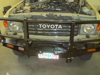

One last thing. I was looking at the ARB on your FJ60. You know the 8274 won't fit that right? You can make it fit, of course, but it will involve some fabrication work. If it's the standard FJ60-62 bar, it was made to fit the M10000. It fits other winches that share the same basic footprint(one of the 9500s fits right in with no modification), and will fit an M12000 with just a bit of grinding. Also an M8000 will fit on the bar, but you'll need to space it out just a bit with a small stack of washers under each mounting bolt between the winch and the bumper.
Cruiserdrew, If you look at the bullbar, the light tabs are outside of the middle section. The one I modified to fit my M8274 had the tabs in the center. There are two bullbars made for the 60-series. One has the mounting tabs outside the center section and the front mounting holes are centered; whereas the other bullbar designed for the laydown has the light tabs in the center section and the mounting holes are offset to the passenger side. The newest 60-series bullbar is a one bullbar fits both the laydown and upright (M8274) winches.
Yes it's a 8274 bull bar. Number ends in "30". Kurt and I got it down before he ordered it for me. talked to arb too. this bar should fit the 8274 and the XD9000 and MD8000 as a bolt in.. No big deal if the 8274 won't fit..I'm not totally hung up on that winch, just like the retro look.
