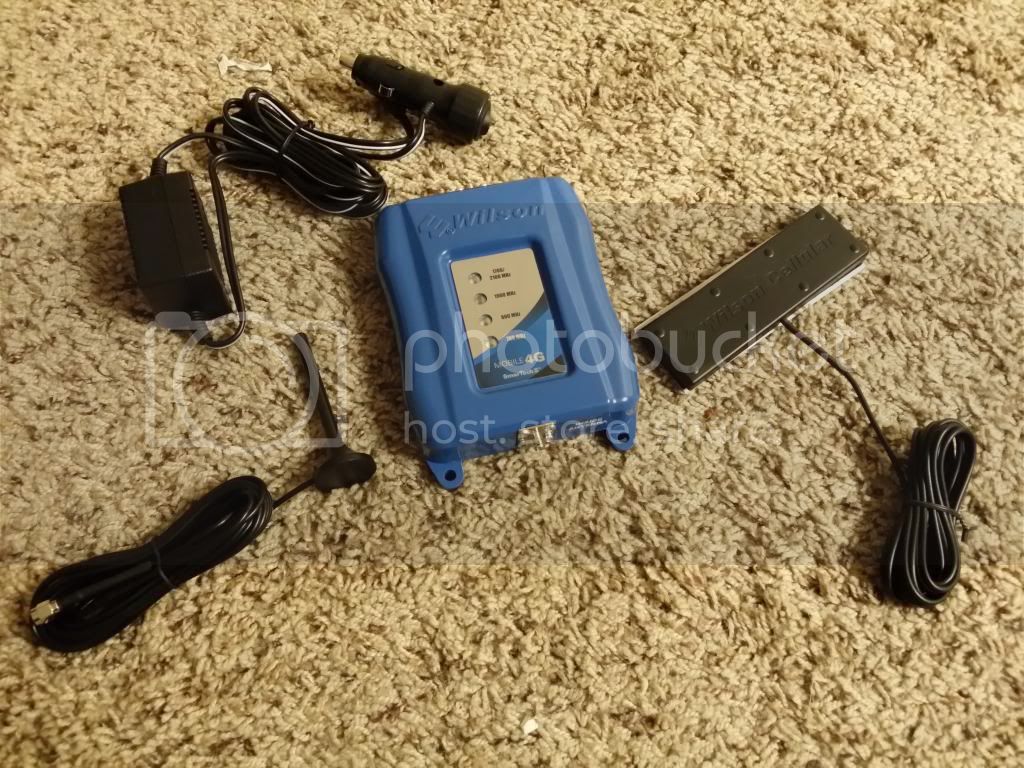

The Model is 460108. This is new for 2014 and is certified to new regulations by the FCC. The booster is not supposed to cause the same headaches to carriers ( and end users) that previous boosters could. It is also carrier agnostic. So it doesn't matter what carrier you're on. At least in the US. However you do need to register it with the network before use. This is because they actively communicate with the network infrastructure in order to ensure reliability and prevent harm to local infrastructure. Another pretty handy thing is that it supports voice, 2G, 3G, and both "standard" LTE as well as AWS (XLTE for Verizon customers).

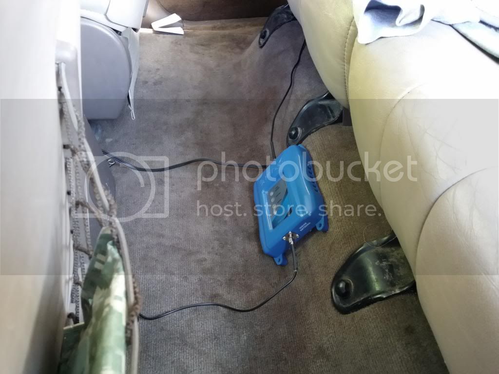

The setup is pretty simple. It has an indoor antenna, outdoor antenna, power cord, and the booster itself. The power cord just plugs into the cigarette lighter and has a handy on/off switch. So you can turn it off if not needed without having to unplug it.

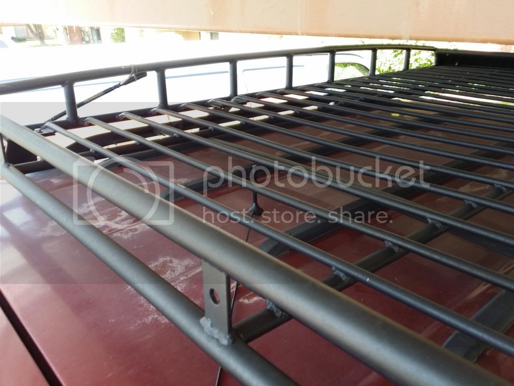

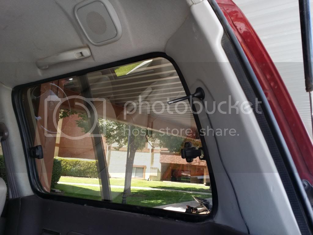

There is plenty enough coax line to have the booster on the back floor area and tuck the cable away in the PS interior plastic panels and set the (strong magnet) antenna about 1/3rd of the way up the roof. It also is short enough to not protrude over the bars for the Baja Rack. A plus since I don't have to worry about it breaking if I need to throw something up there.
When not in use I just keep the external antenna cabling run and have it where the 3rd row buckle used to be.

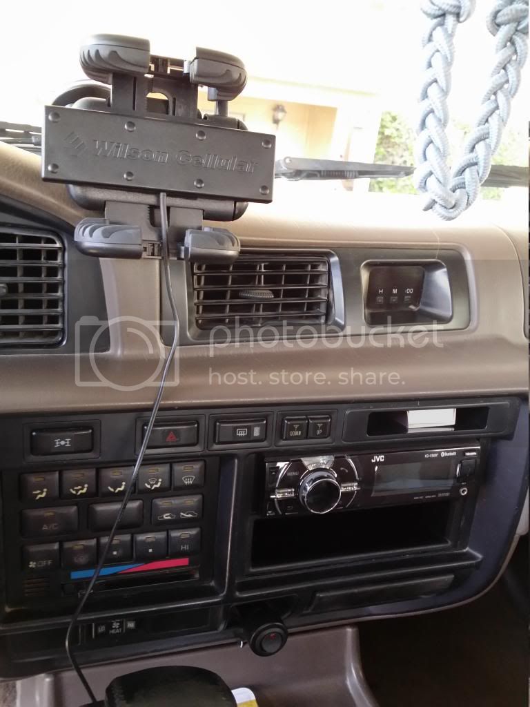

The internal antenna is a little candy bar unit. It doesn't really have the best range. Though it can't be too powerful as it would cause issues if the external picked up its signal. Typically I get a few feet of range on it. Normally I have it like shown below since I can then use blue tooth for calls and then have my Note 3 run as a hot spot for data. So that extends the use.
I typically keep the internal antenna and the booster itself locked in the glove box when not in use since I would rather not have it come up missing and have to drop another 300 on a replacement. When in use I have it like this:
I like the idea of being able to see the status LEDs so that's why it's not just tossed under the seat or something. Though I may try some other mounting options in the future.

You'll likely find that if you move the external antenna, your range will increase significantly. The roof rack is creating a faraday cage which is limiting its range.
I removed the rack all together and tested. Didn't notice a difference from my random testing. I am building up a little mount to connect to the rack to raise it up and still give the required ground plane to work well. I imagine when I start getting to the far reaches of available service it could help.
