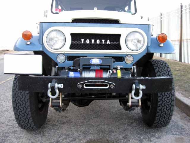

ps pump went hte day after I picked up my new winch and subwoofer . so new ps pump has been installed the winch got fit in as well as the stereo finished up.
i was trying to get it all done before i leave tonight for 3 weeks TAD to Hawaii, and won't have time when I get back. while I am gone the lv is going to foxfab to get some sliders.
i keep getting hte wiring more and more straightened out. my goal is to make it look like cruiser nerd's wiring :D
well here are some super poser shots of the new winch installed. the amsteel blue winch line had not shown up yet in the mail so the wire cabel is still in there. but that will get changed out when I get back.

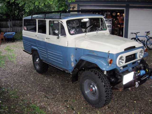

i should prolly wait to post the pics of the roof rack because I tool them last night at dusk and they are not as bright and cheery as my last set of pics but my water pump died and the lv is in the grage until I get it swapped out. so it would be either ethese pics or no pics for a bit.
been working on this and that. found that one of my U joints in my steering shaft linkages was causing my odd steering issues. fixed that and decided to drag the rack out from behind the garage. my plan was to cut the top basket part off of the 6 footed full rain gutter mounted rack. that came tothe states on one of Jslatic's fj40" i believe "the great Pumkin" crew cab was its ride.
anyway so my idea is this to cut the basket off then rework half of it so as to have it be removable and put back on when treking but for every day use it would jujst be a platform. I had a full cage rack on my fj62 and there was never an instance where the cage part was helpful in day to day life ie the home depot runs. also with it set up as a platform I can utilize my rtt and add the removeable basket section so as to fit the rtt. clear as mud right.
so I cut hte basket part off flapper wheeled it all smooth painted it up and got it up on the roof .... only to find the front feet matched up but the lv gutter lines do not widen like the fj40 tops do so feet 2 and 3 heading aft were both 4" too wide. so I got hte rack down and took 2" off each side and welded in a 6" x3/4" on the inside of the tube, extenstion to sleeve it. got it all together painted and put the same grey fj60 trim moldingchannel lock stuff I used on the tail gate lip on the full rain gutter foot and bolted it on. I am pleased and think I am done adding things on to the lv. . . . well since the rack is not a full lenght rack (which I am happy about) I plan to make a 4 foot rack for the back that would have 5 jerry cans mounted it it. I will doucment the build of that alittle better than I did this rack.
