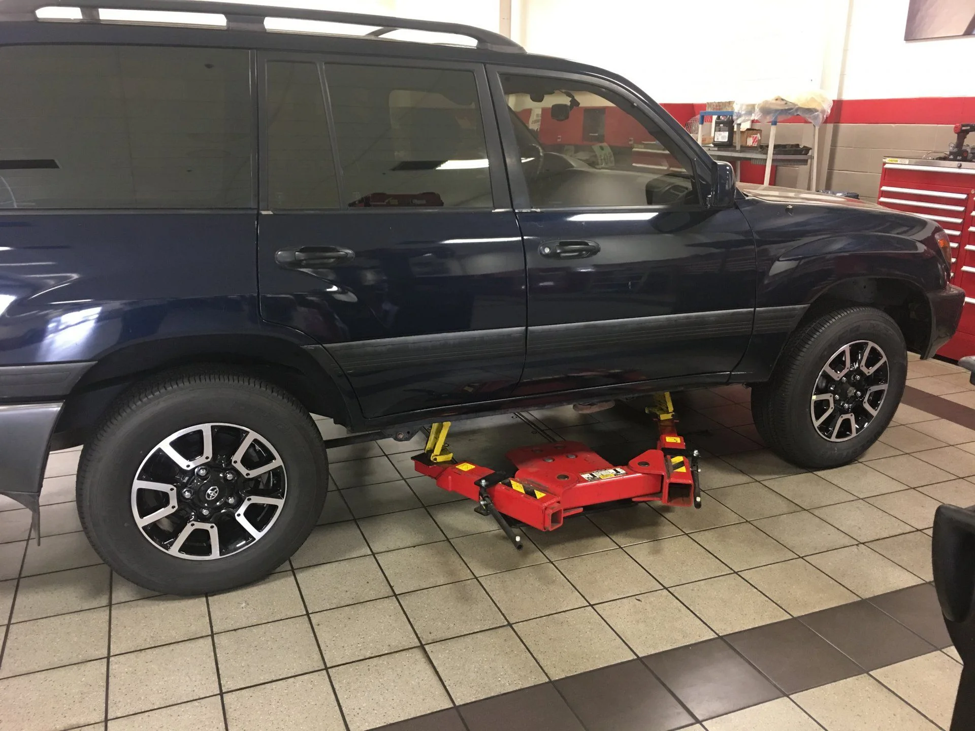

Yep they will. Just bought a set of take offs at the dealership I work at. Only issue is the front center cap will need some modifications because of the dust cover.
They should come with the center caps. Looks like they are there in the picture. The tech that installed mine took the cover off and hammered it so it was a little more flat. That made it to where it almost cleared. I still need to take a dremel and remove a little of the plastic though. They fit but they are not secured all the way around. Once I do that they should be good to go.

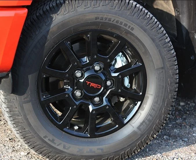

If they don't come with the center caps and you want to be a little different you could order the TRD Pro caps
