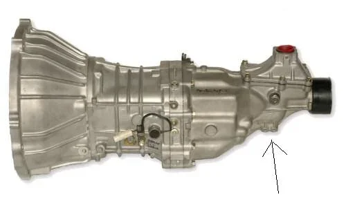

what would happen if i tore it apart here?
edit:untitled 2.webp
and back here there are just two bolts on each side, right?
Yes, there are 4 bolts that hold it to the trans to the trans mount and 4 more that hold the mount on the cross member. If you take it apart in the middle, it would be messy and I guess take some weight off.... but at some point you'll need to get the input shaft and bell housing off..... I say get a strap and put some tension on the trans, then get a BFH and go to work around the bell housing. Maybe use a block so you don't break it... But it's yours, so do what feels good..... :D If you're 128% sure all the bolts are out, then my guess is the clutch disk is rusted to the input shaft, or the pilot bearing is seized to the end of the input shaft. Either way is not going to be fun to get out.... Try the strap and hammer first....
edit:View attachment 206219
It's guts would fall out!, seriously you'd contaminate everything, dont do that!
What will that accomplish? you'd still have to get the BH bolts, and if it would come apart (I dont think it will) I'd be scared it would all fall apart.
WHOA DUDE!!!(not you 2ndGen)
The 2WD's have a semi hidden 14mm bolt that comes in from the front side!!
Driver side just above the block to tranny stiffener thingy.
And get the exhaust clamp off the 17 and 12
