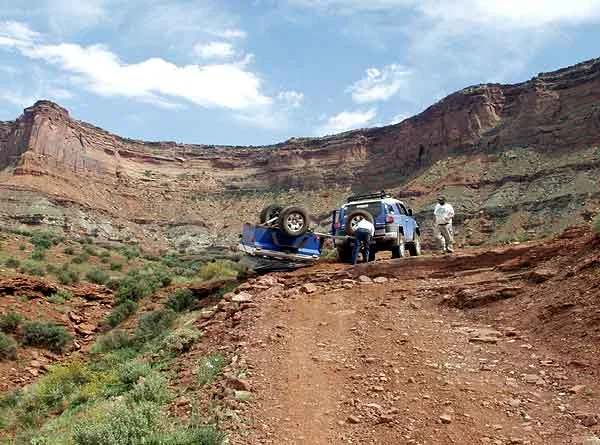

Huh! I saw a pic of a similar trailer tipped over behind a rig similar to yours...can't remember the thread. Well, I'm glad it wasn't you!
Good to hear it's worked flawlessly for you. I couldn't sleep last night...too many trailer threads running through my head. You guys have given me the sickness! I was thinking that the fenders sticking out the way they do on most of these seem like real hang up points. Do you see that as a problem? What about ''Sliders'' to guide the trailer through trees and obstacles without getting hung on the fenders?
:confused:
attachment.php
Don't know how you'd confuse a blue FJ Cruiser and black FZJ80.
Yeah, yeah, sorry. I spend too much time on mud and everything seems to run together. It's part of the addiction...after a while you start hallucinating. Thanks for clearing it up!
