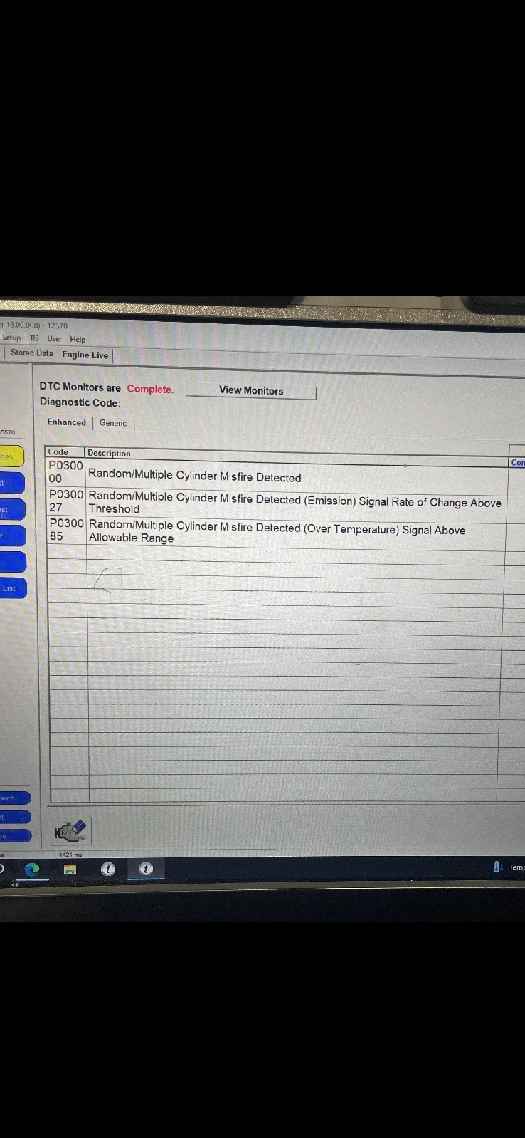

Waiting on the codes but just hung up with the dealer. There were a multitude of events: a combination of 20% fuel in the tank, sustained 100 MPH, and what the dealership is calling low-grade fuel (my Wife calls bull**** on this one, stopped at Hruska's on 71) caused the vehicle to slow down to protect itself.
They stressed that the vehicle never actually came to a stop, but slowed down.
@CJF Not sure, must have been hot. It was 67 outside yesterday. The prognosis is the heat from the engine caused the fuel, which circulates back into the tank, combined with the fuel quality, to allow the fuel temperature to rise and become insufficient for the horsepower requested. If the fuel quantity was greater OR the fuel quality higher, this would not have happened.
Dealer did not test the fuel, but it is their opinion that since the engine was detonating the fuel is to blame.
They basically said my 4,600 hour multi-commercial IFR rated pilot wife who has been to five Jeep Jamborees in her old YJ and also owns a 7spd manual Carrera with 97,000 miles pumped the wrong gas and drives too fast. Car is not built for this scenario.
P0300-00 Misfire
P0300-27 Emission Misfire
P0300-85 Overtemp Misfire

Waiting on the codes but just hung up with the dealer. There were a multitude of events: a combination of 20% fuel in the tank, sustained 100 MPH, and what the dealership is calling low-grade fuel (my Wife calls bulls*** on this one, stopped at Hruska's on 71) caused the vehicle to slow down to protect itself.
