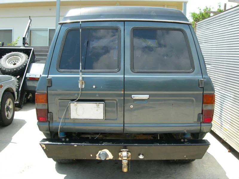

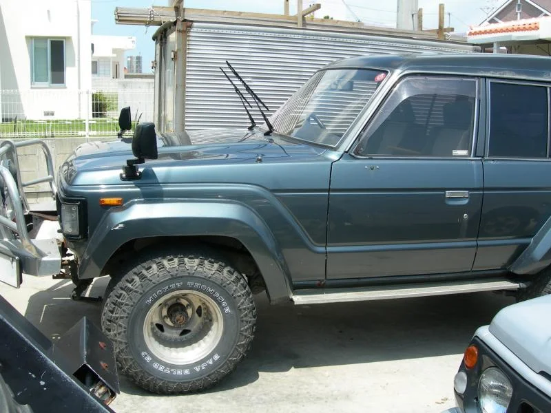

Well I jumped in with both feet this week and I will get back to that after a little back ground. I bought my rig in Oct of 2009 while living in Okinawa, the location of Okinawa as opposed to just saying Japan is significant as will be evident in the price breakdown. When I bought her, I knew the brand Toyota Land cruiser but have never driven one and didn’t know a whole lot about them. I had purchased a boat and needed a vehicle to tow the boat with. In my search for a tow vehicle I came across a 70 series diesel rig at a used car dealer, and after sending an inquiry down the grapevine got word back from the PO not to buy it. Well my appetite had already been whetted for a cruiser and I came across my HJ-61 mostly by accident and had no idea what I was getting my hands on at the time. In mid 2010 after a lot of research and learning that she could not come back with me,
I moved from Japan to Virginia and put Allis in a storage lot and gave a buddy of mine a power of attorney to sell her. I also posted her for sale here on MUD. Over the two and half years that she set there in the sun, rain and salt air I was contacted only two times with interested buyers offering $1,000. As you all know sentimental value is worth more than $1,000. About a year out I contacted a shipping company to get information and try to herd my ducks into a row. In Nov of 2012 she turned 25, according to the title. The company I used "Batfa Japan Inc." http://www.batfa.com charged me 353,000 yen or $4,346.10. the price breakdown is below:

After that it was off to the truck. She started on her trip with 2 spares in the truck, 33x14.5x15’s both now gone. She wouldn’t start and needed a jump; I was pleased to see that they had a 24volt jump box. Then it was back to the port office to sign for receipt of the vehicle.
Second thing that I found missing I didn’t notice until I was at the gas station, the tow hook right off the back of the truck. Who ever took it really wanted it as it was bolted through the bumper to an extension that was bolted to the frame. So I get to the gas station and was not sure about shutting her off after all I just needed a jump and it had only been 20 minutes. I bit the bullet and shut her off, no good. After 2 new batteries she started right up and I felt safe to turn on the radio. Radio was still there but the 24v-12v step-down converter that was mounted under the passenger seat was not.
New Batteries, full of Diesel, cell phone charged half way, wife leading the way 120 miles back home. She fits though the garage door with 2 inches of clearance. On the way home I noticed a couple if items that won’t pass state inspection. Item number 1 Windshield wipers don’t work. Item number 2 lights don’t work. OK they work, all the side markers and such come on. The high beams come one just not the low beams.
On Thursday I got two hours to go to the garage to take a look at the wiper issue. I open the hood and immediately see the problem. The part of the fire wall that the wiper motor grounds to is completely rusted out. I pull the ground to actual metal and she runs. Rust is not a good ground. I removed the hood so I can get a good look at things and see where the cut and weld needs to take place.
Saturday evening I got 4 hours to go out and stripped the whole interior. I pulled out the seats, all of the handles, and center console.
Sunday afternoon I took out the rear windows, windshield and didn’t break it until right at the end and pulled out the headliner. I had to take out the windows and windshield first so I could peal the edges of the headliner off that way it can be reinstalled. I removed the headliner because I have an issue with all 4 corners of the sunroof being rusted out, the rain gutters and roof along the sides of the rain gutter and a random hole in the roof. I thought it best to remove the flammable stuff before I get to cutting and welding.
That’s where she stands as of now.
