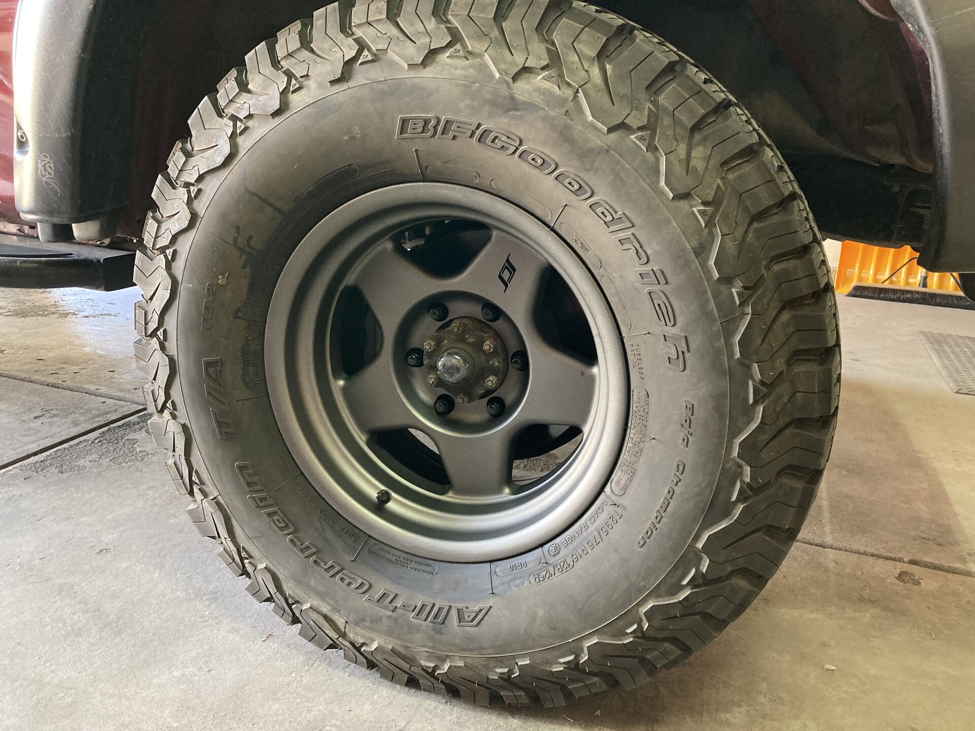

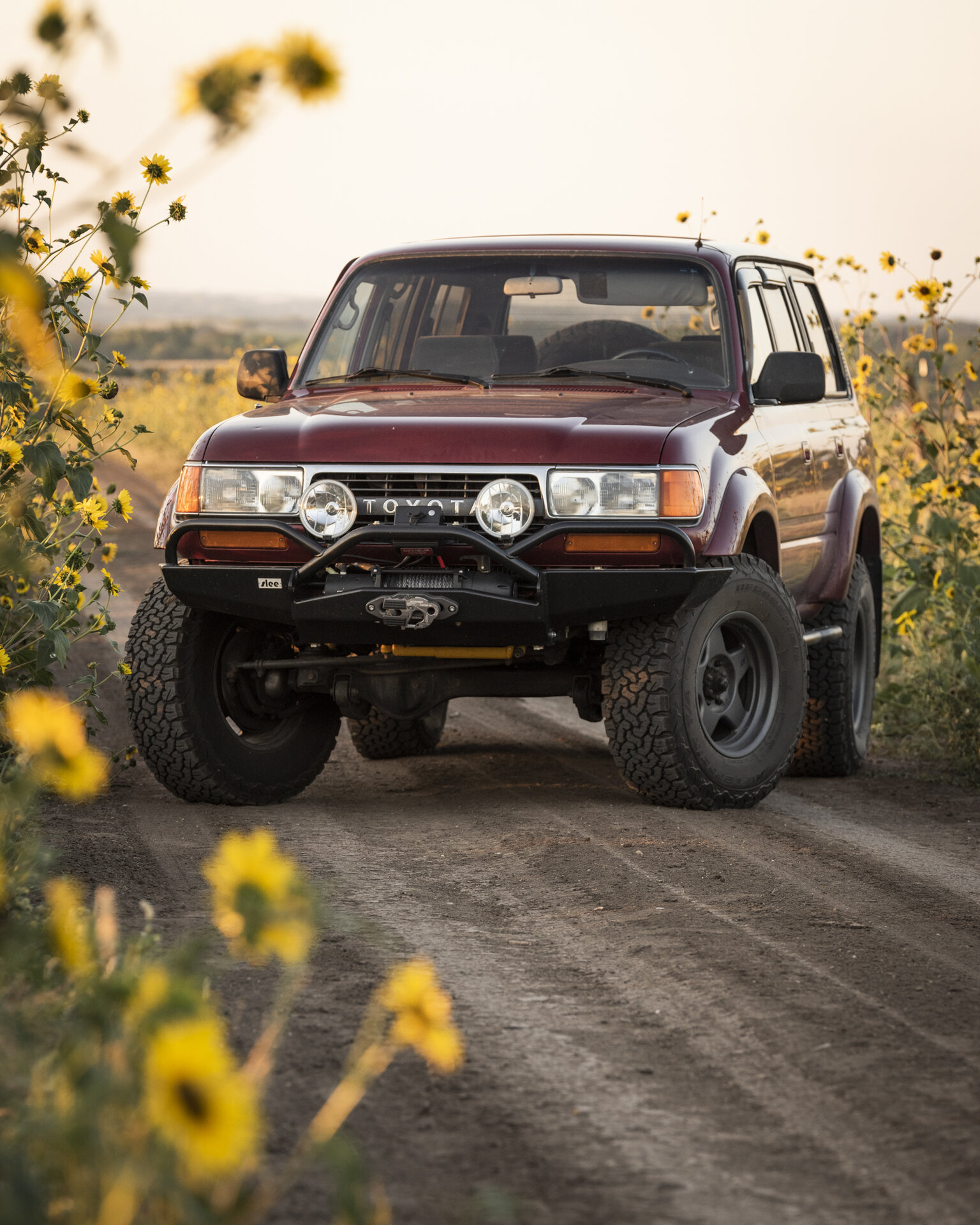

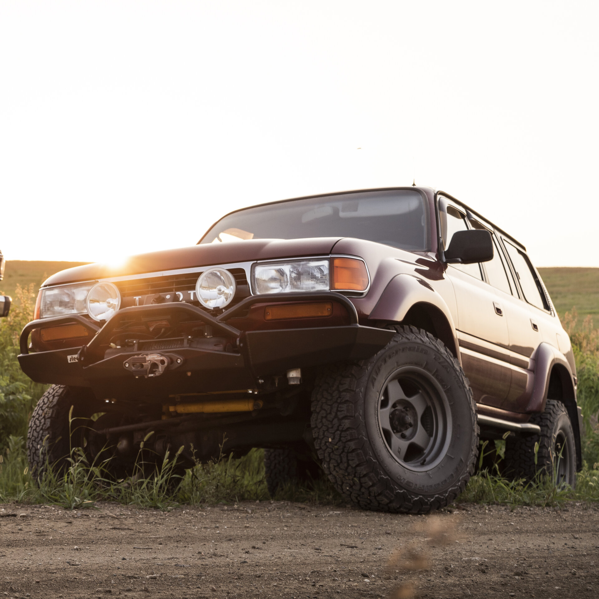

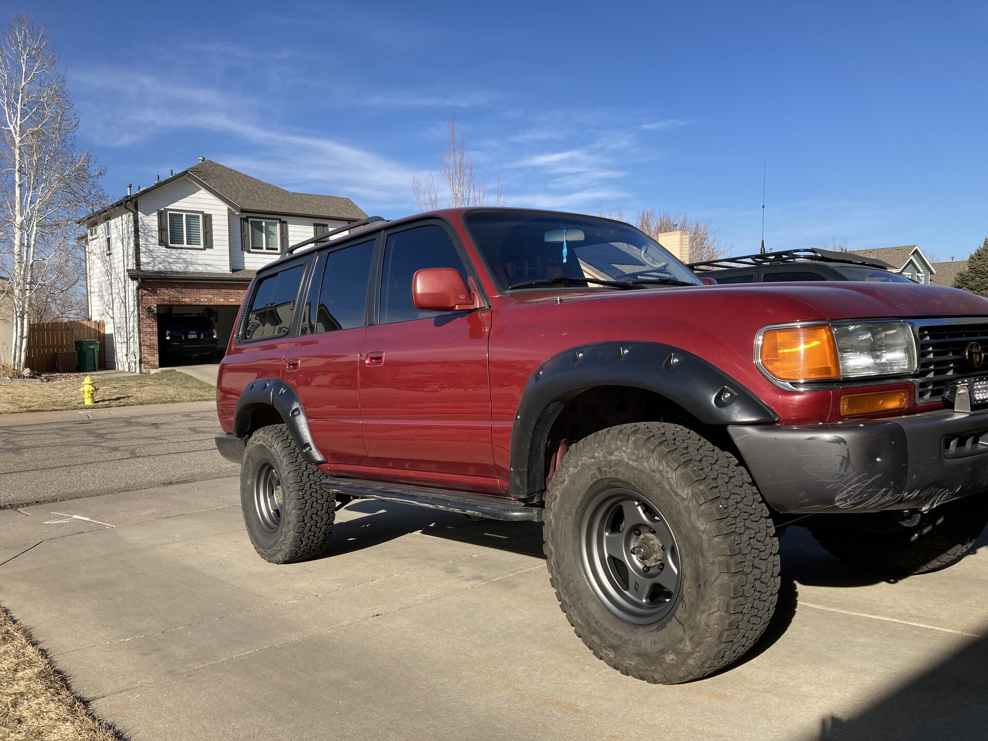

Specs on these? Color?I’m really happy with my decision to get F5’s. Here’s a couple photos from this year.
Sometimes when the sun hits them I have trouble differentiating gun metal and black. Thanks

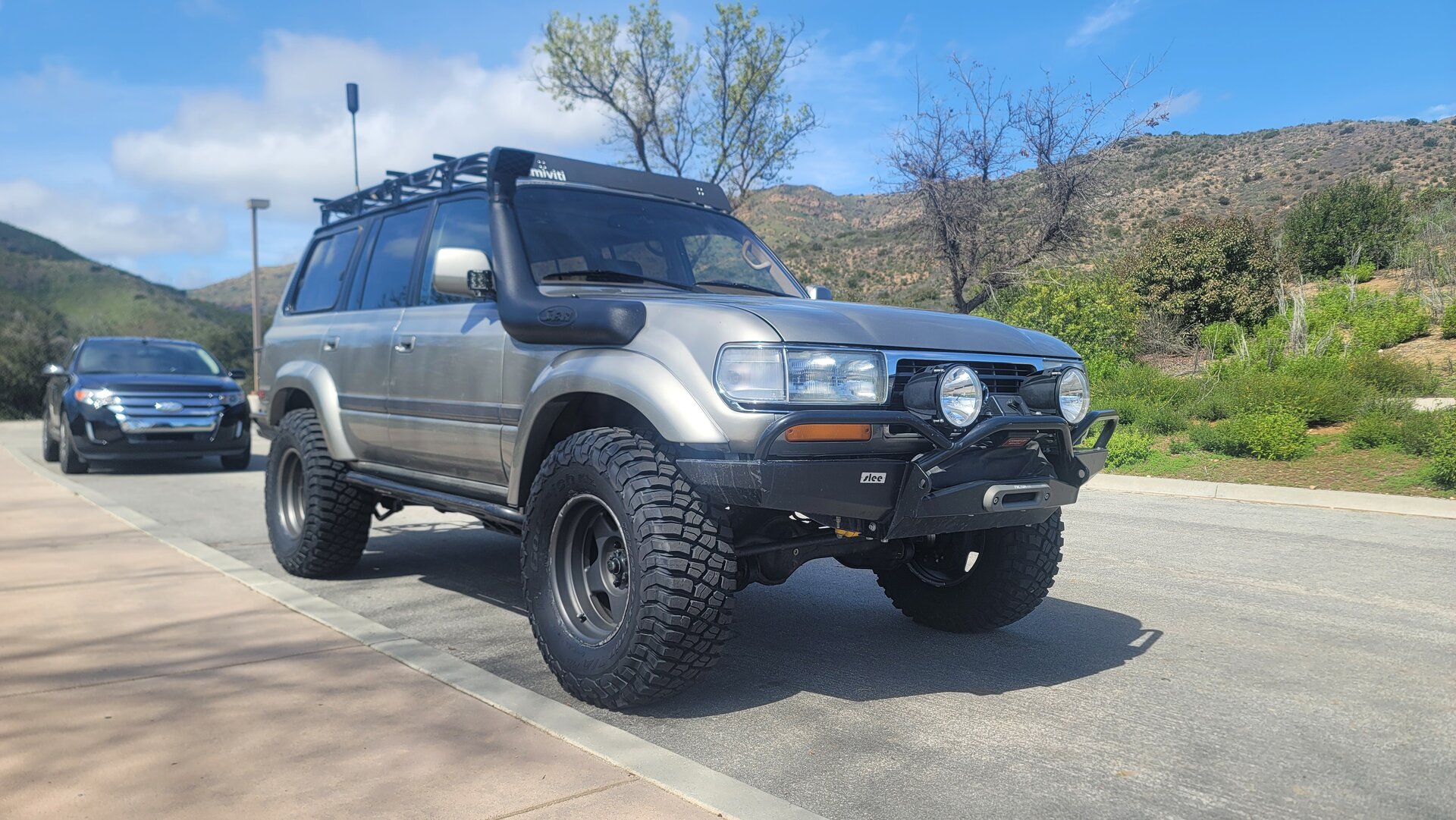

What size tires are we peepin' peeps
35x12.5x17 KM3 F5s are 3.5BS.What size we looking at?

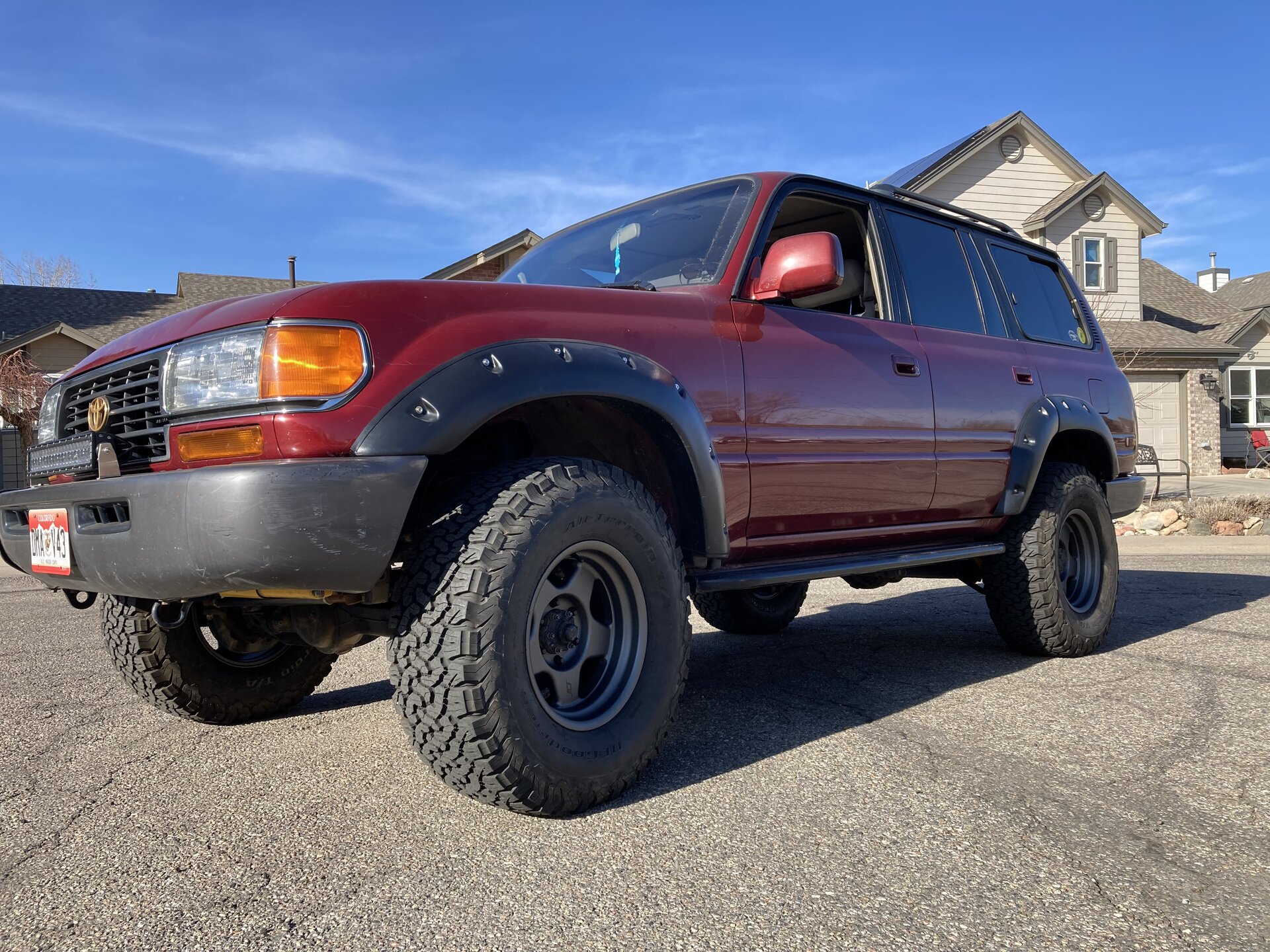

Just the OME with heavies. I'm thinking I'm going to have some rubbing off road...just got the tires the other day. I'm going to follow @COYS lead on the BP51's@NorCalFJ100 how much lift do you have? I like your rigs stance.

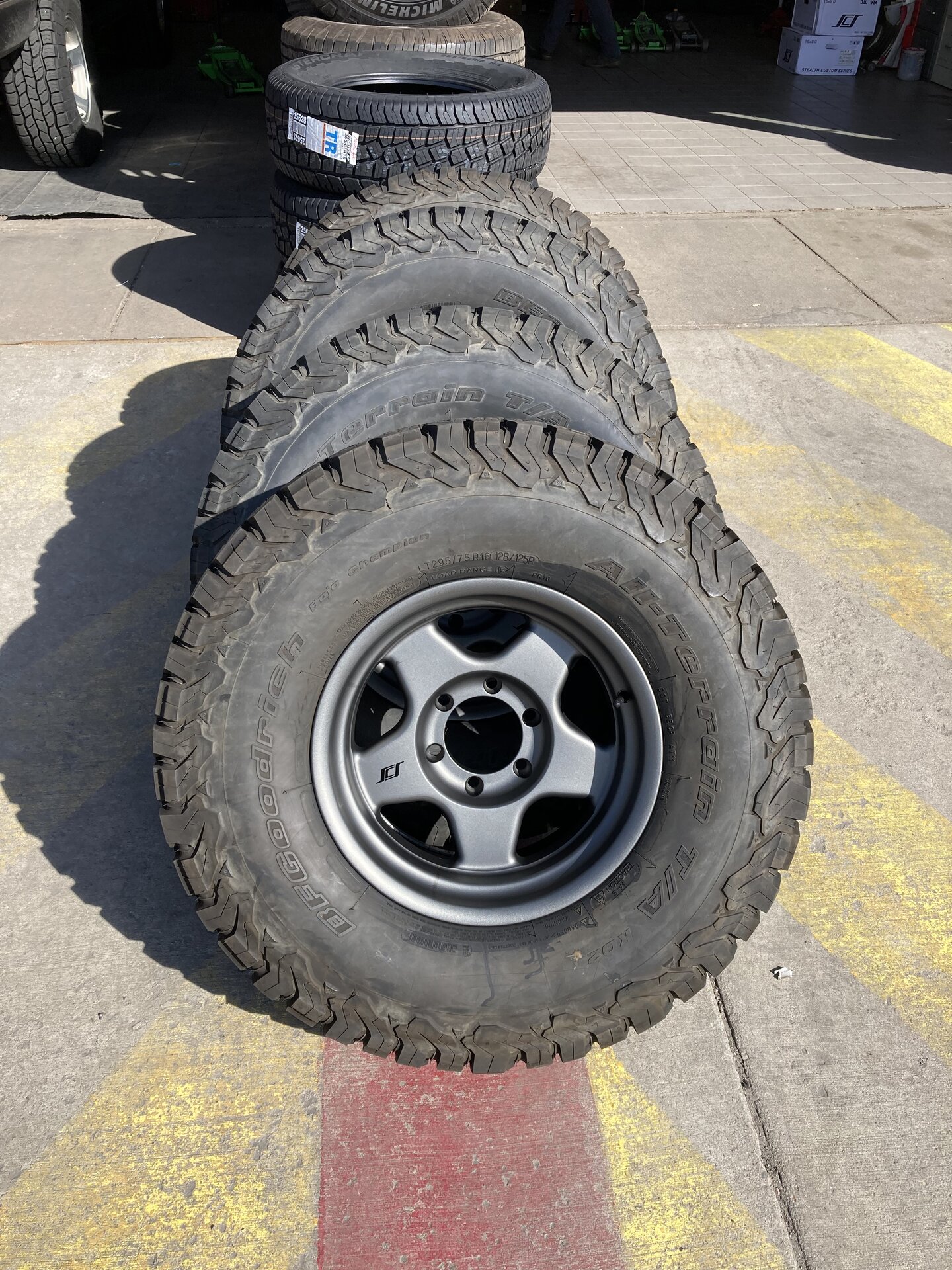

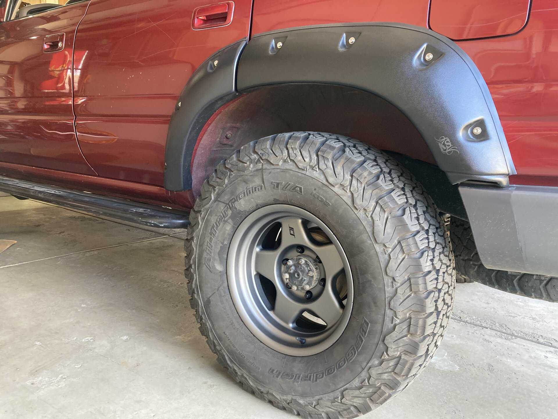

Buckaroo what lift are you running? I am getting ome 2in lift and wondering if 295/75R16 would work. Just ordered identical wheels.View attachment 3271738View attachment 3271739View attachment 3271740View attachment 3271741View attachment 3271742
16x8 -25 offset. 295/75R16 BFG AT
I’m running the OME 2 in. medium kit 851 front 860 rear. I am happy with the ride height but thinking about upgrading my nitro sport shocks. I haven’t been off road yet but I’m confident I won’t rub with this size tire.Buckaroo what lift are you running? I am getting ome 2in lift and wondering if 295/75R16 would work. Just ordered identical wheels.
Thanks for info. I will go 295 I figured the half inch over 285 would not be too big of a deal. I will add photos once they are mounted. Also are the F5s a direct fit? I know some SCS wheels need a larger center bore to fit.I’m running the OME 2 in. medium kit 851 front 860 rear. I am happy with the ride height but thinking about upgrading my nitro sport shocks. I haven’t been off road yet but I’m confident I won’t rub with this size tire.
