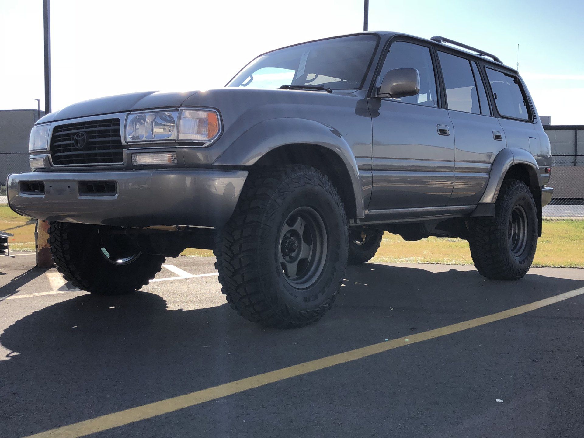

Mine are the 16 x 8's with 3.5 BS. In the early 2000's, you could get at 37" MTR for a 16" wheel. I guess times have changed. I went with the 16's since I wasn't going to go bigger than 35's on my mildly lifted 80. It still has to fit in the garage at work. Did you mean the 3.5 BS? Personally, I like the negative offset; always makes the 80 look weird to me when I put the stockers back on for the winter.

I ended up getting the 3.5 BS. Wanted to push the wheels out a little more. I can get some front end and back end pics if anyone is interested. Need to put my track bars on first.
I ended up getting the 4.5BS. Wanted to push the wheels out a little more. I can get some front end and back end pics if anyone is interested. Need to put my track bars on first.
I'd love to see some shots that show where the wheels sit in relation to the fenders, really nice truck!
They look great! I believe OEM backspacing is 4.5. 3.5 BS would put the wheels pretty much flush with the flares.
You are correct. Thanks for that. Post edited.
Yes please for the "down the side view". From this view I think I've made the correct choice getting the 3.5 bs. I get mine tomorrow, so excited!!!!

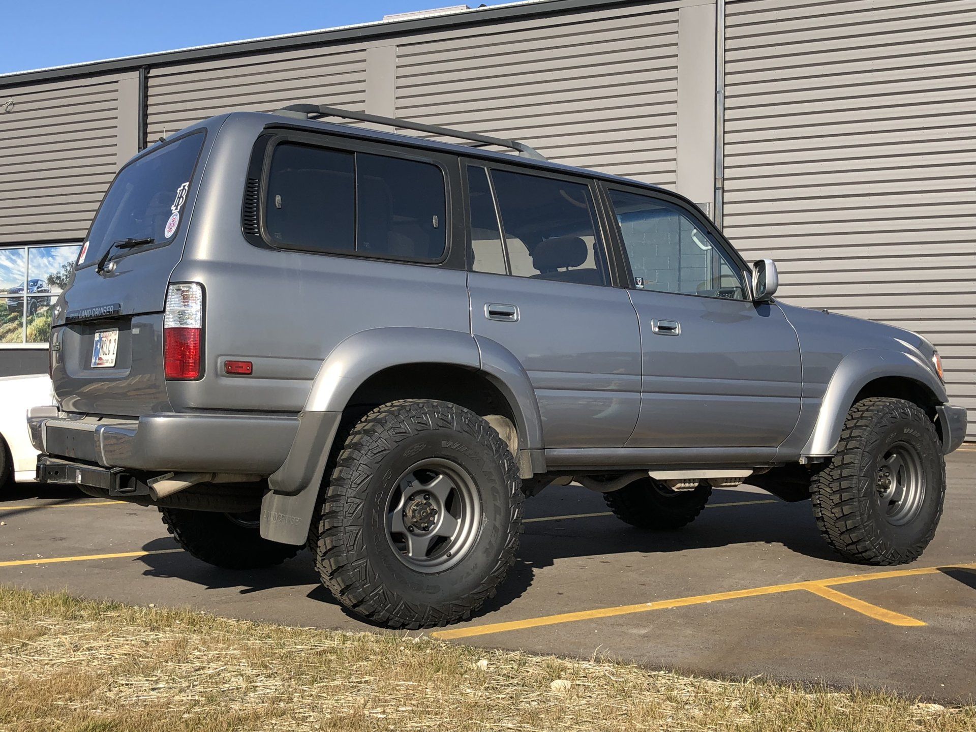

So many people posting pics that don't show where they sit in the fenders and don't say the backspacing, missing the point here, lol.
Top of post 12.
16's, 3.5
Top of post 12.
16's, 3.5
Great shot, looks like the 3.5" BS is the way to go for a truck with flares. Those are the KM3's, in what size?
315 75 16
