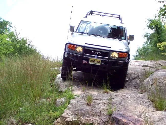

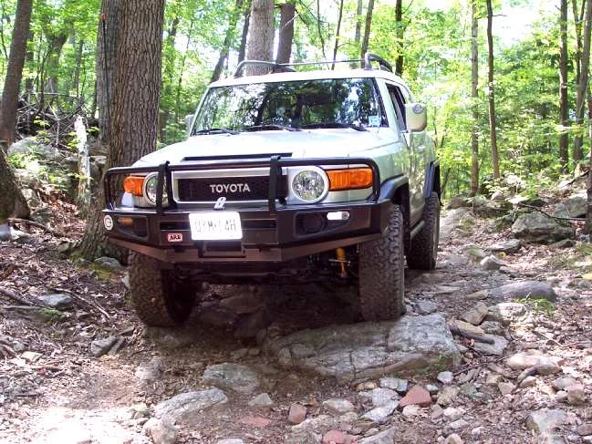

I have them and used the medium springs up front since I was not going to be running a winch. It rides great and a tad stiffer, has not settled lower after breaking in, holds the curves better. Great Offroad.

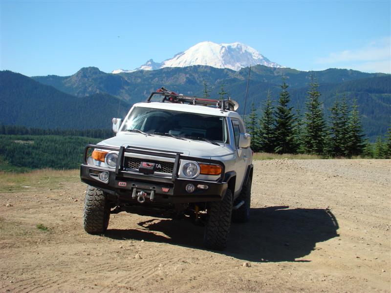

886 heavy duty up front for the bumper and Warn XD9000 winch
895 medium coils back after.
Cargobox, Powertank, ARB fridge/freezer in the back.
Rig rides good with this gear.
But...you should also look into aftermarket UCAs up front.
