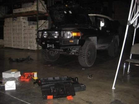

Here is my FJ with 35" MTZ's OME HD lift and ARB Bull Bar.
-Ben

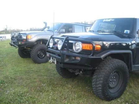

Here is my friend Eduardo with 315/70R17 and both heavy's...
