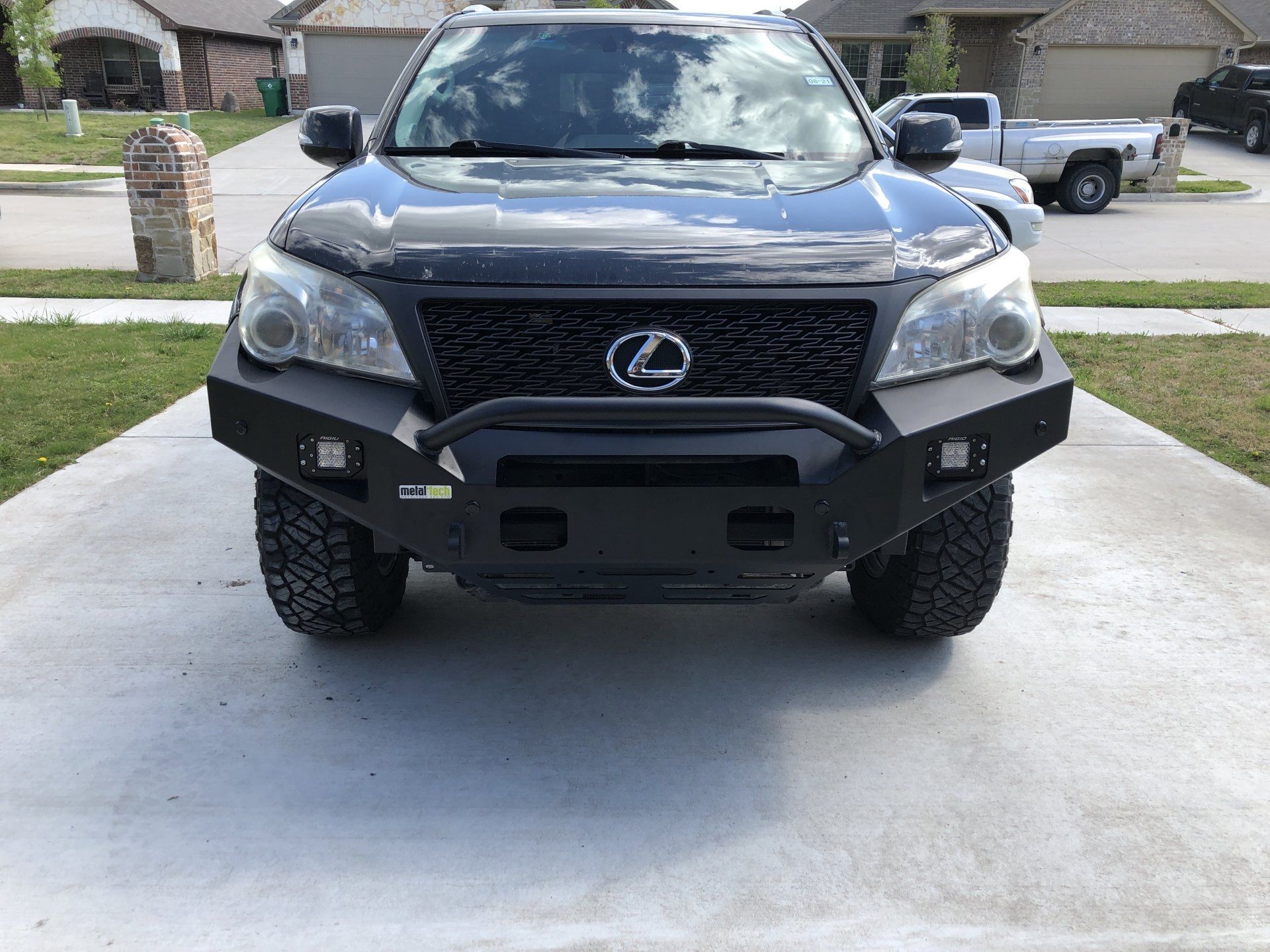

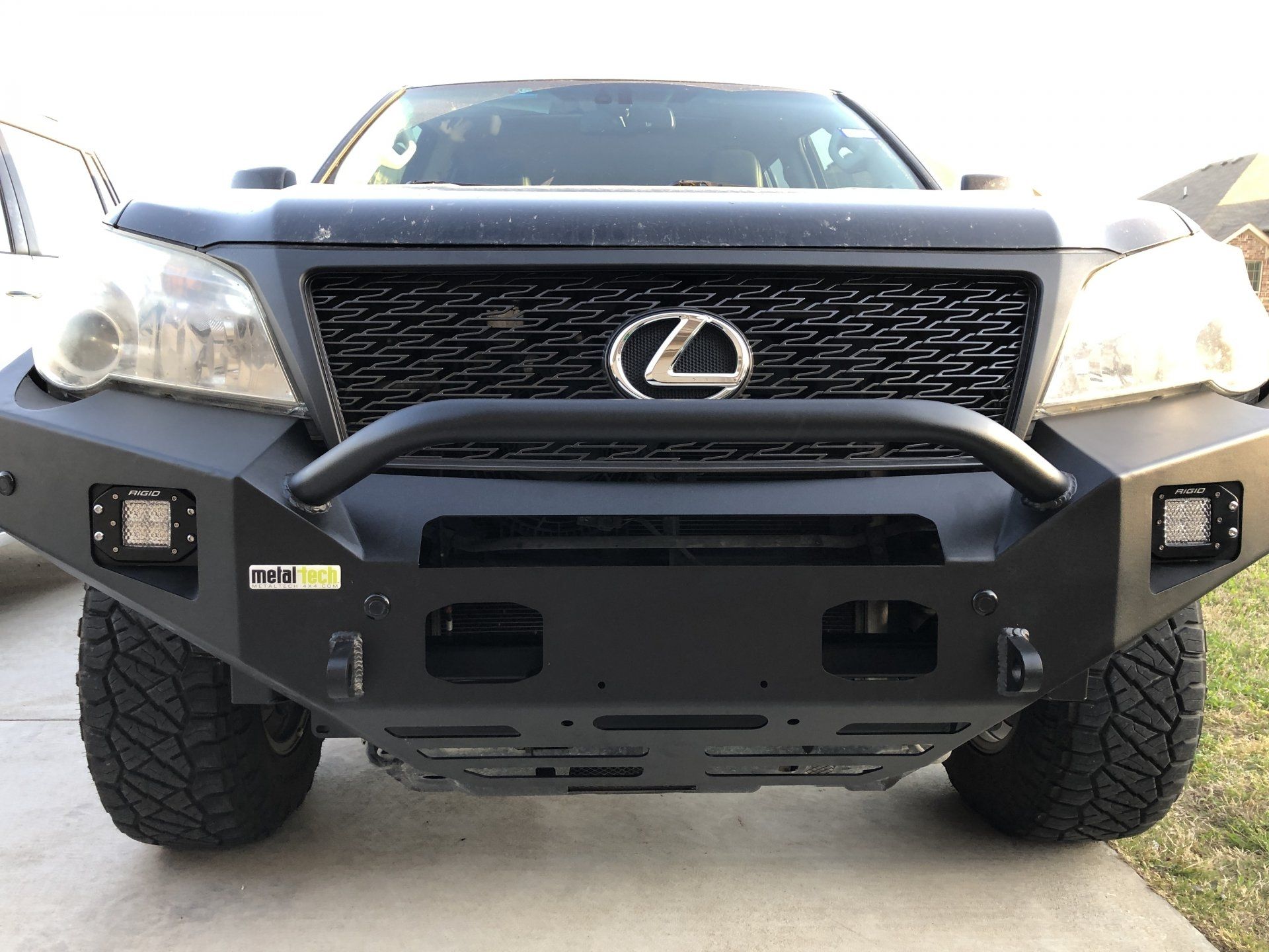

Does any one have a Metal Tech 4x4 bumper on there GX with Dynamic Cruise? I’m really worried about the grill guard being in front of the radar unit. Metal Tech assures me it won’t affect it but I have never seen one of their Bumpers on a unit with a radar equipped grill. Please let me know if you have a 2010-2013 GX with both. Thanks

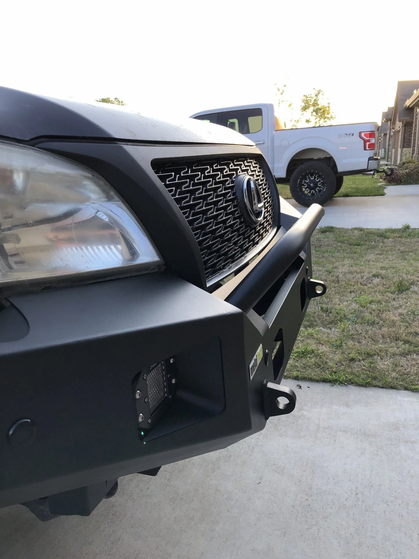

OP: If your sensor is being blocked by the bumper in anyway you will likely get error messages and system will deactivate. The radar/PCS sensor cannot be obstructed without a malfunction state. Which MT bumper are you looking at? IMO: That one with the bar that rises up toward the grille is sure to cause an error.

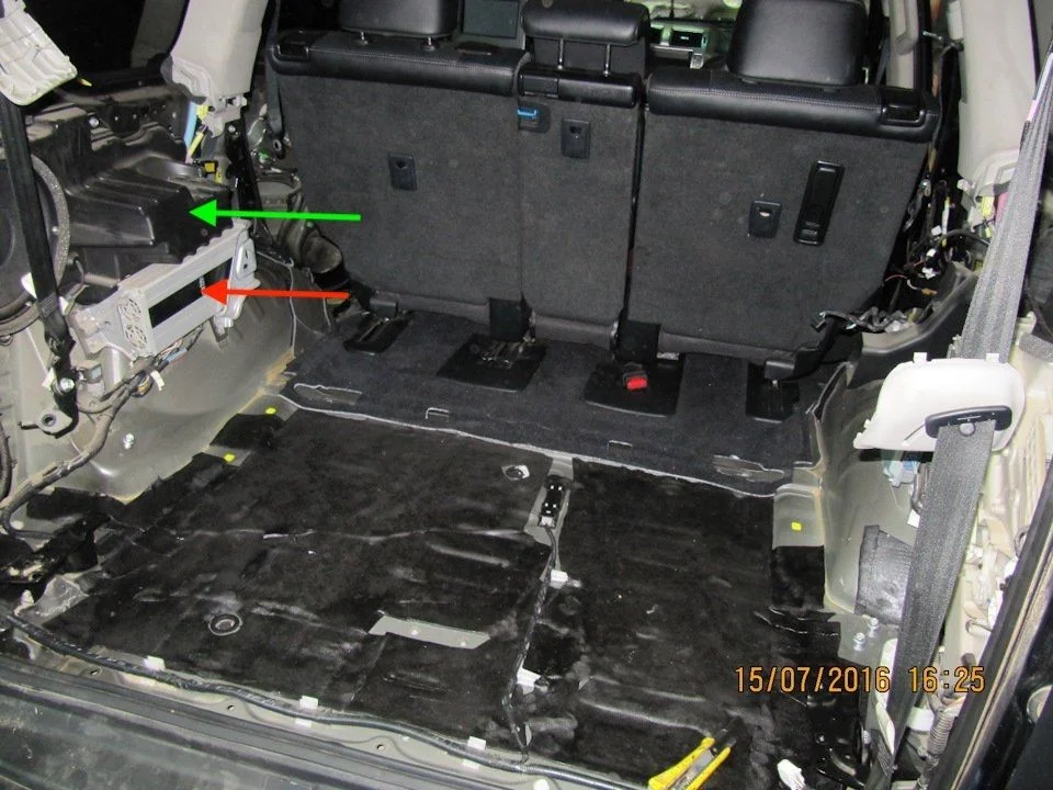

I’ll post a pic. Someone ordered this 13 premium with this feature and the lane departure. They deleted the ML sound and video equipment.
Interested to hear what they removed on the ML side.
Did they replace the ML amplifier and subwoofer in rear cargo area with something else?
I will have to check.

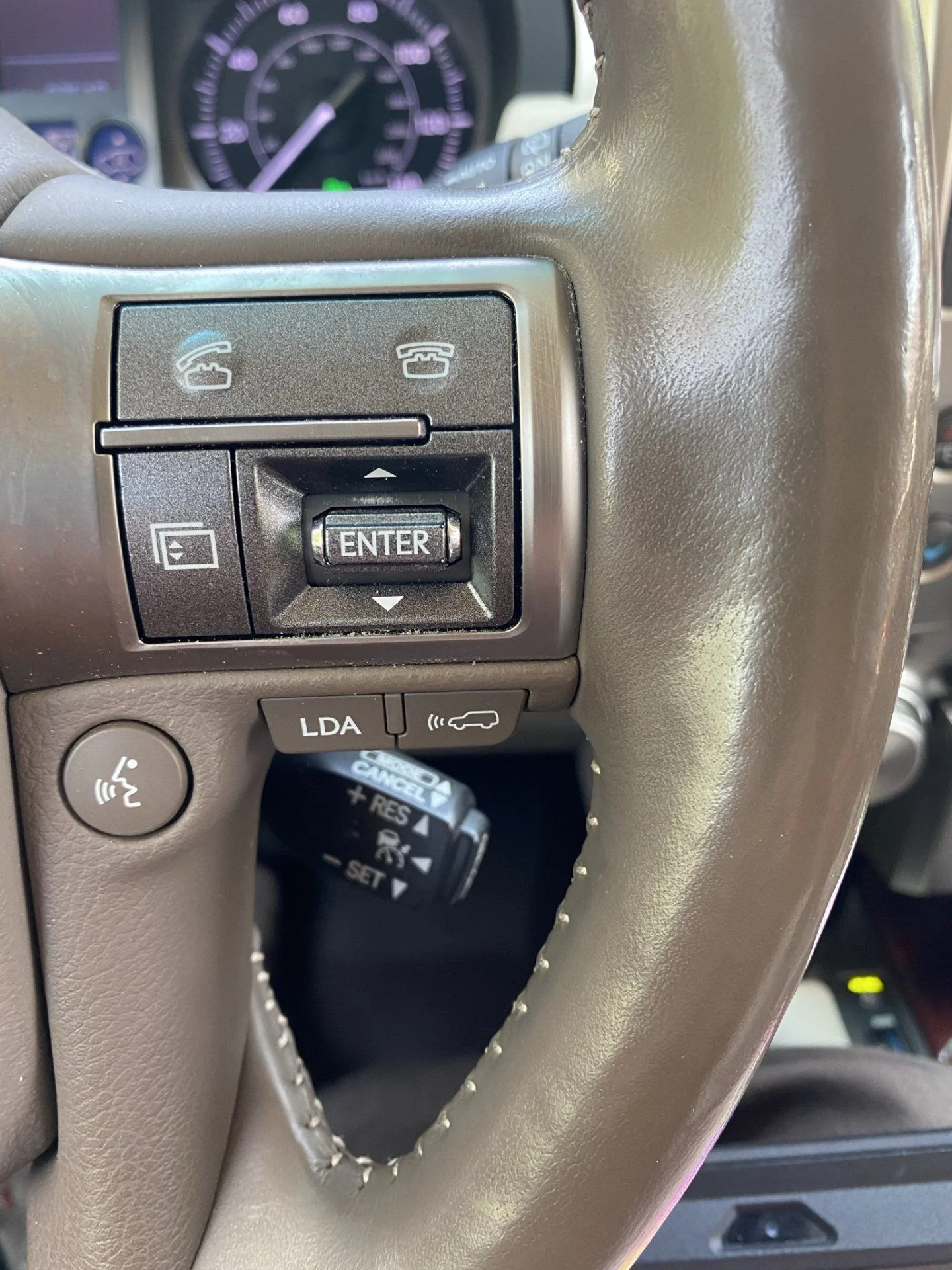

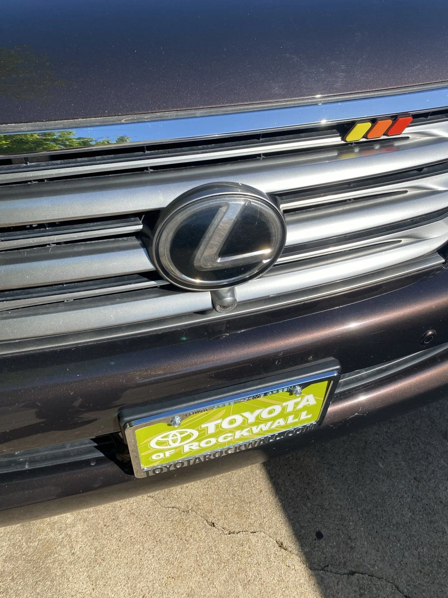

Here is a picture of my front grill and the steering wheel.
This type of cruise has its pros and cons of course.
The MetalTech Talon bumper will most certainly interfere with that. Just look at the position of that bar in relation to the L badge.
Considering all '20+ have this sensor now MT will need to further accommodate the need for compatible bumper versions for this tech. As hard as it can be to retrofit...often harder to defeat without lots of errors.

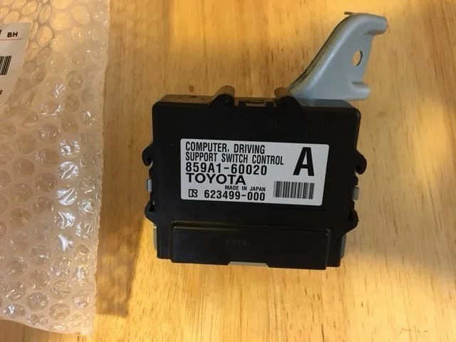

offroad47: You do have a fully load "US version" 460 but it still doesn't have MTS. If you decide to install MTS can I ask a favor?
If you can oblige... I just need some pictures... the camera system you have utilizes an ECU in the ultra right area of the dash call the Park Assist ECU. I have FSM but it seems it displaces an existing ECU and not real life physical pictures of ECU. Location below the right passenger vent. I picked up a "cheap used" of this "expensive" ECU.
Cheapest MTS for 10-13 is directly from Japan which can typically be cheap but COVID makes this one come by boat.
With shipping it will be around ~$150 give or take a few dollars.
10-13 uses - 859A1-60020

This video here shows the panel that would need to be removed to access location of the stock Mark Levinson Amplifier and subwoofer
Here is a picture of unit with trim off
Green subwoofer
Red Amplifier
