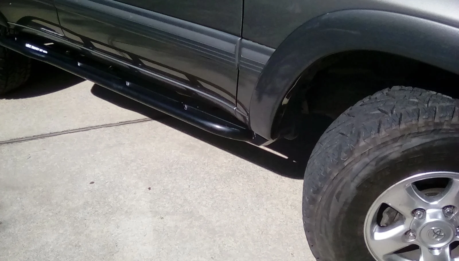

Painted them, and had a friend help me install them !

Thanks for the pics. The front mount on the passenger side won't work around the exhaust. We can build a set where everything is put together by us except for the front mount and you can have a local fab shop put the front leg together.
Will the front mount leg have a tab to bolt to on your outer edge or am i going to have to get something fabbed up and then powder coat the entire slider? I was hoping to have the set powder coated by you guys. There are no good local fab shops around me is the issue.. I live in yupster ville and folks look at my cruisers like they are all Jeeps...
