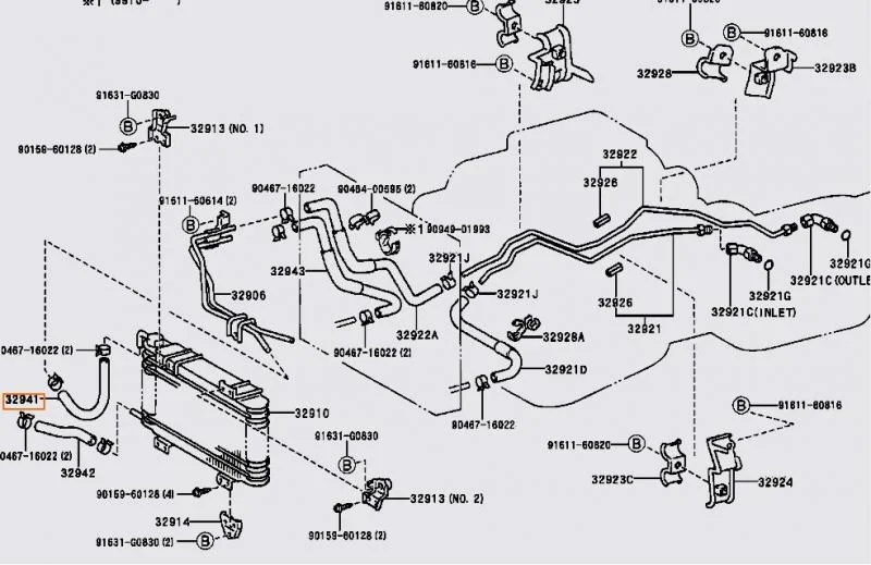

(Pic from above, thanks @Trunk Monkey

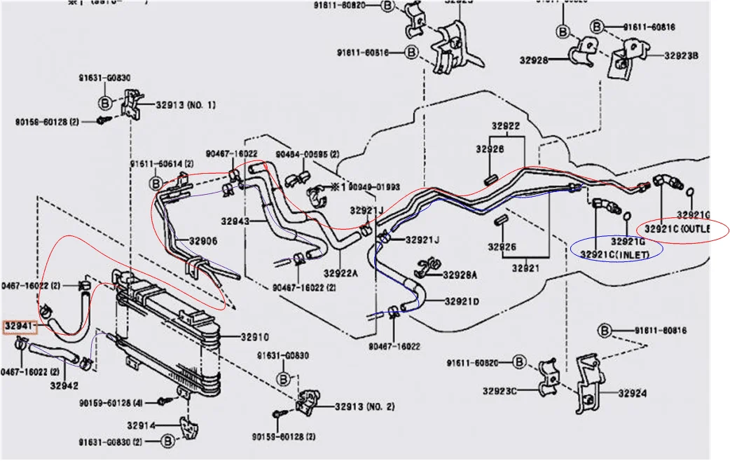

In this pic, ATF goes from the tranny (outlet) to the ATF cooler first, then into the bottom of the engine radiator and then across the bottom of the engine radiator (bathed in engine coolant) and out to the tranny. So the final stage of the ATF cooling/heating process, matches the temperature at the bottom of the radiator - presumably the coolest part of the cooling system at all times (at least once the thermostat opens).
So I think this means that the engine coolant thermostat is also indirectly modulating the ATF temperature too...
If the engine is cold, and the thermostat is (mostly) closed - the ATF is not really getting warmed by the engine directly.
My current thinking is that the ATF cooler "pre-cools" the ATF mostly* independently of the engine - so that the ATF is not heating the engine through a shared heat exchange. Once the ATF is cooled down sufficiently by its own cooler it then goes through the bottom of the radiator for a final cooling stage. At this point the ATF itself should be below the temp of the hottest part of the engine and coolant (at the top of the radiator).
I don't think we can say that the ATF is helping cool the engine, but it is also not heating the engine either? Also I don't think there is any concept of warming the transmission fluid with the engine when its cold because the thermostat is closed at this point too?
There is no benefit to bypassing the engine radiator and running ATF from its cooler directly to the transmission either...the engine thermostat will still govern engine temp to the same temperature.
* I say "mostly" because heat exchanged in the ATF cooler does raise the air temp crossing the engine radiator.
Hi Lost African. Found this thread that is great tutorial for me to get ready to exchange the tranny fluid in my 2002 LX470. From your last diagram, I found my tran oil cooler outlet hose (bottom of cooler radiator) is attached to the solid pipe shown in the diagram with a bend (32905) and the inlet or top of the cooler radiator hose is attached to the solid pipe that is straight. My thought is to drain the tranny pan, fill with fresh ATF, disconnect the bottom hose of the cooler radiator, start the engine and let the old fluid run out, then refill and repeat until tranny fluid is clean. Could mine be reversed where ATF from tranny goes into bottom of cooler radiator and out the top? What was your experience when you did yours? Thanks.
This thread on the tranny cooler line and how to fully change the tranny fluid was excellent. The only suggestion I would make is to disconnect the hose for the bottom of the tranny cooler. Disconnect on the car-side where it goes into the return line 32906. This way, you flush out the fluid inside the cooler as well. Thanks to all.
