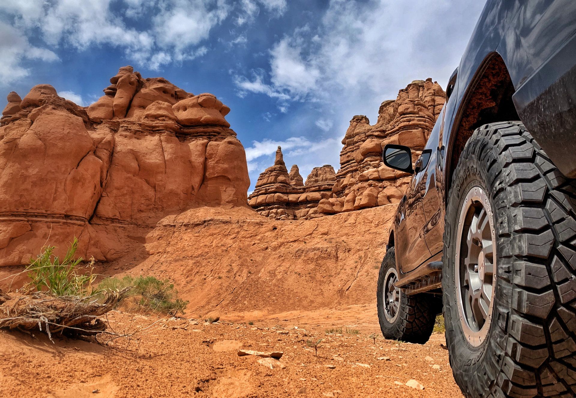

I popped Spidertrax back on at 1.25” —which makes up for the inch lost in outer stance by dropping to an inch narrower tirer—by moving outward a 1/2 inch via 1.25” vs .75”.
This sets my tread outward, but still stays within the inner edge of my wheel wells. The geometry seems to work well as it feels extremely stable in turns...feels planted under full articulation...tracks straight...and handles perfectly at speed in the desert including high-speed turns in soft riverbed sand...so I am very happy with it.
And frankly...the stance looks balanced again similar to my removed 35’s. I just don’t have the extra inch of tread on the inside any more and that’s a good thing.
This shot (below) let’s you see they are still within the wheel wells...

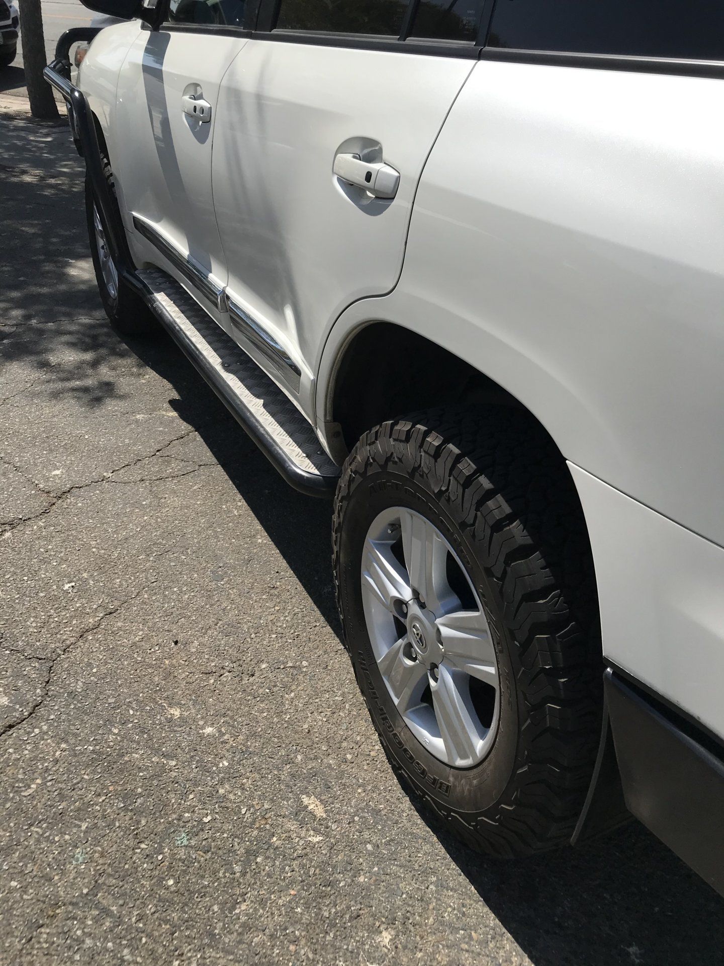

I popped Spidertrax back on at 1.25” —which makes up for the inch narrower tire by moving outward a 1/2 inch vs .75.
This sets my tread nicely—just within the inner edge of my wheel wells. The geometry seems to work well as it feels extremely stable both in turns...feels planted under full articulation...tracks straight...and handles perfectly at speed in the desert...so I am very happy with it.
And frankly...it looks balanced again.
This shot let’s you see they are still within the wheel wells...
Thanks. Running Spidertrax as well, currently with 33’s. Having in internal debate about going to 34’s with my next tires and was wondering how they’d fair......IF the 34 side of the debate wins. We shall see, thanks again, the truck (still) looks great 👍

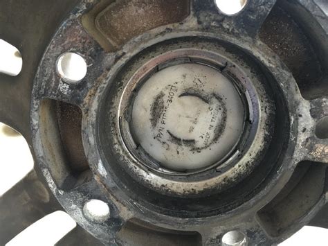

I remember with the Tundra wheels I run on my trailer there was an issue with the spacer studs hitting the wheel flange. I believe the Tundra has a solid cast face where your RW wheels have blockouts which provide space for the studs to extend?
