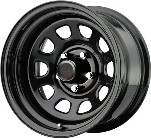

I'm going through a rather fruitless search trying to figure out the specs of these Pro Comp series 97 wheels this beautiful FZJ80 is running. Pro Comp site is rather lame as they don't list offsets for all their wheels.
The reason why I love these so much is the amount of lip it features. The offset has to easily be in the double digits. I'm guessing they're 16x8s given the bulge on a 315/75 tire. Ideally, I'll shoe on a set of Pro Comp series 51s as I prefer the D windows rather than the circles on the 97s. But if only the 97s are available with this amount of lip, I'm sold.
Here are the series 51s:
Thanks!

Thanks, Dan! Is there anything special you do to ensure that the lugs center the wheel correctly or do they just do what lug-centric wheels should do without fuss?
I personally think the D window 51s look better than any alloy wheel I've seen on the 80 series to date. And they happen to be super affordable. Win, win.

Just to close the loop, based on my novice investigative work, the truck in my original post is running 16x10s with at least a -38 offset. I don't think Pro Comp sells them anymore. Only 16x8s with the O windows with a much shallower lip.
The 51s are available still in 16x10 -38 deep dish look, but at the time of this writing, they're backordered ~1-2 months from all major resellers as deep dish 10" wheels aren't popular. Saddies.

Here are the 51s in 16x8 wrapped in Kumhos.
