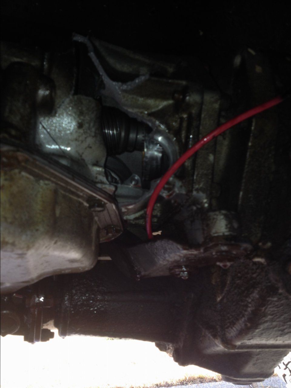

Figured you guys would like an update, I think I'm putting a little too much power for a turbo 350. Kinda blew it up today while driving gently, metal shrapnel everywhere, maybe time for a bigger tranny...Everyone loves pictures:meh:
no bracing on the transfer case? all the weight hanging off the back of the trans?... what is interesting is that is a 2 wd transmission with an adapter (not a very strong adapter, by the looks of it)....

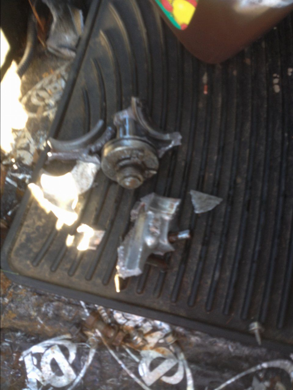

remember what I said about the shifter forks in the transfer case... this is what happens when it jams between hi and low. I bet your transmission, minus the adapter, is fine.... what you had was the transmission shaft spinning and the transfer case refusing to spin. Something had to give, and apparently the weakest link was that adapter - it allowed the transfer case to spin up.... pretty easy fix, IMO.... a couple laser cut adapter plates and an aluminum tube 7061 (not easy to weld, but very strong) or 6061

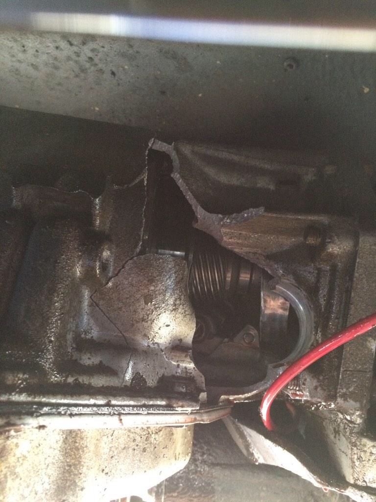

Thats not the adapter that blew up, sorry for crappy cell phone pics but along the pan is cracked and falling off, pretty sure the adapter is fine...Thats all out of the side of the tranny...
Also if this helps if you try to push it, you can roll it in park, reverse, neutral or drive and it makes a loud banging and jerks the cruiser. If I put the case in neutral between 4h and low it doesn't make any noise and rolls fine, thats what tells me the trannys done. Here's a slightly better picture my buddy got.
weird spot for it to blow.... that's all I know about that... normally the drum comes apart and then you have shiney, christmas-like tinsel all over the track... and bad words come from the track crew (not that I have any idea about this other than rumor... hehe)
Your latest photo indicates a crack from non-supported span rather than torque twist. When a crack originates at a bolt hole (bolt pattern) running fore and aft that crack is normally from torque twist (too much torque). When a crack wraps around the circumference (like yours) that crack is normally from a long non-supported span. The rear propeller motor mount was designed to eliminate (or stabilize) torque twist, but it does not help a long non-supported span. TH400's were normally considered a poor choice for Chevotas because they are very much over-kill (which is ok), because they are so long that you end up with very little rear drive shaft length, and a longer non-supported span..
It doesn't really wrap around, it's only on the side and there's cracks that run up the side of the tranny a little more. So would I need once I put a new tranny in it, a transmission cross member long with my transfer case cross member?
