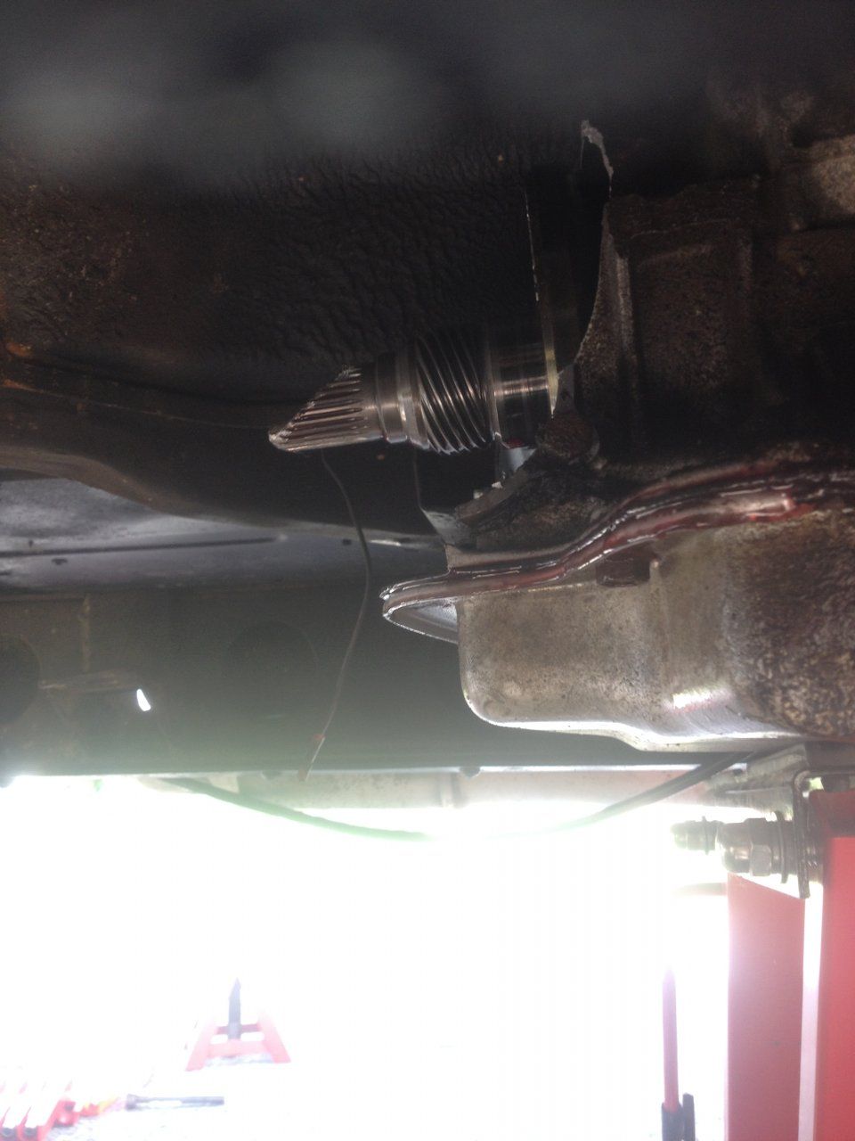

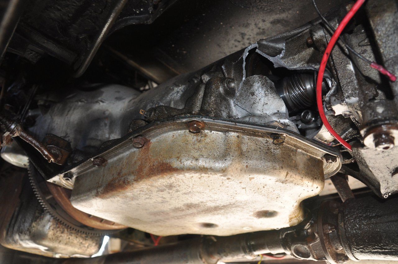

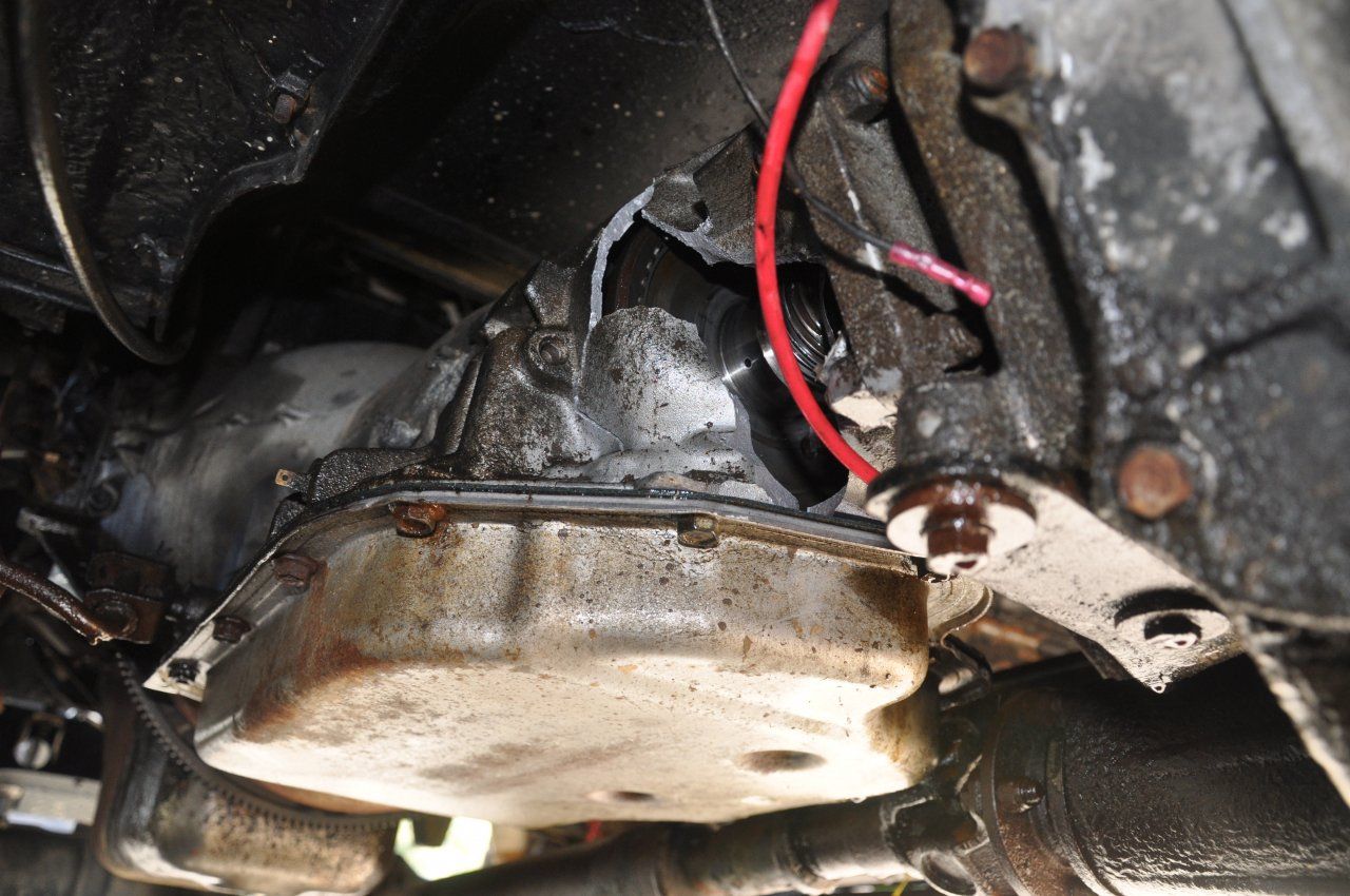

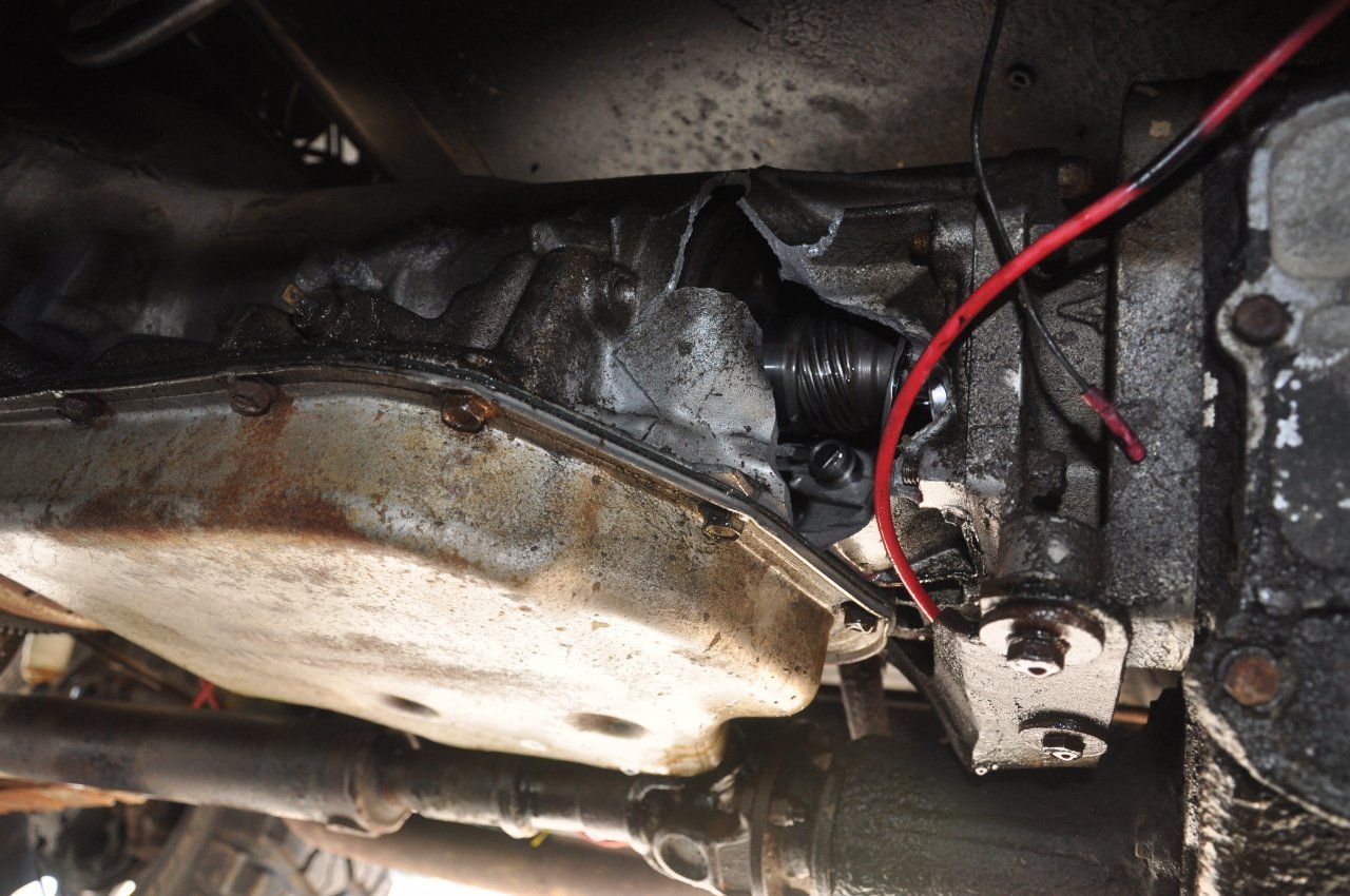

It doesn't really wrap around, it's only on the side and there's cracks that run up the side of the tranny a little more. So would I need once I put a new tranny in it, a transmission cross member long with my transfer case cross member?

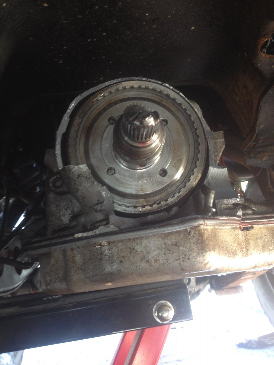

Got the good camera out for some actual decent pictures for you guys to look at....

My gut feeling is that you had a hairline crack in the tranny case to begin with, OR the adapter was not bolted tightly enough (or came loose) from the back of the tranny, giving the tranny a chance to start spinning free from the adapter????? Too many guys running your same set up that have never cracked a tranny like that. Look for black grease inside part of the cracked metal, where grease was laying inside a hairline crack before the dog gone thing gave way. That exactly happened to me, but all the way around the bellhousing- - - black grease inside the first 3" of a 9" crack.

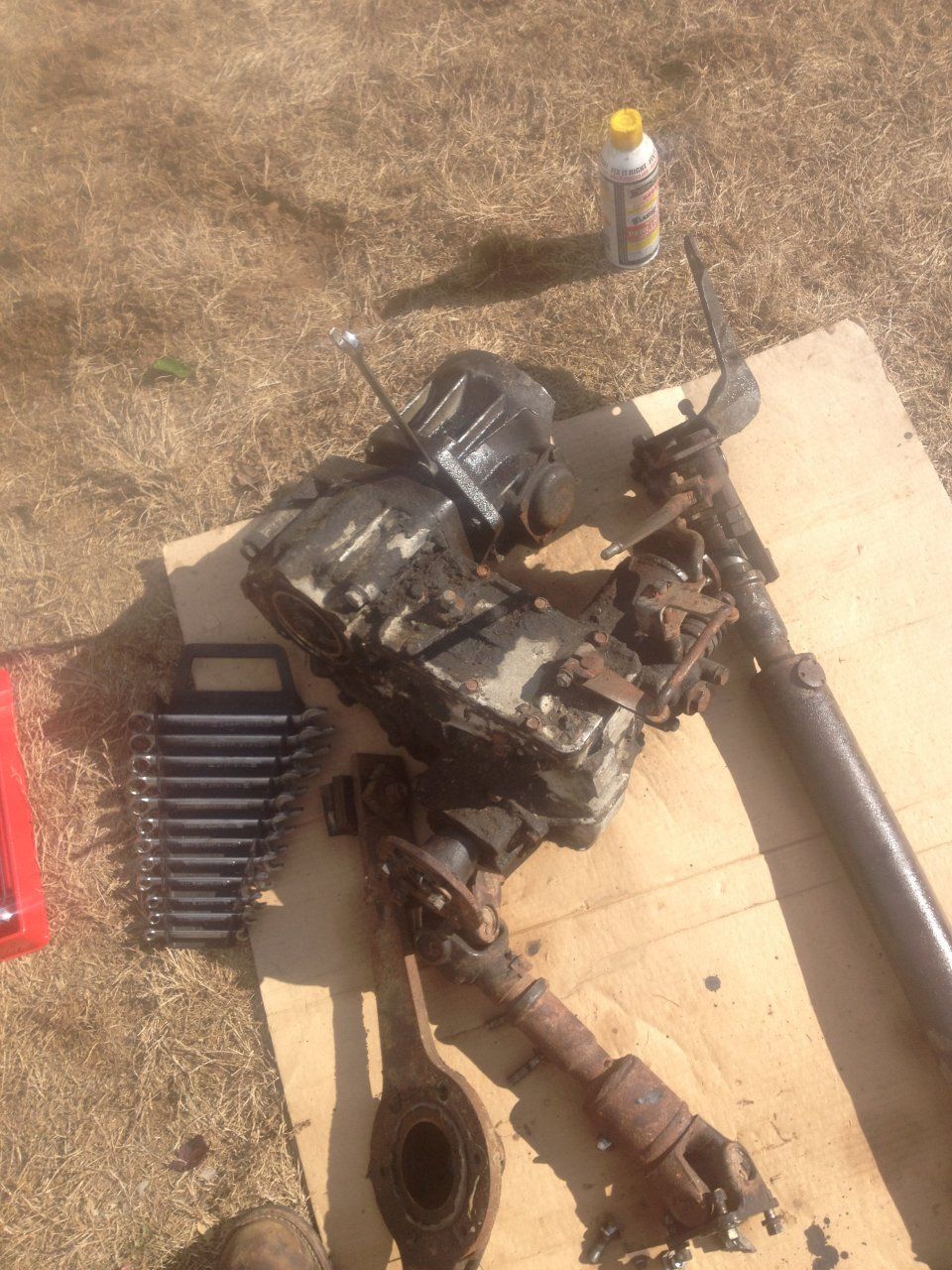

Well just a little update, pulled the case off...didn't even have to remove a single bolt...The tranny ended up being completely cracked and parts were falling off left and right. Also sheared the output shaft on the tranny. On a positive note the case shafts fine and works I guess.
