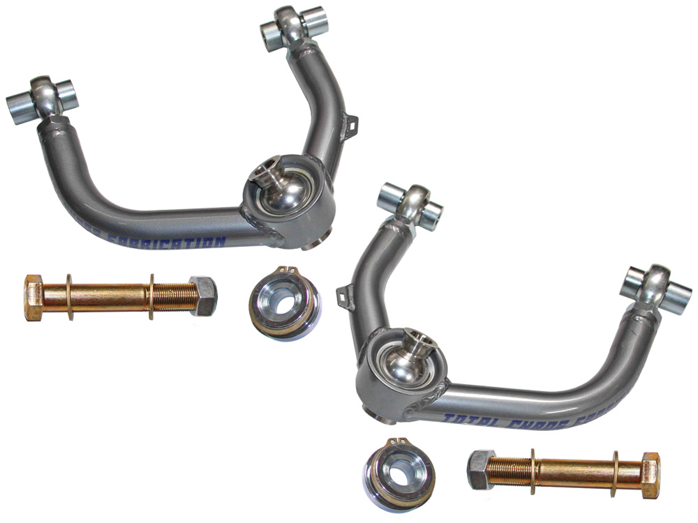

Total Chaos UCA install observations.
Last week I installed a set of TC UCA's. I already have a set I've been running for years on my Tacoma and the improvement to handling accuracy alone is worth the expense to me. My LC had both upper bj boots torn when I bought it and they were a tad loose after 195,000 mi so Urethane/Uniball arms were a no brainier for me.
BUT, One thing I notice about the basic design approach is bothering me a bit and that is how the wear of the urethane bushing face will be affected by the slotted mounting hole in the frame mount. TC's instructions say to dry install the bushings to the arms and then grease the ID and the steel insert with appropriate grease. This leads me to believe that the slip surfaces will be the bushing to insert interface and the bushing to frame mount interface. Basically the face of the bushing will be rotating against the slotted frame mount and I think that could be bad.
Another user, MXNDRINKS had a problem like this due to the angles or tension of the inboard mounting bolts which caused damage to the inboard bushings. Mxn, was this due to the tension in the mounts or the angularity?
Any pictures anywhere or post you could direct me to?
Now I'm wondering if this will happen regardless due to the design of the inboard urethane bushing and hardware.

I run the TC's too and had issues with alignment. There's more variables for the alignment tech with these compared to OEM. I have been out with multiple 100's on multi day trips that have aftermarket uppers and they all squeak in high dust areas. It actually starts to get pretty ridiculous. I use the recommended super lube and the bushings still sound like crap. I would love to see an alternative with real rubber bushings and either sealed uniballs or upper joints that are serviceable and have a better range of button than OEM. Multiple people I know would not recommend the current offerings after owning them themselves...I'm going keep them because they are paid for, but that's about the only reason why.
Regarding the noise, maybe things have changed since 2010, but according to Carl the trick is in the lube:
https://forum.ih8mud.com/showpost.php?p=5995535&postcount=31
Regarding the bushing being torn up by the slot, isn't there a spindle that takes the compressive force (after they seat that is)? Seems like the design is for the ends to be fixed and the pivot to be in the center of the joint. If they're noisy, they're probably not lubed and I could see this then making them want to pivot at the ends.

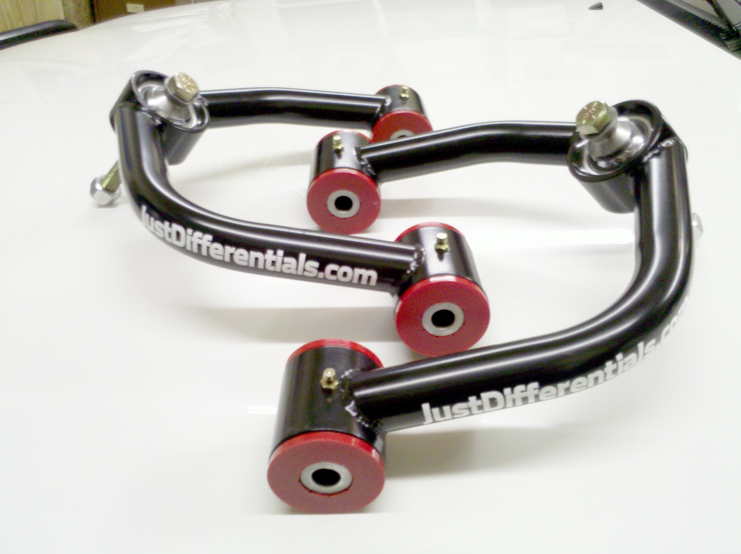

As far as TC vs JT, I'm having a hard time seeing the mounting difference between the brands, although the TC look like they have a nice angled zerk to make for easier lubing. Probably a $2 part that would be easy to retro into the JT.
JT
TC
There is no difference other than the Zirk...
Thanks, they do look the same.
